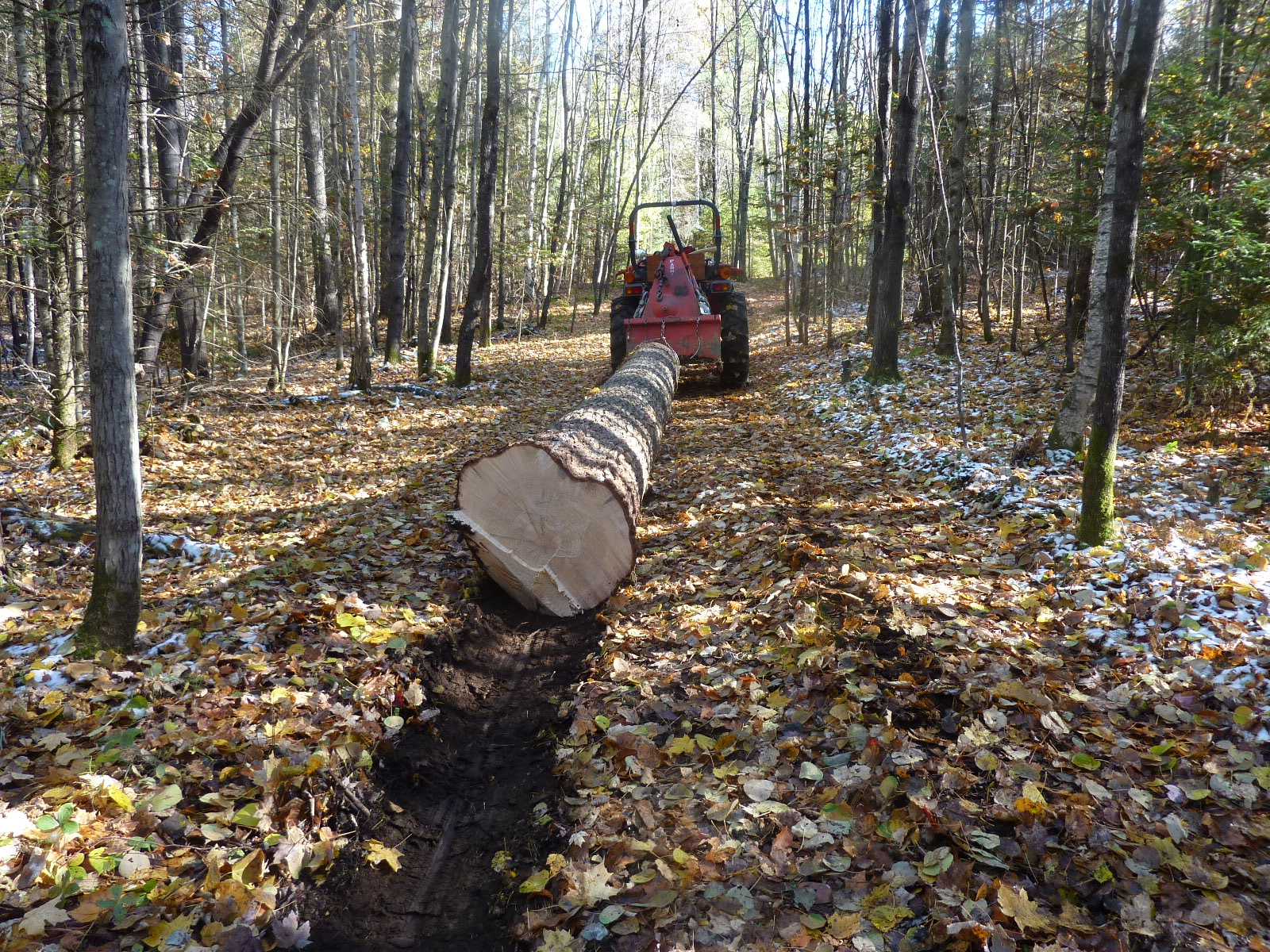

I used a 3/8 x 100' cable to pull down a few small trees that hung up in the adjoining trees yesterday. Working with a fixed length of cable worked in part because I had an open area to operate the tractor, but it would have been nice to be able to reel in or out as much cable as actually needed. The process of manually winding up the cable at the end of the day wasn't something I'd want to do often.

I also use a skidding cone to help prevent the end of the log which is being pulled from catching on rocks, stumps or base of other tress. Being heavy plastic the cone allows the log to over and around many objec objects.
