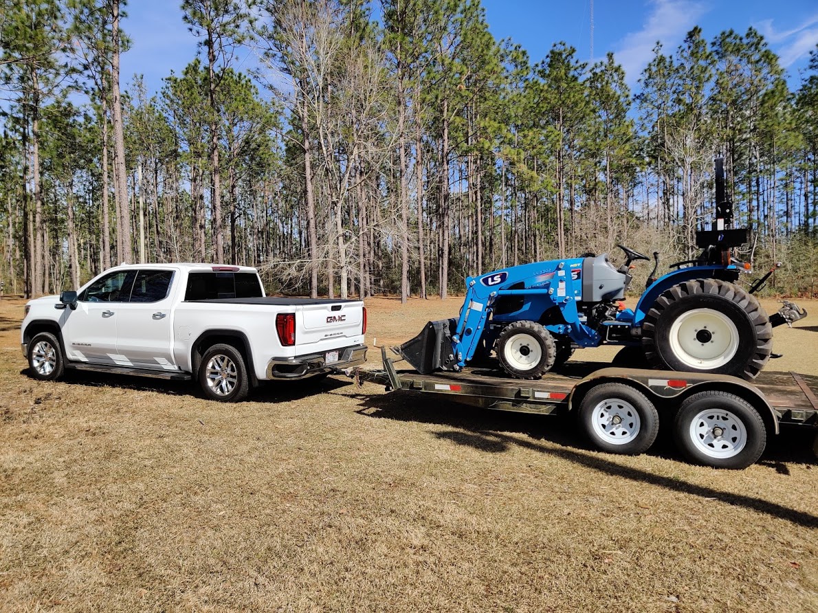

I have a 16' tandem dovetail trailer that at some point will be loading my LS240 on it for a short back road trip to the dealership to add a rear remote kit. I did a dry run the other day just to see how it fit, just drove on, not secured down. This tractor is longer than my last one, and ideally you'd think to center the rear wheels in the middle of the tandem wheels, but it does not fit well there, and it also seems to put a lot of weight on the tongue. The truck is rated for 960 pounds on the tongue. The tractor with loaded tires, loader, bucket, wet is approx 4500 pounds, I have no clue what the trailer itself weighs, but it's big and heavy. If I moved the tractor back a bit, so the rear wheels (tractor and trailer) were more aligned and less weight on the tongue, does anything jump out at you? I don't want to wind up in the "Share Pics of People Hauling or Towing Something Wrong" thread.
/ where to position tractor on trailer? #2
I think you can move back a little more. On most tractors, the center of gravity is roughly around the footwell area. Front loader will bias the CG forward even more, which means you can move back even more.
Proper tongue weight is in the range of 10-15% of the total. If you know the combined weight of the tractor and trailer, shoot for 10-15% of that on the tongue. A bathroom scale and a board (to make a lever that lowers load on the scale) can be used to measure the tongue weight. They also sell tongue weight scales. Can also take a trip to a truck scale if any are in your area.
That said, I usually do it by eye and feel for my trailer.

Your truck is not showing any hitch "squat", but you probably could move the tractor back up to a foot.

Way safer to have a bit to much weight up front then to much in the back :) The load as pictured looks doable to me. Probably have to be careful about more weight up front.

The steering wheel is about the center of gravity, put the steering wheel over the front axle center and you'll be just slightly front biased and should be all good. Done and dun.

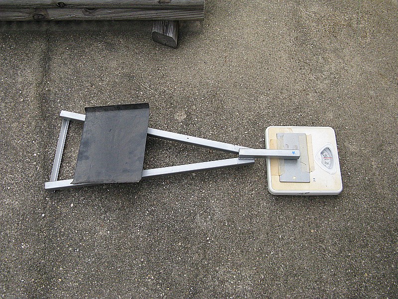

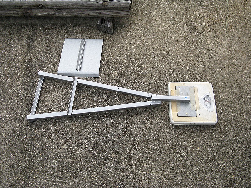

If you wanted to take the time and weigh tongue weight, you can with an ordinary bathroom scale.

Use the 60/40 rule. 60% of the weight in front of the centerline between the trailer axles. Quick way is to measure the height of the hitch as it sits with no load. If it’s at or higher than the no-load measurement, you’re too light which will spell disaster towing it. You also don’t want it too heavy at the tongue that would make the steering wheels loose traction. Just don’t exceed the tongue weight as stated in the owners manual.

I ordered a weight safe hitch last night and will use that for tongue weight etc. Looks like the trailer should be around 2500 pounds give or take. I'll use the steering wheel for initial positioning and fine tune it with the weight safe hitch.

The only way to know for sure is to weigh it.
I bought a set of frames and bathroom scales off of eBay years ago to corner weigh my cars with. Have also used them on my trailer both for weighting total weight and tongue weight. I had the measurements recorded at one point but I can't find them now so I will get them out and measure one day when it stops raining. It's basically a metal frame that allows you to use a bathroom scale and you just multiply the reading times 4 to get the actual weight. I used it once to measure the tongue weight on a trailer at work and it turned out within a few lbs of what it read on a set of certified scales.
The method that Bearsixty7 linked to above may work okay.
The actual measurements don't have to be in feet, just a ratio. The set I have are not 4 feet wide I know that.
/ where to position tractor on trailer? #19
You do not have to buy anything to use the bathroom scale method, if you have some pieces of scrap lumber.
Don't even need to fasten anything together.
Just stack up some blocks, and span distance with a piece of 2x4.
Diagrammed method is shown on E-Trailer website.
