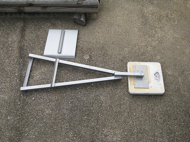

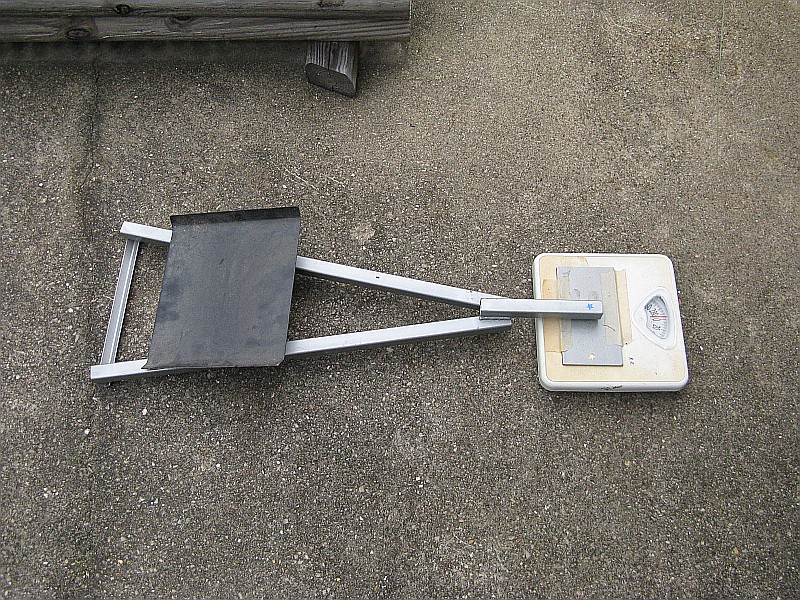

If you wanted to take the time and weigh tongue weight, you can with an ordinary bathroom scale.

The only way to know for sure is to weigh it.
I bought a set of frames and bathroom scales off of eBay years ago to corner weigh my cars with. Have also used them on my trailer both for weighting total weight and tongue weight. I had the measurements recorded at one point but I can't find them now so I will get them out and measure one day when it stops raining. It's basically a metal frame that allows you to use a bathroom scale and you just multiply the reading times 4 to get the actual weight. I used it once to measure the tongue weight on a trailer at work and it turned out within a few lbs of what it read on a set of certified scales.
The method that Bearsixty7 linked to above may work okay.
The actual measurements don't have to be in feet, just a ratio. The set I have are not 4 feet wide I know that.
You do not have to buy anything to use the bathroom scale method, if you have some pieces of scrap lumber.
Don't even need to fasten anything together.
Just stack up some blocks, and span distance with a piece of 2x4.
Diagrammed method is shown on E-Trailer website.
