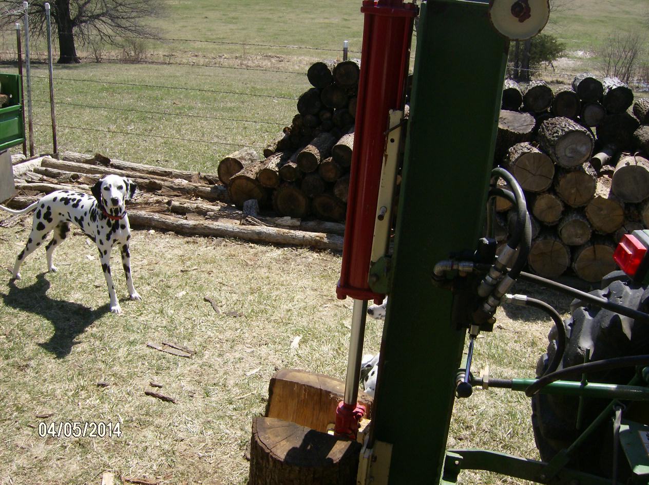

If you have a county bridge department, you might check with them. I was able to get a 5' used H beam that way when I built mine: HPIM3027.JPG
