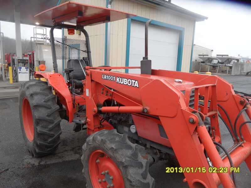

And another thing is timing of purchase.
IF the OP can buy used (and maintain it) autumn usually shows lower tractor prices.
Coincidentally
dont want to spend more than $15,000
was one of the criteria SWMBO and I put down before I bought:
attachment.php
for ~$12K. Which left $3K for attachments :)
