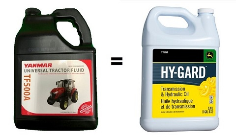

Eric,
Generally we flush the hydraulics with diesel. I filled mine about 80% or just over 2/3rds full. Drive the machine around for about 10mins and then drained.
Hydraulic Fluid Change
If you can drain 1-quart of engine oil and then add 1-quart of diesel, then start the tractor from a cold engine, let it run at 1,500rpms for 10 to 15 mins. This is basically a Gunk Motor Flush, but using diesel. Should you do this technique, be sure to also change the oil filter.
Hydraulic fluid is any fluid meeting the J20C specification, not being 'compatible' to the specification. At present there are a few class action lawsuits over the 'compatible' which is a marketing ploy and has no merits to mean equal nor better.
If you can find Yanmar TF500A, you found John Deere J20C in a Yanmar bottle.

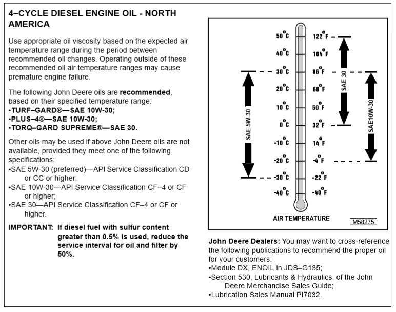

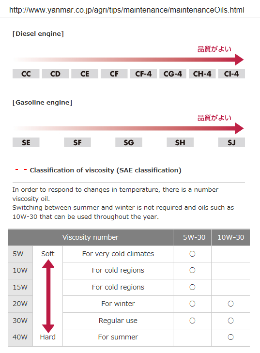

Engine oil for the Yanmar 2T, 3T and 4T engines per the Yanmar website.
John Deere for the 50 Series of Yanmar made machines.
