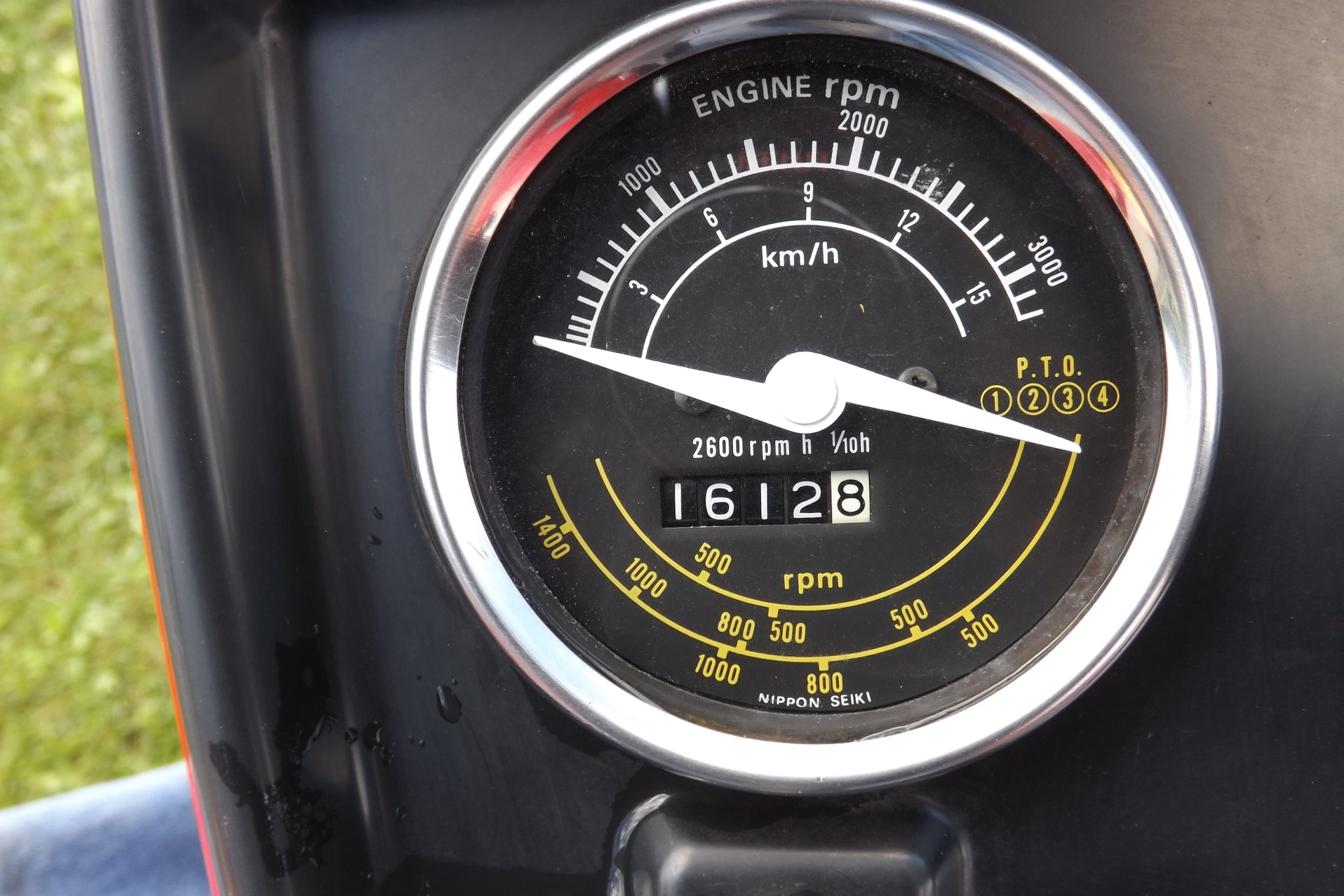

Per the Yanmar parts manual, there is a section giving the tractor stats on things before the full figure break down. In there, it says the performance of the engine for my machine is 2600rpms. The tach at the time would reach about 2750rpms when I pulled on the throttle to max.
hen, I noticed the throttle linkage before the fuel pump has a threaded end and a nut. I did exactly what you mentioned. I turned the nut. Got to 2800rpms. Tuned the nut. Got to 3000rpms and left it.
My tach goes to 3200, so at 3000, the speed is 15kph in the highest powershift setting.
Eric, is this what you are aiming for?

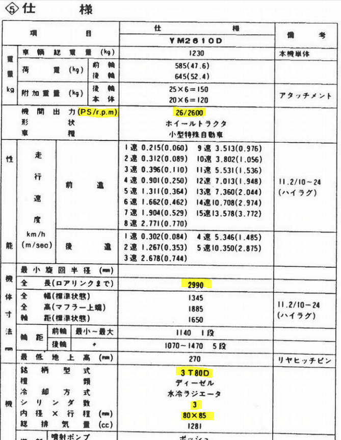

The manual shows, the gov should kick-in at 2990rpms. :) One reason why I only tweaked it to 3,000rpms for the tach.
The power curve shows PS 26Hp @ 2600 rpms. It's nearly a 1.3L diesel.

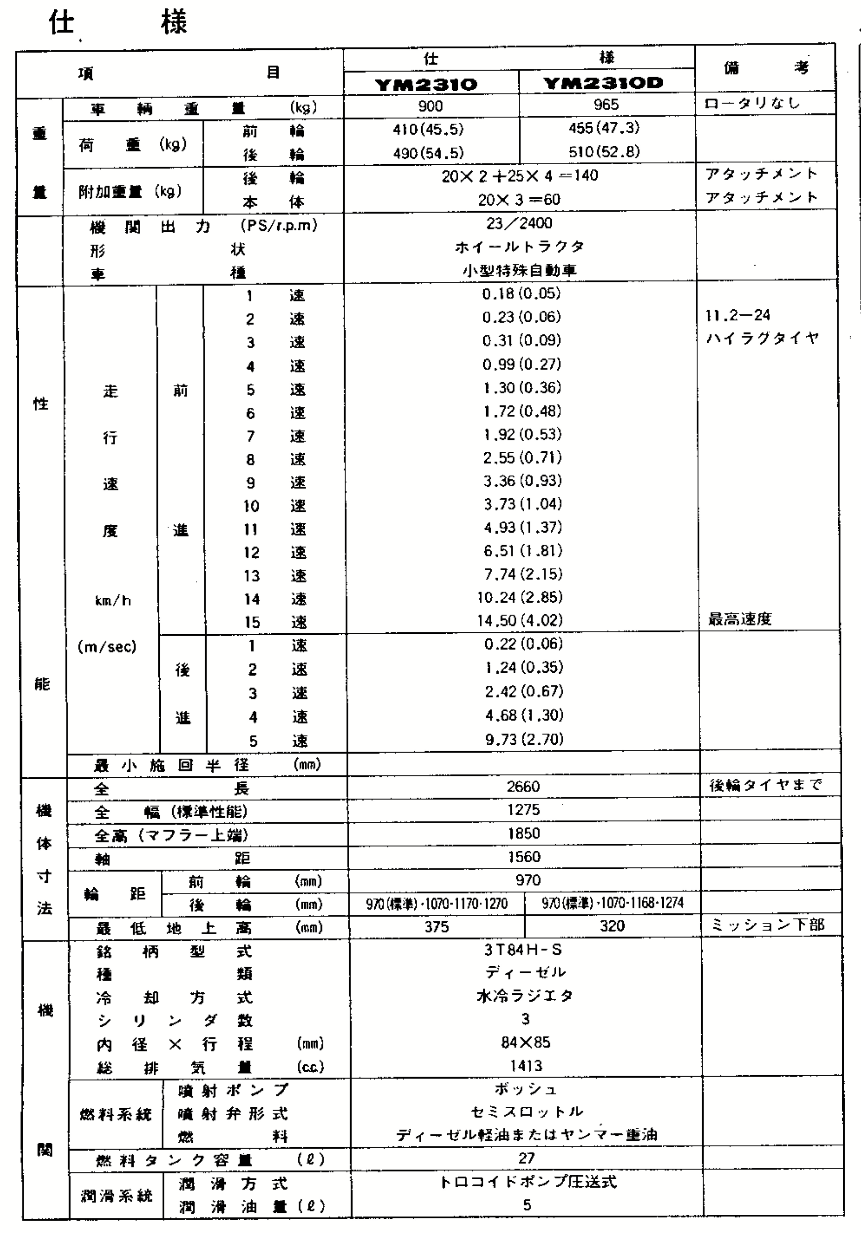

Eric,
Your YM2310 specs.
