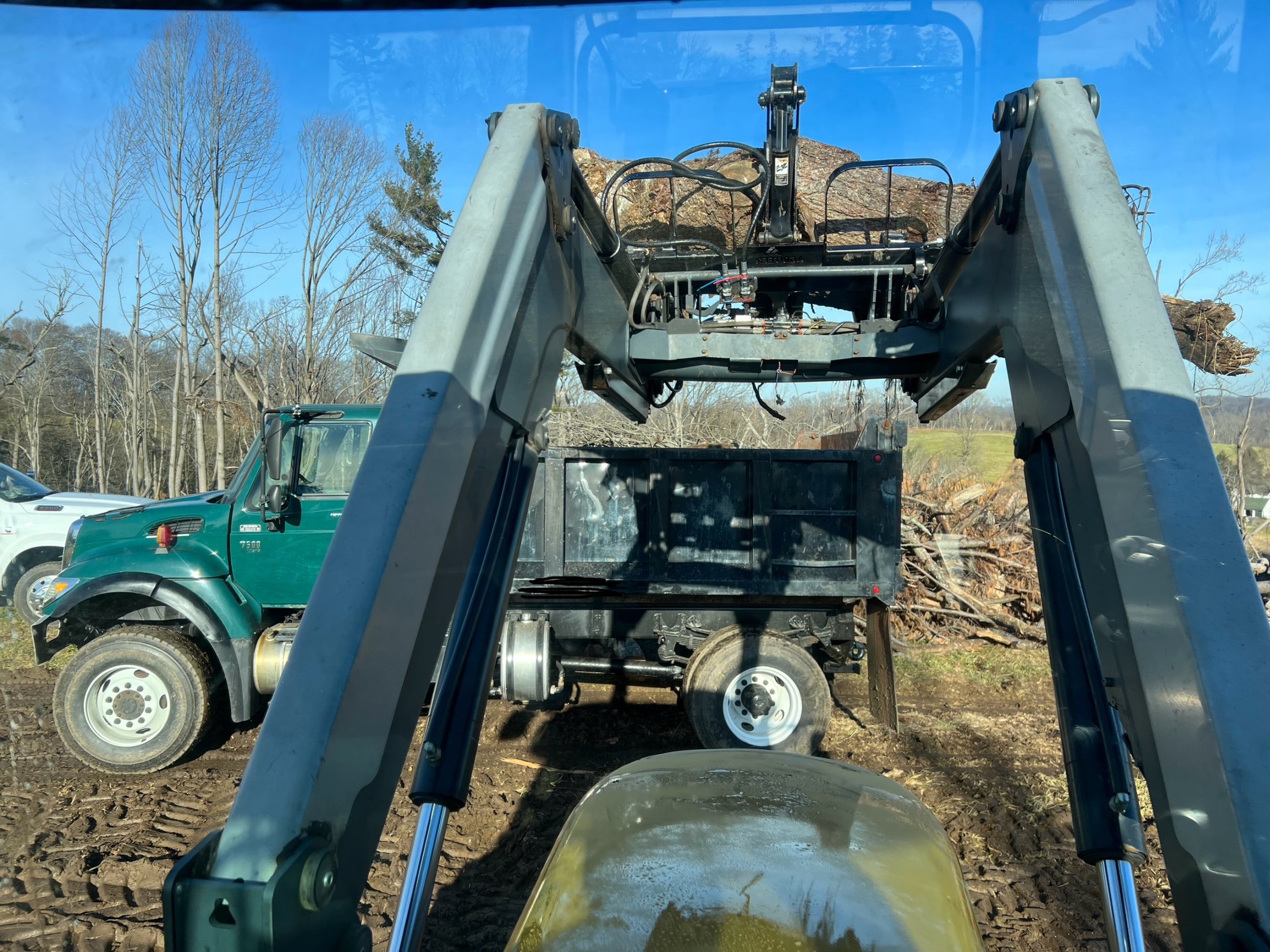

Probably not beyond repairing the hydraulic lines that broke. I've never felt comfortable with that SS attach. I can see how that can easily happen. You would never see the global attach do that.

Even completely unlatched, that grapple wouldn't have come off with the Euro/Global quick attach. So much safer, simple, reliable and easy to use. Makes no sense why the SSQA is still used in 2024.

Bounce or no bounce that attachment shouldn't have come off unless it wasn't latched down right or fitting to loose.
I've never had that happen on either of my M's and both have SSQA's one is a Kubota built (I presume a Great Plains and the other is an ATI). I like the ATI better, it's way more robust in build. In the past through me getting in a hurry, I failed to latch the pins into the SSQA plate slots and picked up a round and went to load it on my customers semi trailer and had the bale and the forks come off, but never had the hose rupture like that. That had to be a faulty hose.

I have what I have and the only 'Global' I use is Global Supply online. Not about to buy new ones and candidly, mine work fine so long as I remember to latch them into the windows cut out in the SSQA plates, One thing I do do is, I increased the tension on the clamp arms a bit, both mine are adjustable for latching and release tension and I keep them greased as both have grease fittings on the pins and the arms.

The hose got torn off when the attachment came off

Maybe it was improperly connected

He should have had the load rolled that far down. Even if the attachment didn’t fail the the grapple is a lot more likely to loose it’s grip like that. If he was lifting with the hitch plate near vertical it wouldn’t have fallen off. I’m guessing the grapple hitch pins were wallowed out and not fitting properly prior to it falling off.
