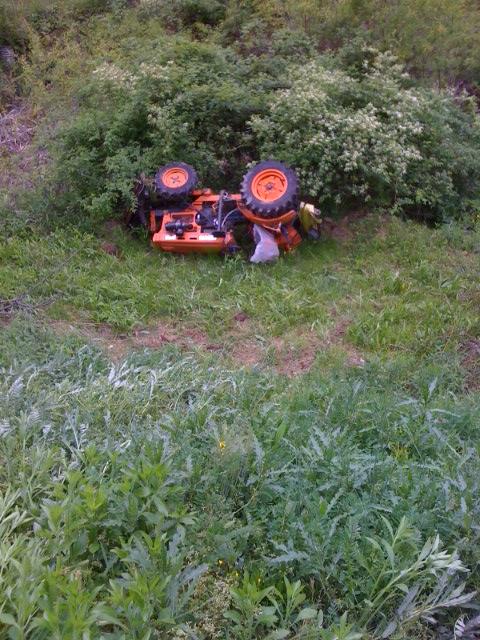

Got too close to the edge today..always knew it would happen. Does anyone know what I should do before I attempt to start it again?

Check all fluids is the only thing which comes to mind right off the bat.
I'm assuming that you weren't hurt at all. Well, except maybe your pride.:eek:
/ when I get this thing turned upright #3
#1 Get it upright #2 Pull the glow plugs, if you have them; if not pull the injectors and spin the engine over several times to clear any fuel/lube oil from the intake stream and cylinders.#3 Check the oil for adequate level, put all the stuff you removed back and fire 'er up

Glad you survived:thumbsup: This something I personally haven't had to deal with, but probably make sure no oil or other fluids got in the cylinders, don't want to bend rods:mad: make sure radiator is ok and check the battery for loss also. Good luck with it.

Glade to hear you're OK:thumbsup: I must ask though! it looks like more than one roll over to have wound up down there:cool: if so? you might want to be looking at some other issue's Like bent lift arms, bent steering wheel,,the exhaust pipe, etc,etc, what Implement did you have on the tractor?
