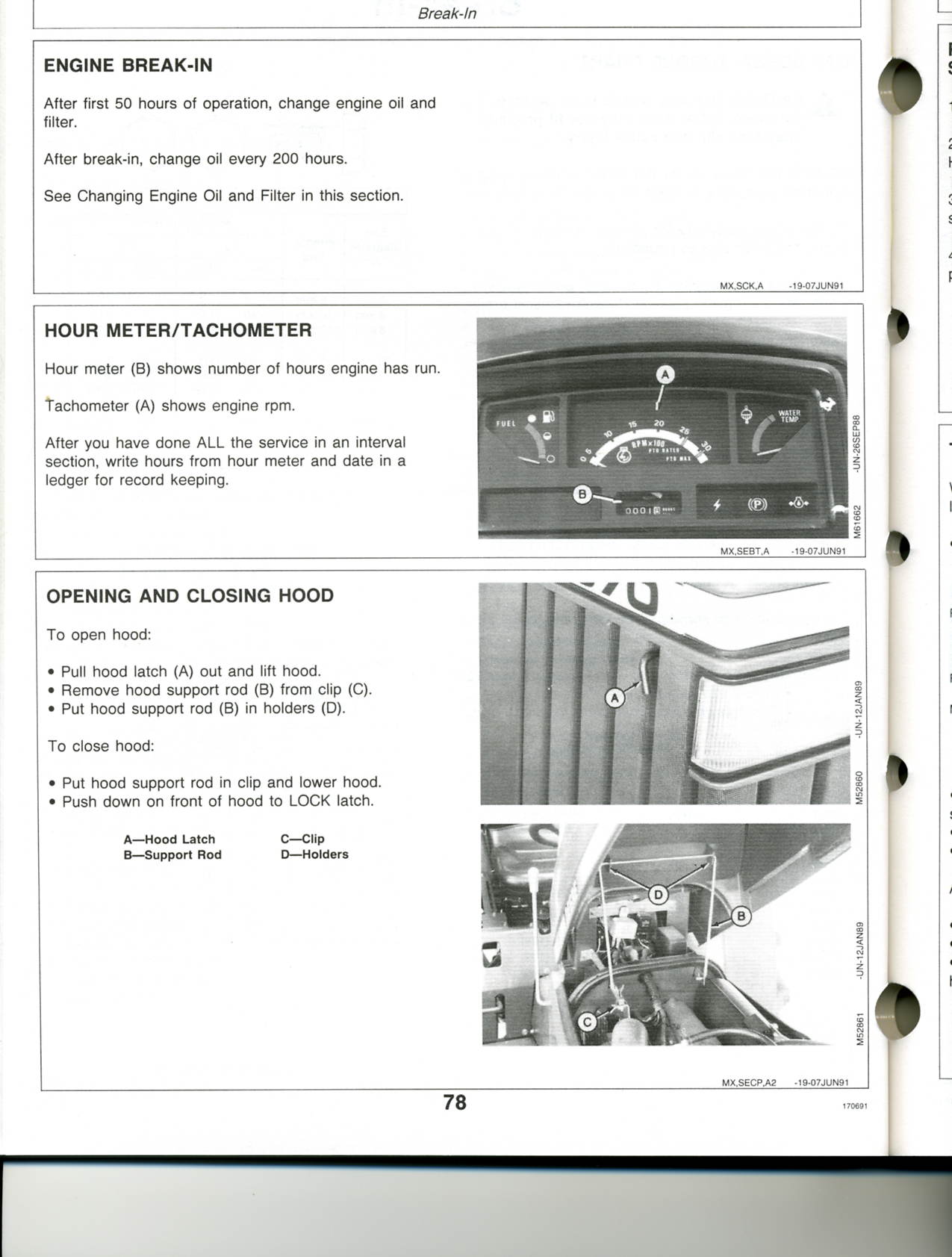

My 1070 is not a Chevy Volt .. but there appears to be a block heater plug hanging out the bottom of the front hood.. (I cannot see inside because the manual has not come for the tractor (Ebay purchase) .. and I cannot figger how to open the @#*! hood?!)

/ When do you plug in? #4
The hood release is on the right front corner (when facing forward) of the hood at the top of the radiator grill. There is a 2" lever there. Pull it straight out as you face the left side of the tractor. The hood will snap up a few inches. Raise it up by hand and set the hood prop rod, which is in the rear of the engine compartment. Look for the oil dipstick (check it), look for the fuel filter on the lower right rear side of the motor, check the battery water levels, and the radiator screen. The air filter can also be checked for excess dust and crud at this time. Battery cables don't last very long on this model in my experience. You might also want to check the fan belt condition and tension at this time. There is another fuel filter in the back of the 1070 on the right side at the bottom of the tank. Lastly, check the hydraulic fluid level at the dipstick at the rear center of the machine, by the upper 3 point link base.
I suppose you should check tire pressures, too. After greasing the steering, pedals and rear 3 pt linkages, you can check the radiator fluid. Then you will be ready for winter.
/ When do you plug in? #5
1070 hood opening from manual.

Z-6/J-5 ... I saw that rod sticking out the side, but when I pulled it - it just pulled?! Maybe I need to pull it that tick farther to activate the hood release...
That's it. I was rotating it to not avail.. then simply did not pull it out far enough. That nasty (now nasty) sound deadener will be the first thing to go - 'is all dust. Cute little engine, eh?! I printed out your instructions Z-6.
... and that "block heater" would have done about 1/2 our city block; it's very warm in the engine compartment. Looks like it needs a thermostat/timer. (35f. out with winds into the 20's..)
