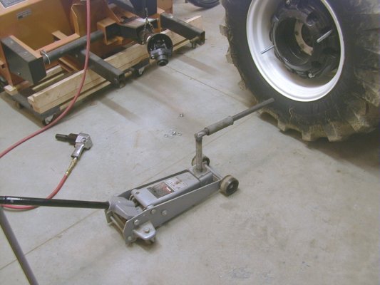

Wheel weight lifters from my projects file.
I have a heavy floor jack about that same size, think yours will lift a 250 lb. wheel weight off center without tipping over?
Don't know how heavy his wheel weight is, just a picture that I saved.

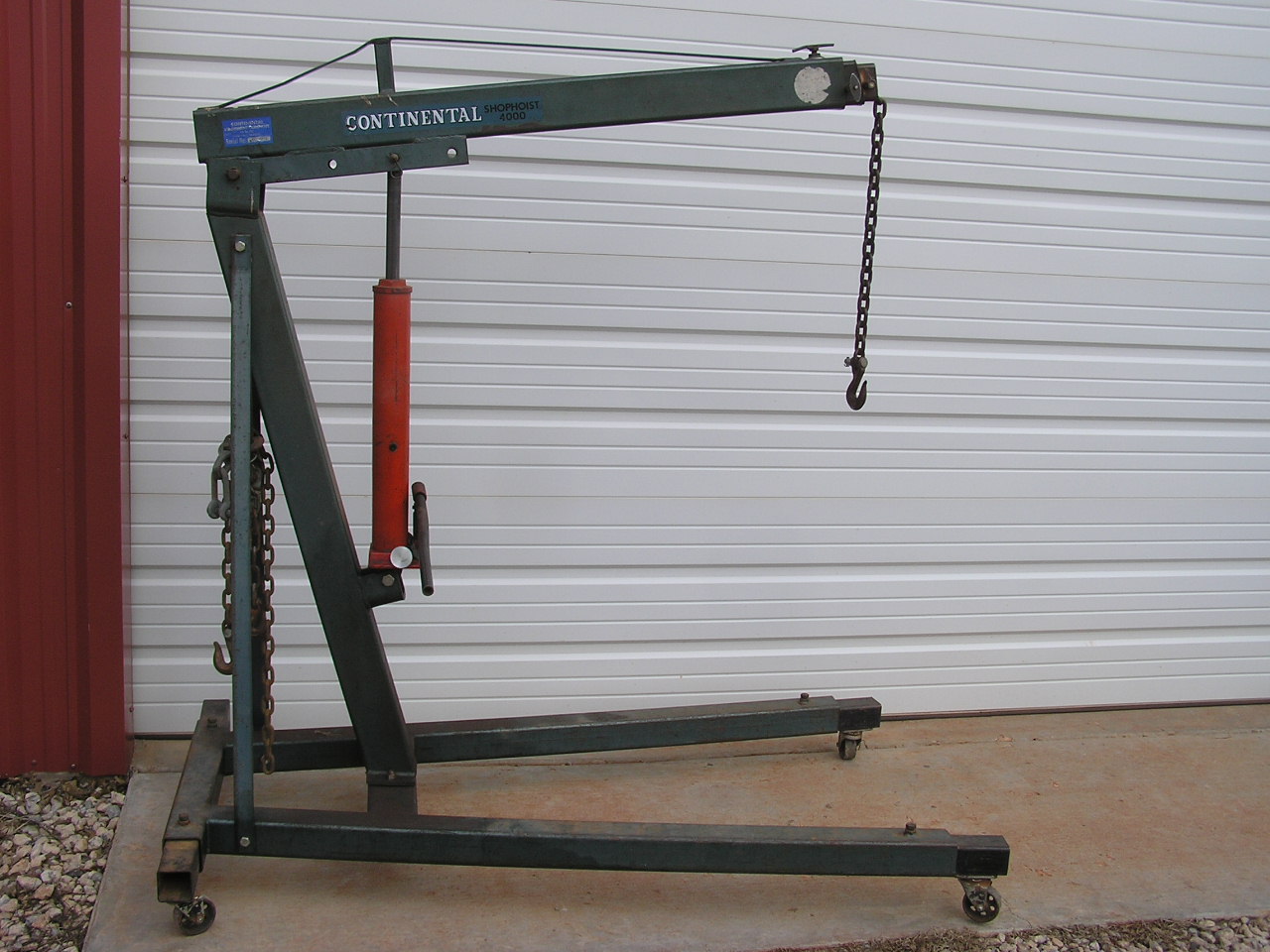

I would use my shop crane if I needed to do it.
This works and is what I do. Weights go on easy. I've also removed a heavy dually pick up bed with one and no problem. It used to take six guys to lift or replace. Shop crane is easier.
/ Wheel weights #47
Also used it with a rope to put a spare tire back up on a gooseneck horse trailer.
