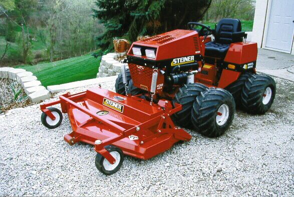

Because there was concern about slippery conditions and turf damage . . . I would have thought turf tires where more rubber grip contact with lawn would have reduced ripping turf . . and would greatly improved traction . . Especially on side hills. The aggressive nature of ag tires is welcome for dirt but "too cutting" in sidehills with grass.
The other thing . . is the idea that pulling a trailer or 3pt hitch mower or brush hog doesn't alter sidehill issues greatly. A pull behind item wants to create its own path or direction when on sidehills or hills. While center of gravity is "the thing" on sidehills on a lone tractor . . When a fel or rear pull-behind item gets involved . . then CG is only part the solution.

Greetings Vtsnow, turf issues might not be your concern, but they were for number9's point of view as he stated . . plus if you are ripping turf you are losing the traction stability beneath you. And certainly traction is all of our concerns and tire profile of an ag tire vs turf tire on a sidehill advantages the turf tire for roll over concerns (side hill).
But for all the science type of center of gravity ( COG) physics . . . I had mentioned when a unit adds either front torsion leverage or rear torsion deflection . . COG is also only part of the story. Often times in our battles to defeat gravity on tractors or motorcycles or atv or bicycles for that matter . . forward momentum (or inertia) helps keep people upright . . . And the loss of that inertia or a forced slowdown of that inertia hurts your "staying upright". A fel on a sidehill or a brush hog behind on a sidehill causes drag on inertia and torsion twist because of gravity. Those implements are at the influence of gravity . . and they are being "pulled down" while we are trying to go sideways on hills.
A mid mount mower or a "direct side" batwing can aid in keeping you upright on a sidehill . . but a fel or trailer/3 pt attachment is never your sidehill friend in the effort at staying upright. You might stay upright in spite of them . . but not because of them.
Those who say COG is the only thing that keeps you upright have apparently never seen a motorcycle race or driven a motorcycle where COG is regularly and continually defeated by "a controlled" momentum or forward inertia . . and the rider continues upright while their COG is far outside their wheels.
