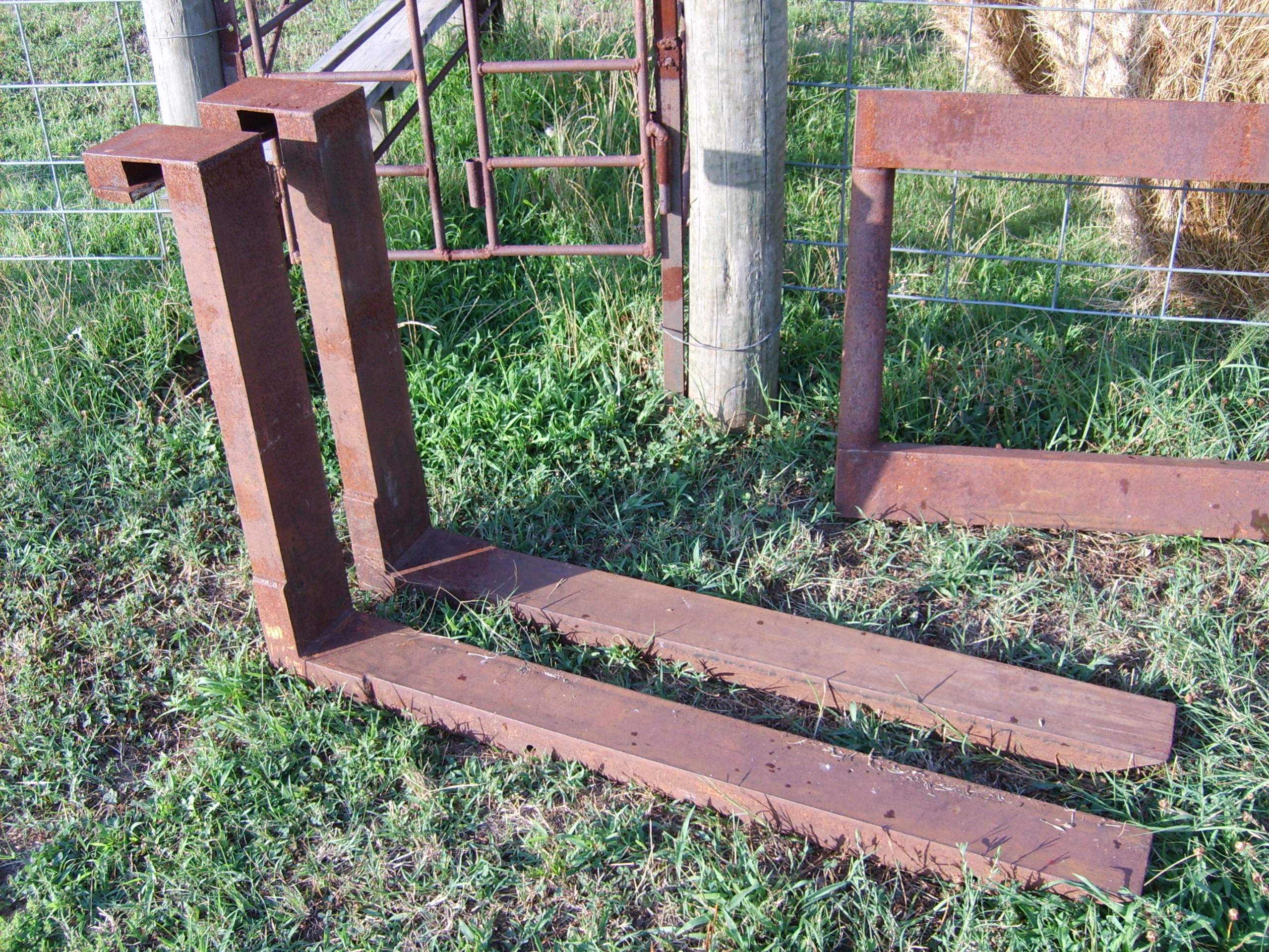

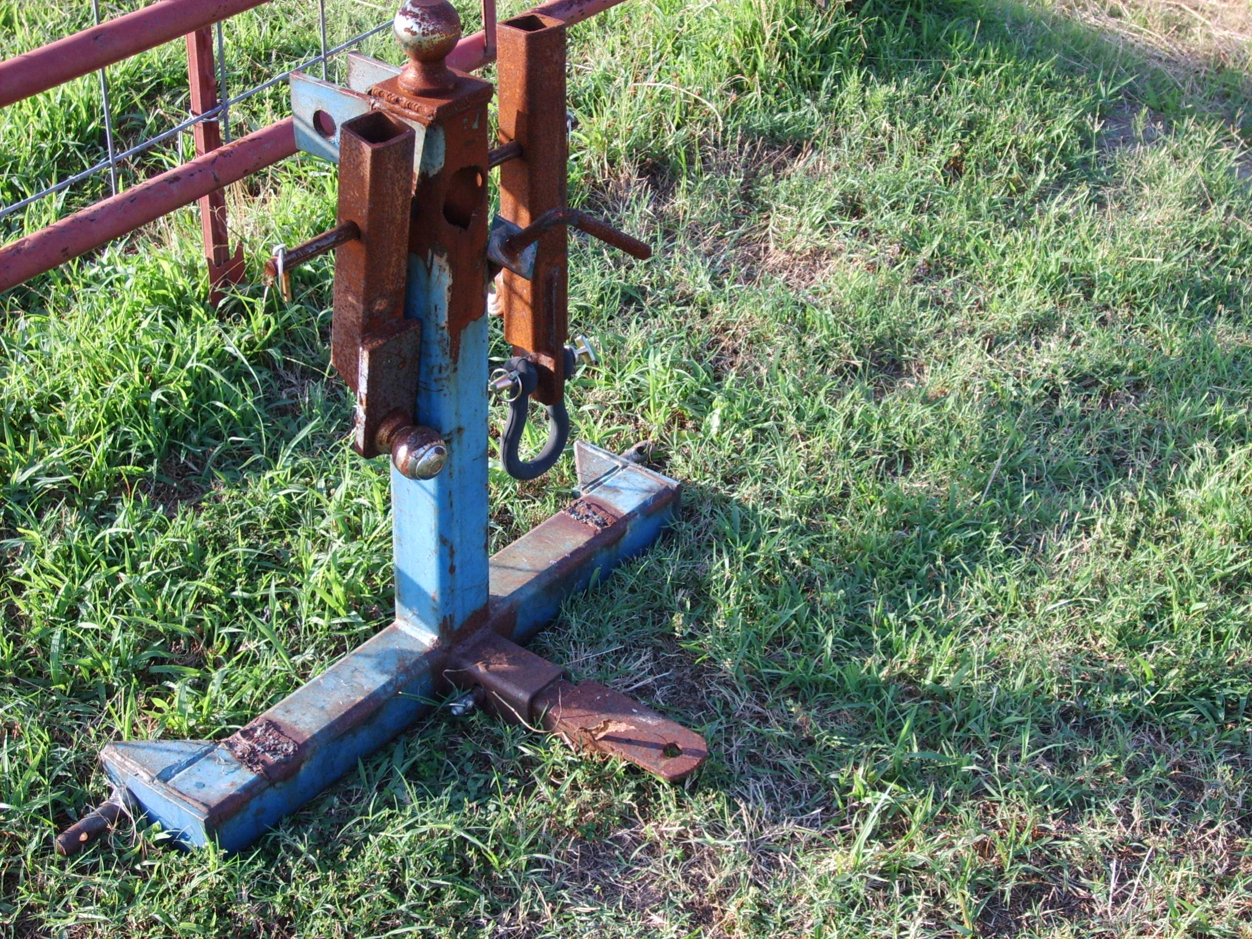

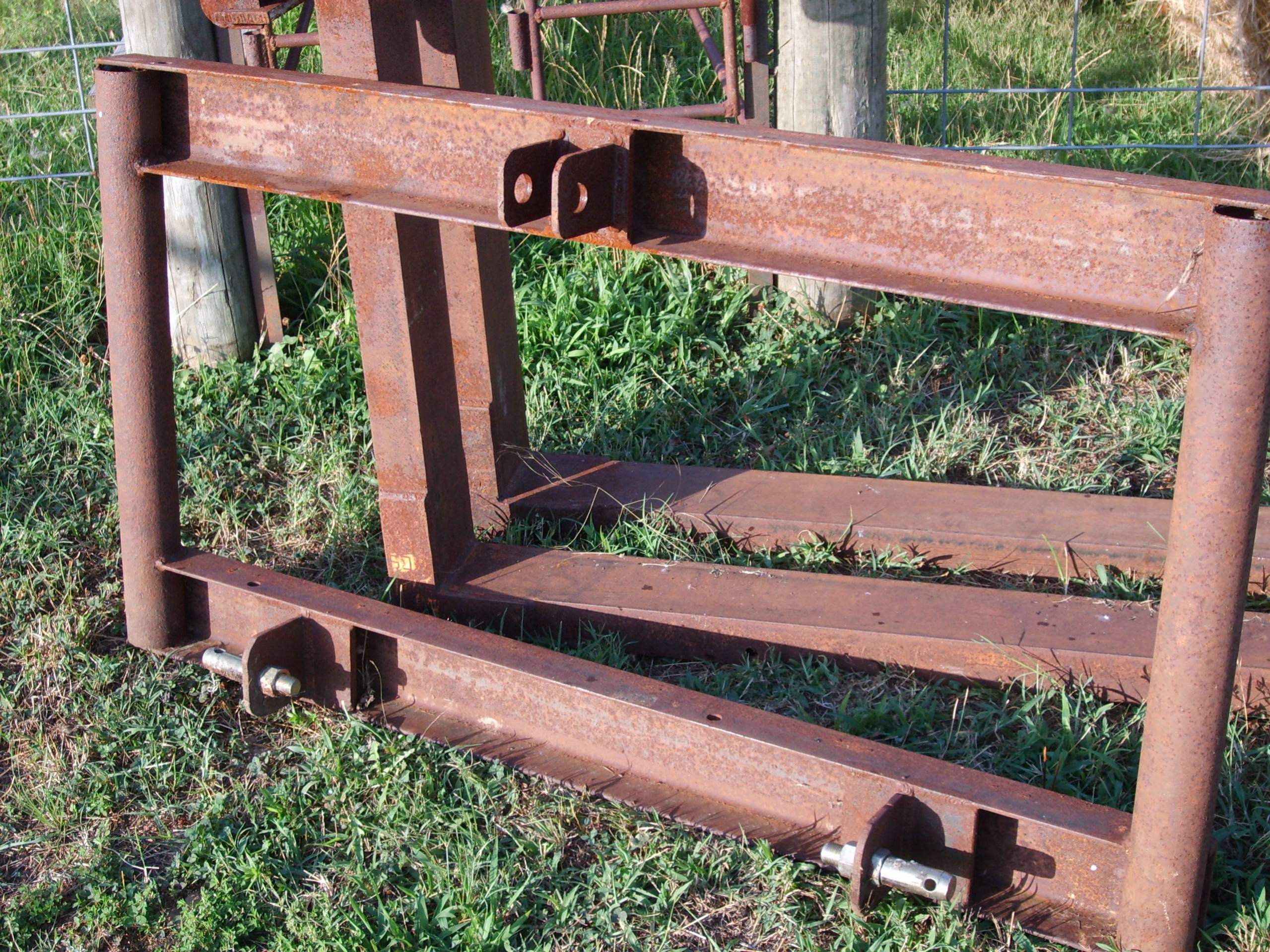

Quick and dirty ripper I attach to the 4in1. Made from scrap in about 60 minutes. Handy for cutting through the thatch of Kikuyu grass that grows very thick and tough here. The forks were pretty cheap but probably cost more than $50 in metal alone.
