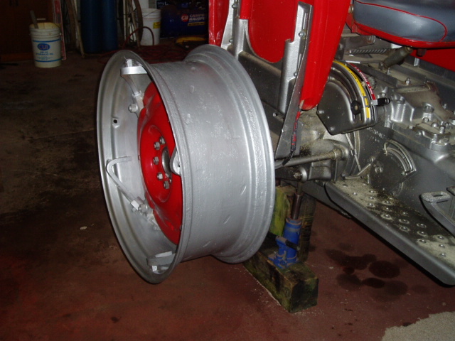

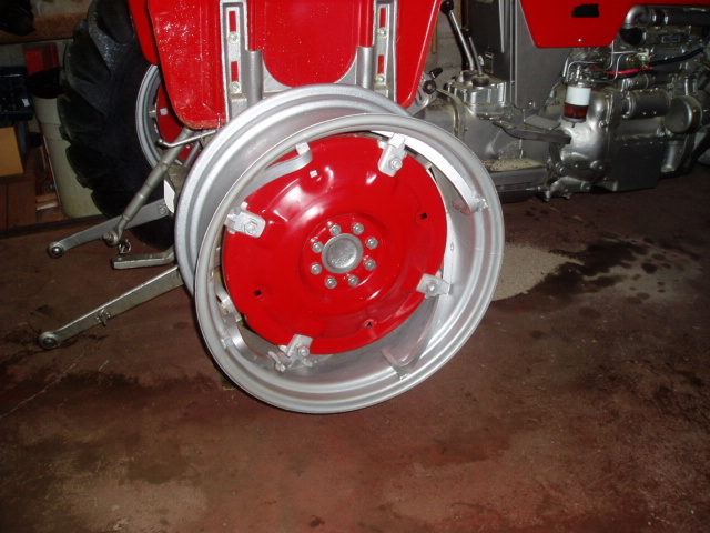

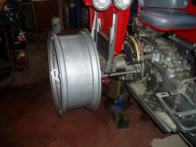

Uh.... The tire's missing.
While bush hogging today, I found a nail someone lost. It was a slow leaker. The fluid (ca/cl) leaked out of the tube but stayed in the tire....for a while anyway. It started leaking out the nail hole in the tire. We got the bulk of the fluid pumped out, but the tube was trashed. (valve stem ripped out of tube while driving out to the trailer) No spare tube on the shelf (like there SHOULD have been.) Gotta make a trek to the tire store tomorrow. Meanwhile, since the tires were mounted 12 years ago, rims had a bit of rust. Time to wire wheel and paint the rim in case it's another 12 years before I see it again.
Some days it just doesn't pay to get out of bed.

Any plans on investing in "metal" jack stands? I too have used blocks of wood, concrete, bricks, etc. in a pinch to get something propped up, but in the shop? Maybe you have some under it that is not in the picture. If that block fails, and you end up pinned under the tractor, you may not get out of bed for a long time. (Friendly reminder):eek:

I'll agree with Farmwithjunk, a few 6x6's 2' long and about anything can be propped up safer than jackstands. personally I don't liek using jackstands on anything I'm banging on or attempting to persuade something that doesn't want to move into moving.

My father-in-law moved houses for a living. Him and his crew had to crawl under the jacked up house in order to position the trucks (wheels). We're talking an entire house and not just a 5000lb tractor. Guess what they used for cribbing? That's right. 6X6 timbers. Positioned correctly, they'll hold anything that the stoutest of jack stands can, and do it with ease and simplicity. Set a metal jack stand under an odd shaped part of a tractor and you'll end up with a small contact point of metal to slick metal. Do that with wood and that odd shaped surface digs in to the wood and provides an additional margin of saftey.
