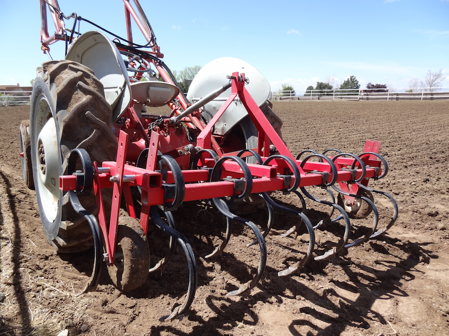

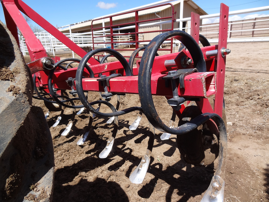

I want to replace my 8N with another used tractor. The reason is that when I pull my spring tine harrow with 13 Danish Sweeps I get bogged down if I go 6 or 8 inches deep. I thought I needed 4 wheel drive and a little more HP. I ran it this morning and my problem seems to be spinning the back wheels especially if the ground is moist. I did not stall the engine. I thought I needed 4 wheel drive at around the same HP. Now I'm not sure if I would be better off with a bigger heavier tractor with more HP or a 4 wheel drive with about the same HP. Any ideas?

Just a thought but maybe duals with the tractor you have will give you the traction you need. If you're spinning your wheels that says that you're not lacking HP you're simply lacking traction. I don't think 4WD would help much in pulling that plow as all the weight is on the rear so that's where you need more contact with the ground.

The loader isn't helping your rear tires get traction, because it's taking weight off the rear axle. Now, a similar HP 4wd tractor with a loader is a whole different animal from an 8n. Superior in almost every possible way. That said if your only reason for upgrading is for better traction, I'd first consider loading your rear tires (unless of course they already are). You could also add weights to the rear wheels.
I've never seen duals on an N series Ford, but I'm sure someone's done it. Duals are for flotation, not really for traction. If you need more traction, you need more weight over those drive wheels. If you start sinking in, then duals come into the picture.

That loader is killing your traction take it off and see a world of difference.
/ What tractor to buy #15
I'd take the loader off and then add as much ballast as possible to the rear. I'd load the tires, and add suitcase weights.
