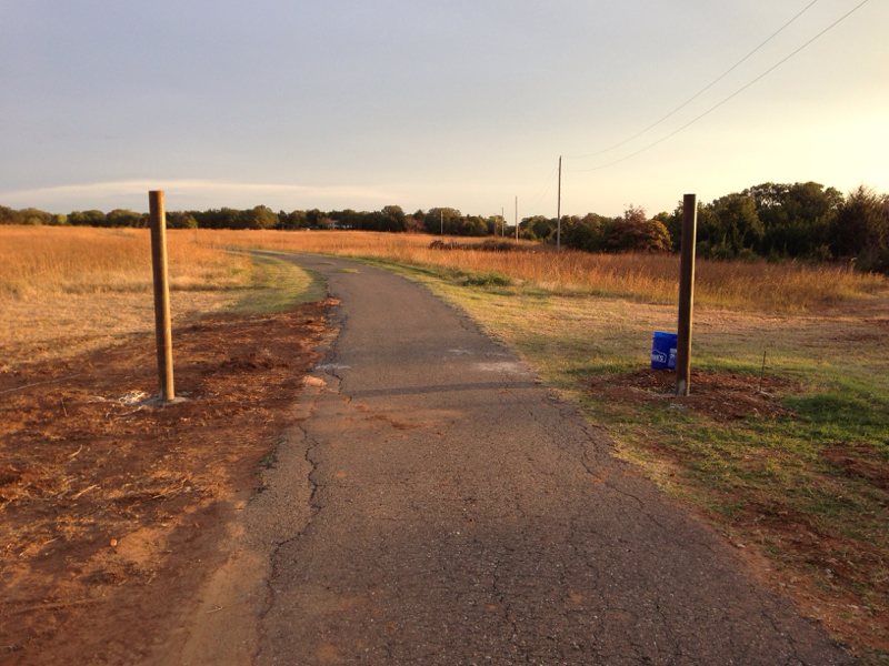

#30
Got them in the ground. Got to about 32" before I started hitting rock. Hope it works for a 14' 115lb gate.

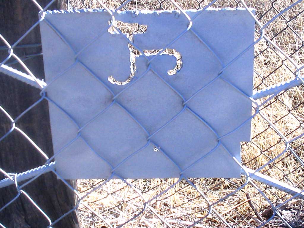

So did I. Can you post a picture of your setup?
/ What to use for gate posts #39
I built a couple of simple gates this summer for our property. The main one is simply made out of 2 1/4 exhaust pipe. It's light but looks heavy. The 1/4" x 4" pole is set in cement 3' into the ground. I'll be installing an automatic opener on it this spring.
I do like the look and elegance of heavy but light and simple design. I think you need a plasma cut 'Speciality Repairs' logo midpoint.
