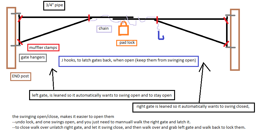

posts wood / metal / concrete, will leave that to others...
i have 1/2" and 3/4" pipe, with some U bolts holding it all together.
one gate wants to swing open all the way
one gate wants to swing shut
i picked up a J bolt, to use as a hook, and some cheap chain, so i can hook the gates open. ( T post, current fence what ever ya got there)
i also have a couple pieces of chain in center. so when both gates are closed together. i can give one or two wraps of chain, and toss on a paddle lock.
paddle lock, it is worth getting one dipped in rubber, with cover that goes over key hole on the lock. ((keeps out a lot of dust / snow / ice that would cause lock problems))
trying to get two gates that always want to natural open "CLOSED" is well a rather pain.
trying to get two gates that always want to naturally close, is also a pain.
less walking back and forth to open/close gates atleast for me, if one naturally wants to swing open, and the other wants to naturally swing close.
if you go with a full gate for live stock and like. get a boat trailer jack (has a wheel vs just a piece of metal on the bottom of jack). and fasten that to the gate end. make it so much easier fighting snow / mud. just crank the jack some lift the gate and she opens, and no need to physically lift gate or drag gate, as it opens / close
i have had trouble in past with gate wanting to come off the hooks, (hooks that fasten between posts and gate), bailing wire ran around hooks and holes on gate, i don't know half dozen plus times around. it looks crummy, but its not going any were now.

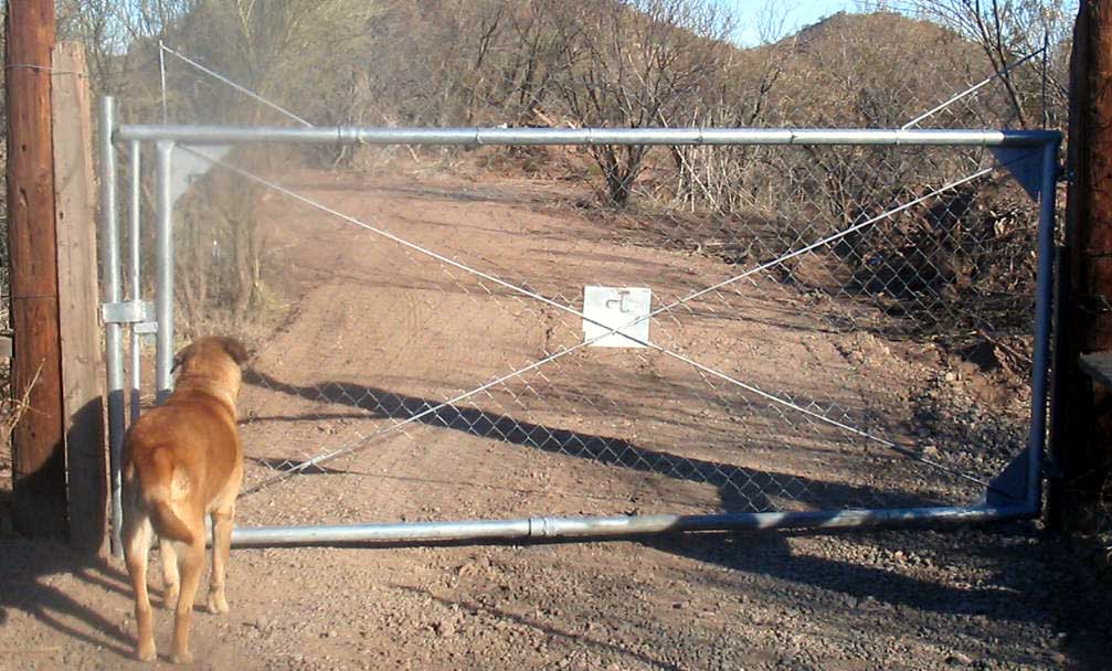

I wanted 4" galvanized steel posts for my 14' heavy-duty tube gate out at the main road. After I got shocked by the cost to buy new, I tried the local metal salvage/recycle yard and lucked out. Got 3 slightly used 4" x 8 ft heavy galvanized steel posts. The yard manager said it was more trouble than it was worth to try to figure out how to have ME pay THEM instead of the usual other-way-around, so he GAVE them to me! I now occasionally "donate" some scrap metal to the yard.
Had to have my BIL use his blasting drill to make 4' deep holes in the rock, then concreted them in, one on each side of the road. I left the hinge-side one a bit tall so I could mount a solar gate operator and control box using some big 4-1/2" muffler clamps - very easy and also adjustable!
- Jay

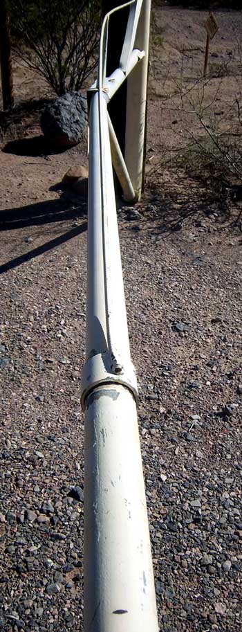

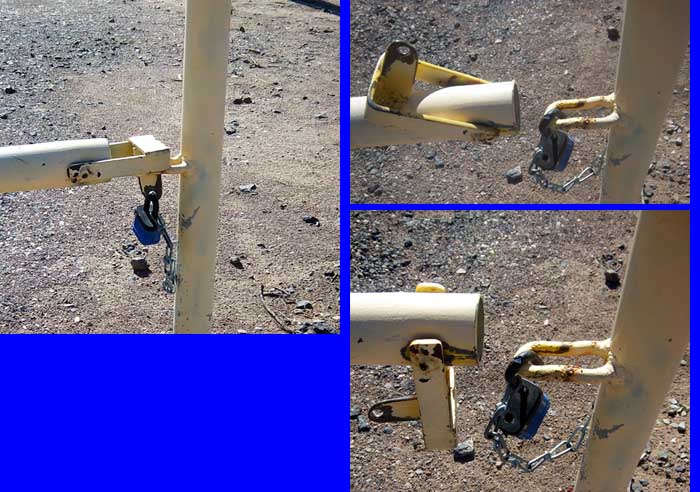

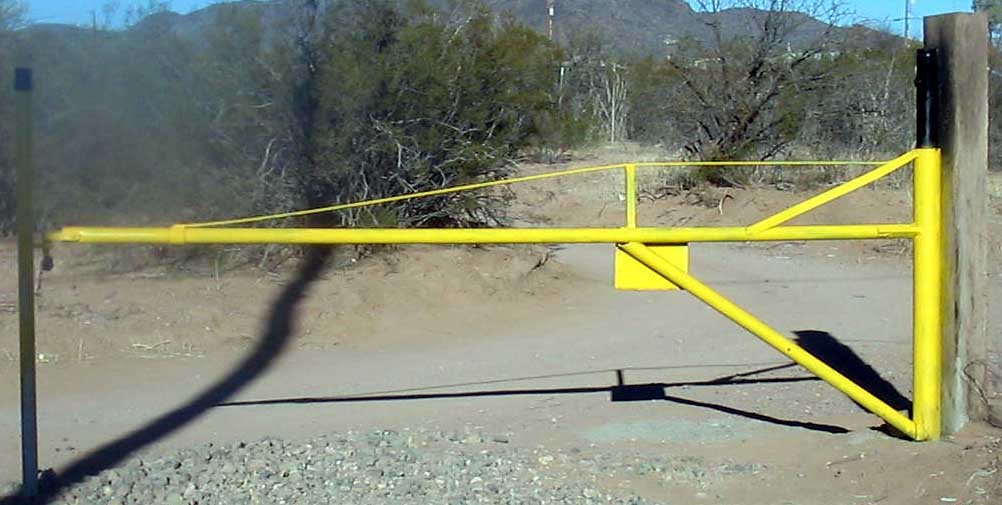

Pictures of a gate that I built. Good gate for vehicles. It's 12' 6" wide. Support posts are 6" pipe & RR tie. Both set in concrete.
Latch post 2" pipe, driven into ground. Simple flip latch that locks. Neutral swing, stays where put.
It was run into & bent as shown in the picture, nothing gave way or loosened.

Pictures of a gate that I built. Good gate for vehicles. It's 12' 6" wide. Support posts are 6" pipe & RR tie. Both set in concrete. Latch post 2" pipe, driven into ground. Simple flip latch that locks. Neutral swing, stays where put. It was run into & bent as shown in the picture, nothing gave way or loosened. <img src="http://www.tractorbynet.com/forums/files/rural-living/396448-what-use-gate-posts-yellow-gate-1-jpg"/> - <img src="http://www.tractorbynet.com/forums/files/rural-living/396449-what-use-gate-posts-yellow-gate-back-jpg"/> - <img src="http://www.tractorbynet.com/forums/files/rural-living/396450-what-use-gate-posts-gate-bent-jpg"/> - <img src="http://www.tractorbynet.com/forums/files/rural-living/396451-what-use-gate-posts-gate-latch-jpg"/>
That looks quite secure.
It's good for horses, grown cattle & vehicles. Even off road type.
Should I want or need a wider gat i would put a pull out post in the center. Could not be pulled if gate is locked.
I don't want tall posts on my gates, like to be able to lift long objects over them.
Pictured is another gate I built & hung. Commercial gates, even the ones called heavy duty, are made of thin tubing.
Gate pictured is made from water pipe. By making my own I can add custom touches.
