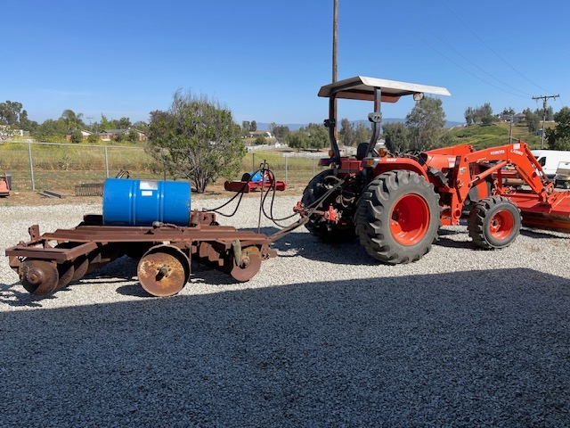

My search has led me to a cultipacker. This 6 ft 465 pound clod buster looks like the best solution but at $1k price and $500 delivery....I'm hesitant.
I've thought about making something, like a PVC pipe filled with concrete ? I could drill and insert short bits of rebar through it before filling with Concrete to add spikes but then it would need axles and bearings at each end to roll. It gets complicated.
My disc has wheels
Also I found 4ft ATV cultipackers. 2 would work, they are cheap ($250 each free ship) but light and poly construction. I could add weight (fill with concrete slurry?) but I wonder about the longevity of these?

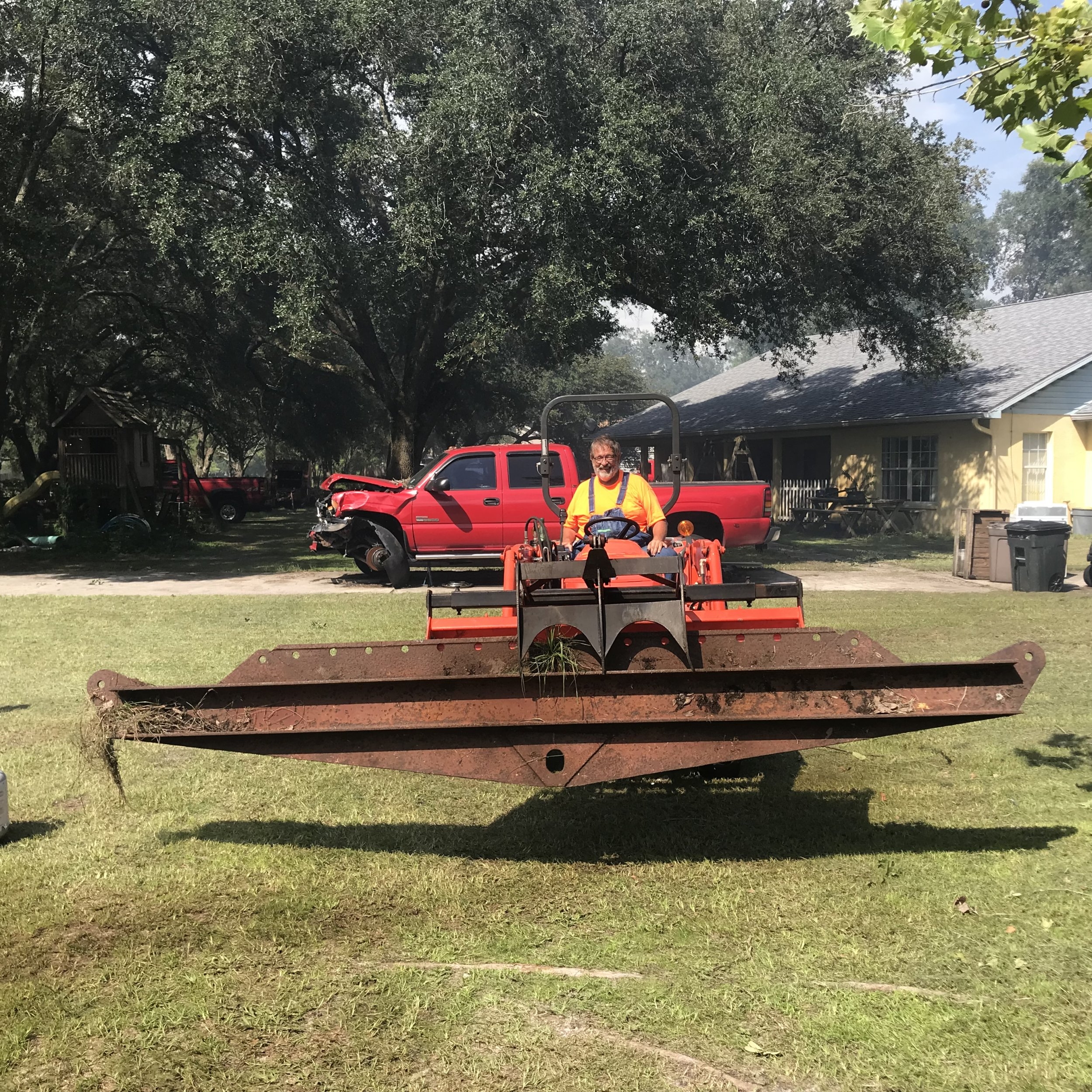

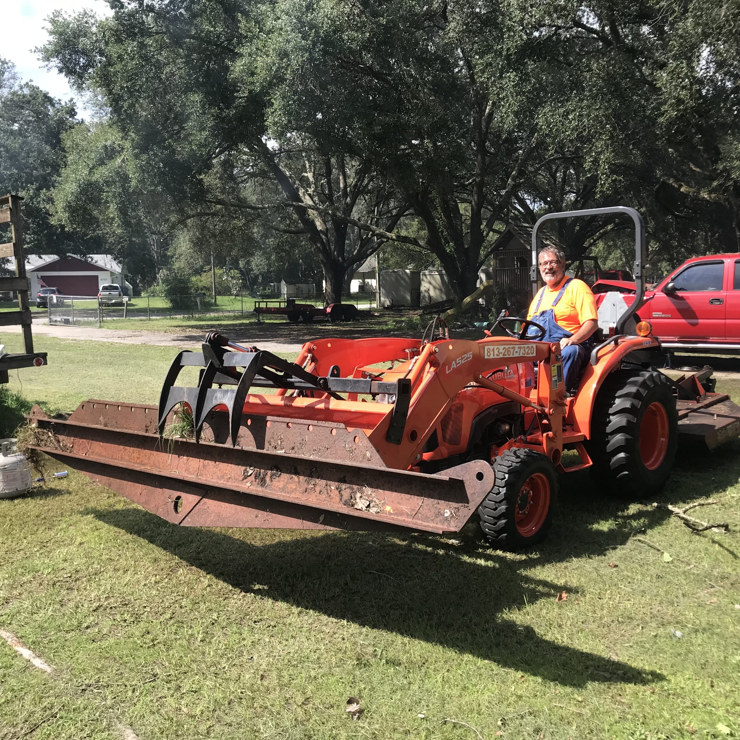

I was able to trade 2 bales of hay for this spreader bar. With all the attachment points I can angle it to move dirt if needed.
I pull it with a New Holland TL80A pulling an eight foot Rome Plow. It makes things very flat.
It is a load for the L2501 to pick it up to set it on the trailer.

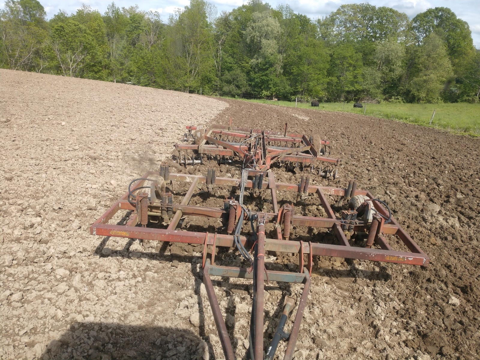

There are a multitude of items that can be pulled behind a disk, rolling baskets, spring tooth harrows, culti-packers, rollers, logs, planks.
Depending upon your soil and the desired finish results.
And then you can use chisel plows and pull a disk behind that.

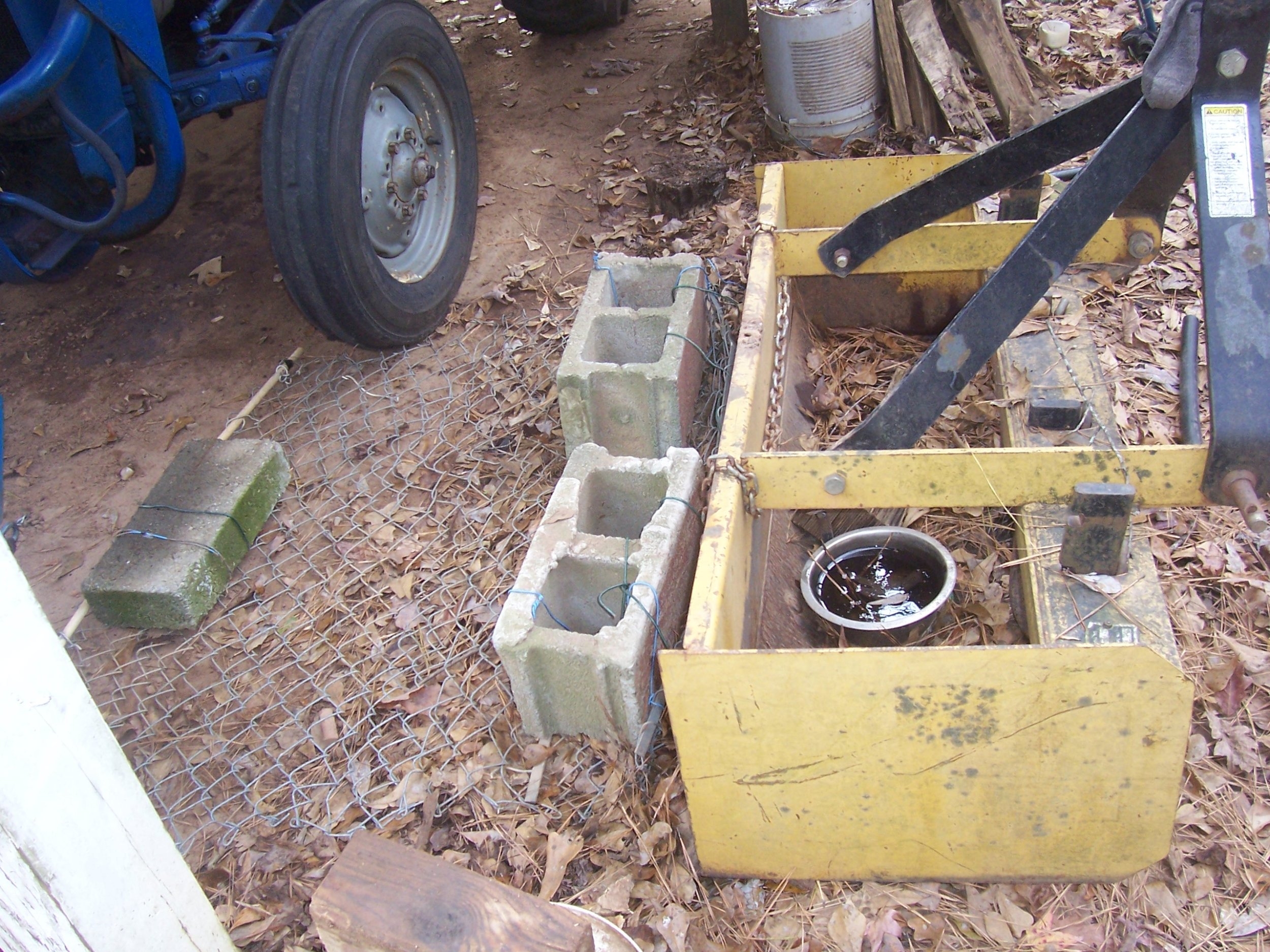

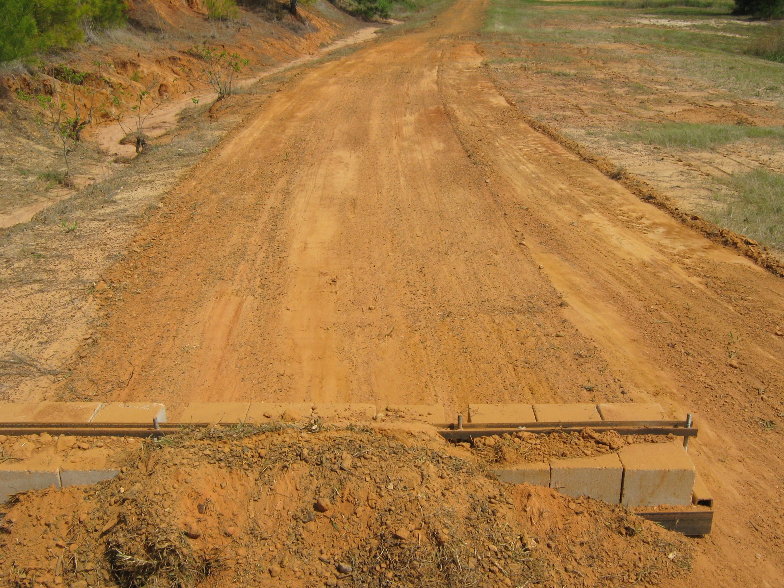

What works really Easy and Cheap. I drag a piece of old Chain link Fence weighted down. Esp. when I Drop my rippers and drag it. Works fantastic behind my few hundred feet of Crush Run driveway. Use it behind a Yanmar for 15yrs.. I'm sure dirt or turned soil would be just as easy. 1 pass and super cheap and smooth. I gave 75$ new for the BB. to grade the Rd. The fence came off a old gate that had to be replaced so it was a freebee. ;)

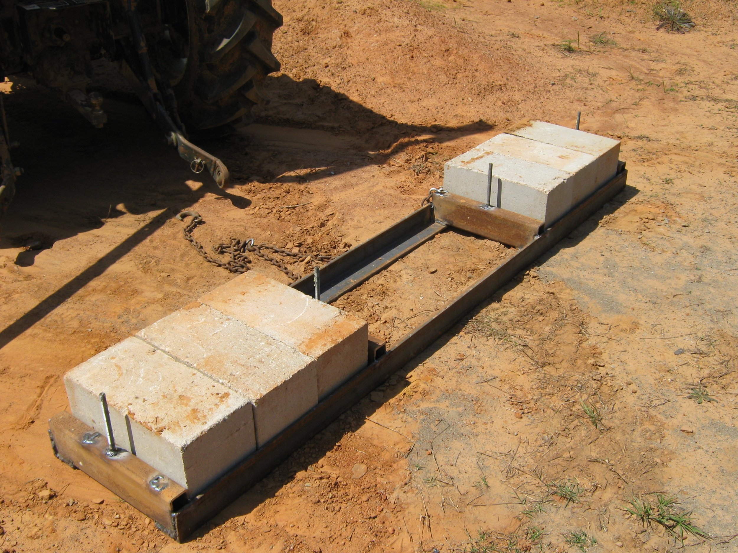

I made this almost two decades ago, and it works pretty good on clean soil, but if I take it into anything with branches of any kind, they get stuck under it and dig a never ending trench.
I just don't think it would accomplish anything after disking.

I never had any problems with sticks or debris. The rippers broke it up and then the BB would catch and hold all the bigger debris. The grass was shaken out of the clumps and never a problem. Stop lift up the BB. and clear it out.
