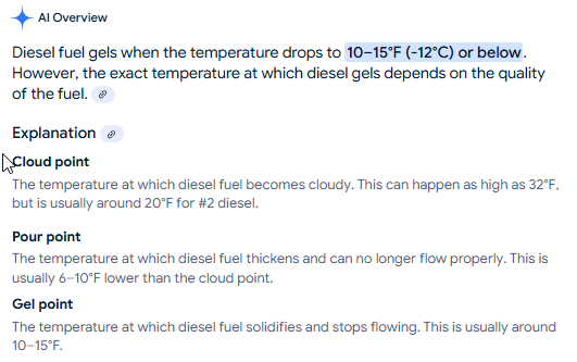

It's cloud point you are worried about. That's where crystals of paraffin start to form. Those will clog the filters.
"#2 diesel fuel has a cloud point that can range from -18 to 20 degrees Fahrenheit" Reaching the Cloud Point | Diesel Pro Power

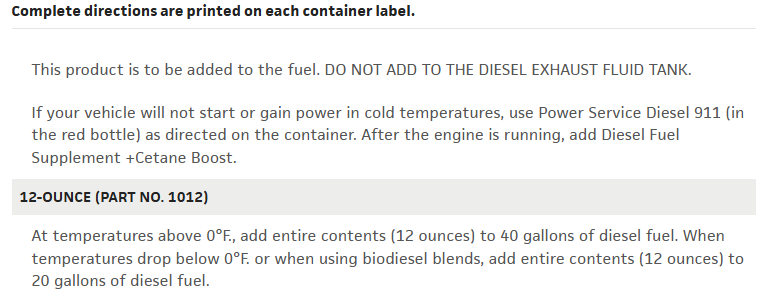

I treated all my diesel vehicles and tractors with Power Service white bottle just to be safe, plus topped them all off with fresh diesel so they have some winter blend in them. I did have one pickup not start at 20F before so I want to be on the safe side. Also have 2 bottles of the Diesel 911 on the workbench, just in case. The Power Service directions say to treat biodiesel with a higher concentration of additive. It is hard to find diesel that doesn't have biodiesel added. One of the local feed stores has it, although it is more expensive than other locations.

I have both. Adding the white bottle ahead of time is easier, just add it to the tank. If you freeze up 911 goes in the fuel filter as a 50/50 mix with fresh diesel plus adding it into the tank. But it works.

Numbers can be all over the page due to fuel type and quality. The numbers I have settled on are (untreated summer diesel):
The Cloud Point is from 20-32 degrees F
The "Cold Filter Plugging Point" (CFPP) is 10-15 degrees F, which is where fuel problems will first be noticed. The spec is based on a quite coarse filter of 45u, which passes much larger particles than the typical diesel fuel filter.
Gelling occurs at 0 degrees F.
Most operators keep a 911 type product on hand, as well as spare fuel filters. If you anticipate unusually cold temps for your region in the teens, I would certainly be adding an anti-gel product and ensure that it is run all the way to the injectors.
