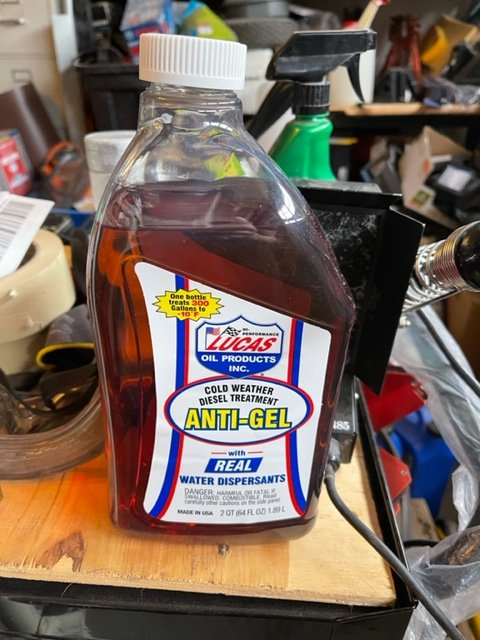

So about 2-3 weeks ago, we had a huge snowstorm. After 2 days of being snowed in, I decided to try and clear my 300' driveway with my BX. Unfortunately, I could not get it to run for more than about 2-3 seconds. I figured that it was due to fuel gelling up or something. A week later, temperatures warmed up and I was able to start it and clear the driveway. Not wanting to have the fuel gel up again, I added some anti-gelling additive. We are expecting another snowstorm tonight/tomorrow so I just went out to move the tractor into the driveway in preparation. While I was moving it, I smelled diesel, so I looked at the fuel filler and noticed NO CAP! Oh No! I put the additive in over a week ago and we've already had 2-4" of snow between when I put in the additive and today. No doubt, some snow has found it's way into the filler opening. What do I do now? The tractor seems to run fine at the moment. Of course tomorrow evening after the storm, temperature is supposed to drop to -4*. Any suggestions? Just leave it and hope any moisture eventually works it's way out of the system?
A few years ago my dad was using my tractor and got water in the fuel. He drained everything but did not change the filters, Well the first real cold night we had the water in the filters turned to slush and was sucked into the injection pump. I took the lines off of the pump and found the ice. It cost me a rebuild on the injection pump. I would say new filters would be a must if it was my tractor.

Let tractor sit. Fuel and water will separate. Get small tube (1/4"-3/8"). Push it down to the bottom of fuel tank and siphon out bottom of tank... That's where the water will be. Siphon to clear jug so you can see clear water turn to yellowish diesel as you get it all out. Then I'd run it a bit so fuel pump circulates what water is left with the product you added to the tank.

Update: Well since then, I've put about 3 hours of use on the tractor, moved 35 tons of AB3 gravel, and it has run normal the whole time, so I guess it was a non-issue after putting in that additive. I also purchased a couple of new filters and a racor clone filter/separator to splice into the system but you know how it goes... work first. Then discovered the steering cylinder is dripping so another $300 expense upcoming. I'll will get to splitting the fuel lines and replace the filters but that can probably wait for fairer weather now that the tractor seems to be running normally. Thanks everyone for chiming in. I initially thought I screwed things up big time, glad that it was a scare more than a real issue. These tractors are really fuel efficient... I still haven't emptied the tank yet with all that work.
