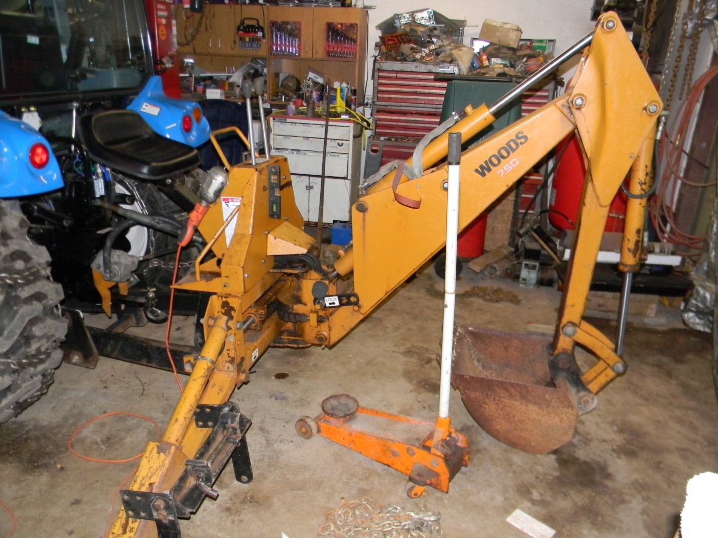

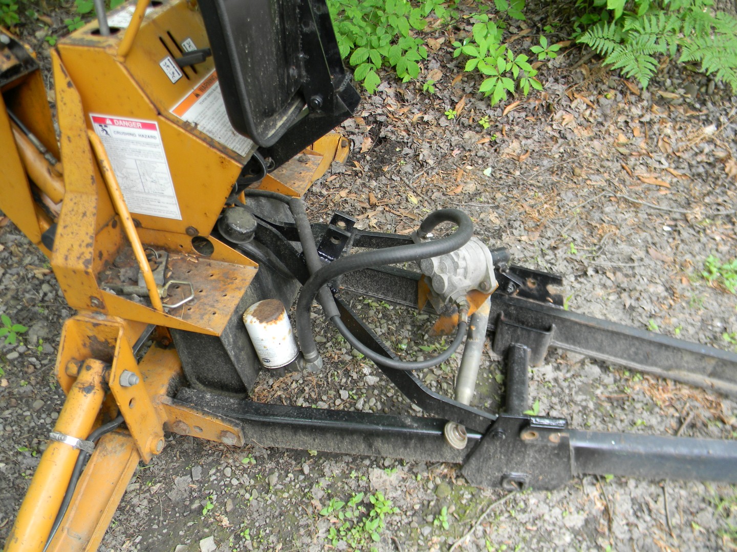

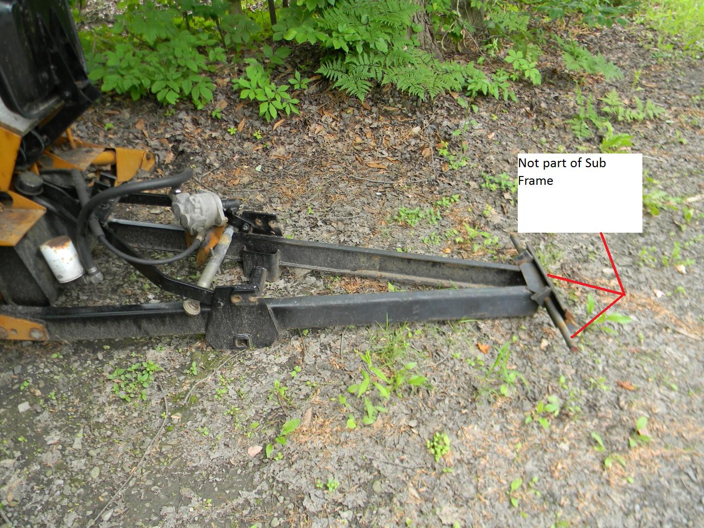

Here's some pics and info for the Ford #8401 Sub Frame. This frame is supposed to fit Ford 1320,1520,1720, & 1920 models. Not sure if 1700 is the same but probably similar. This frame is on a Woods BH750-3 I bought and adapted to fit my tractor. It is made of C Channel but it has several sections of flat steel welded in the C to box it in for strength.

Measured the channel on mine and it's 5"x1.75" x 3/16". The first 3'of the frame is boxed. (End closest to the hoe.) If you do a search I posted a bunch of pics a while back.
