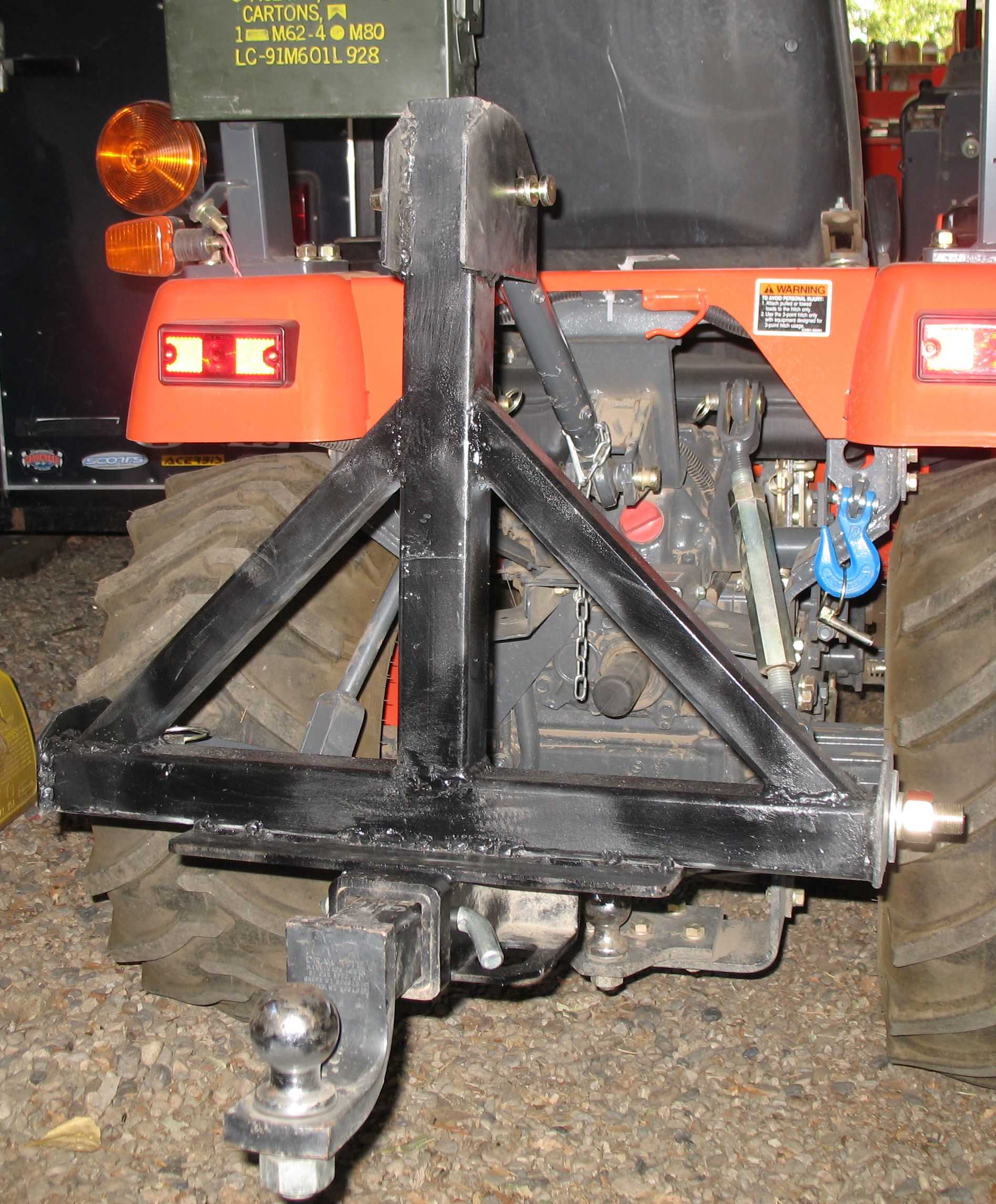

   / What kind of welder should I buy #26
Gordon21,
I welded all of the bucket hitch. I just didn't paint the T handle.
Attached is another one of my mini projects that I welded with the simple Hobart 140.
