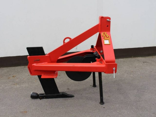

Several years ago I borrowed a 3-point equipped mini-dozer. On the rear it had what I would describe as a sub-surface plow. It looked a lot like a long scarifier or cutter from a standard grader box.
In essence you could lower it several inches into the ground and it carved out a tunnel if you will. It allowed yard drainage without digging a ditch. I ran several passes down my hill and it pulled off a lot of runoff water
I suppose it could have been a custom build. I've tried to do this with my grader box but depth is not very deep. In addition if dragging only one scarifier, there is a lot of side load on the 3-point. I'd like to buy one. don't know the name to search for it. Thank for your time

sub soiler
/ What is the name for a Sub surface plow? #3
Yup....in tractor lingo it's a subsoiler.
If you had something similar on a dozer it was probably called a ripper.
/ What is the name for a Sub surface plow? #4
Subsoiler and when you attach a plow point to it we call it a middle buster. Nowadays the subsoilers are much different than the old ones in that they go much deeper and have trip functions or shear pins on them.

You will need a subsoiler specifically designed for the limited TPH vertical adjustment on subcompact tractors.

Mole plow, Mole ripper.
I first learned of a mole plow (or plough) in a British video about old methods of drying out wet fields.
