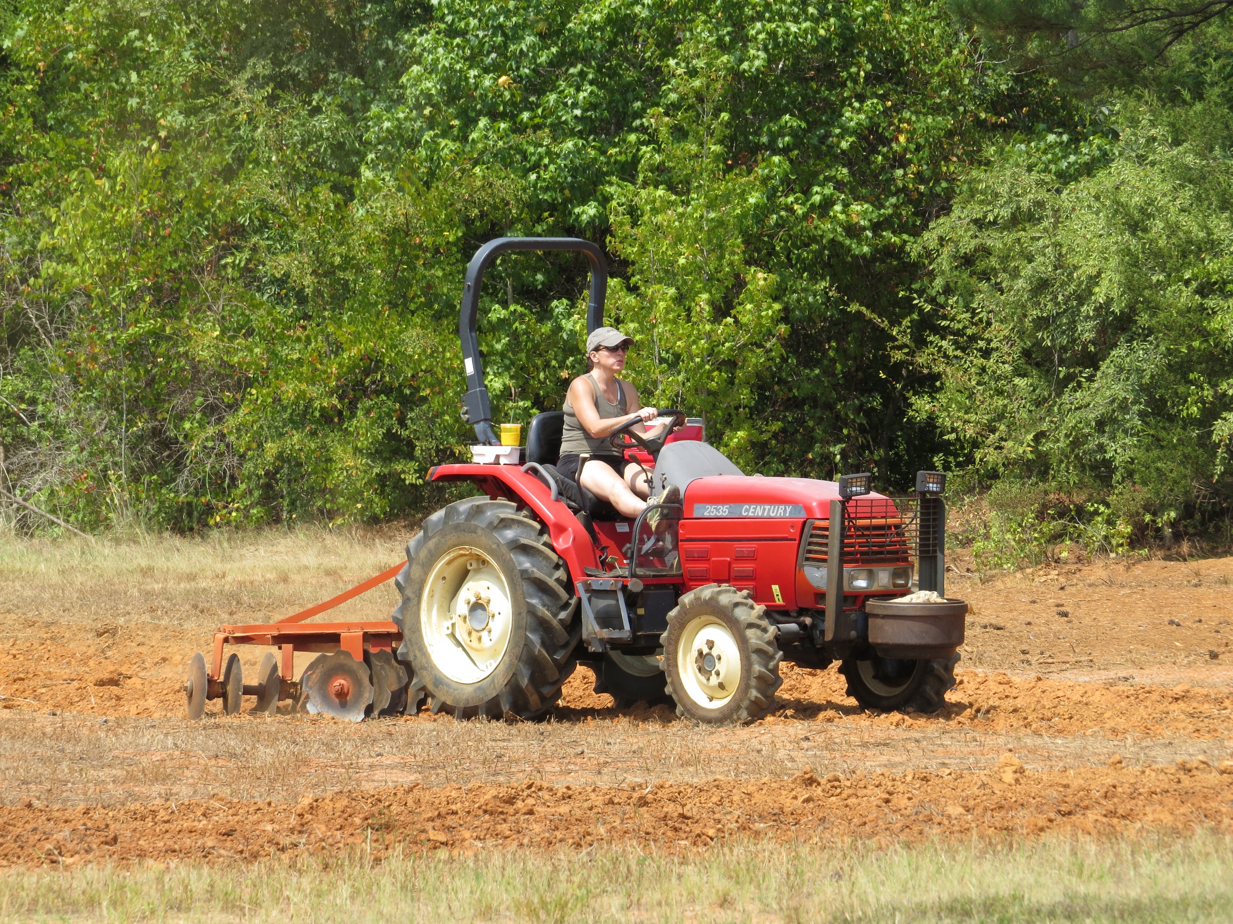

My best implement for food plots is my wife!!! She will stick with it and keep working the ground until it's all fine powder.
The disk was a $300 Craigslist find that's 5 feet wide and made from angle iron. It works OK, but it takes a while for it to break through the ground. Once that happens, the results are worth the effort.

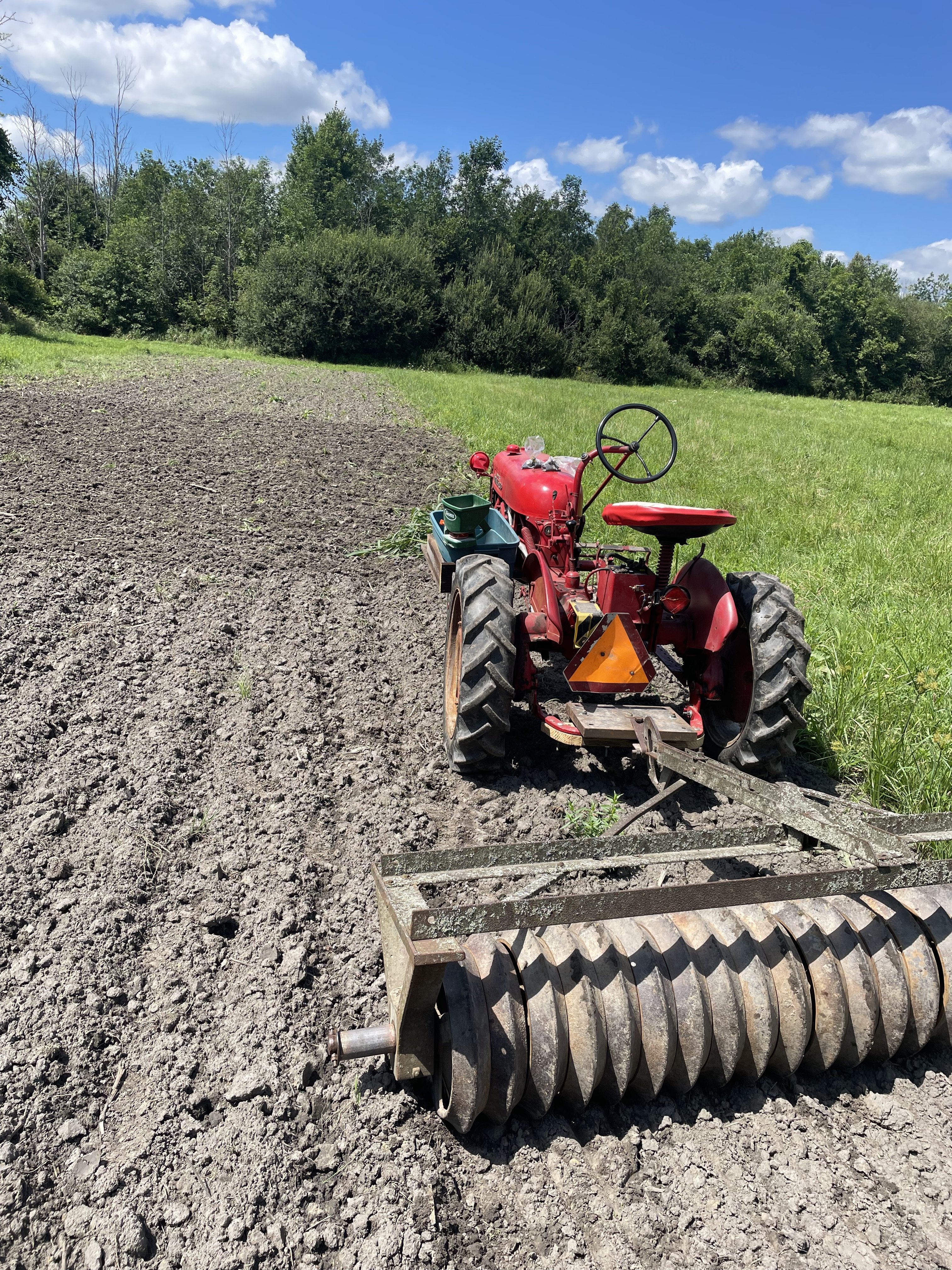

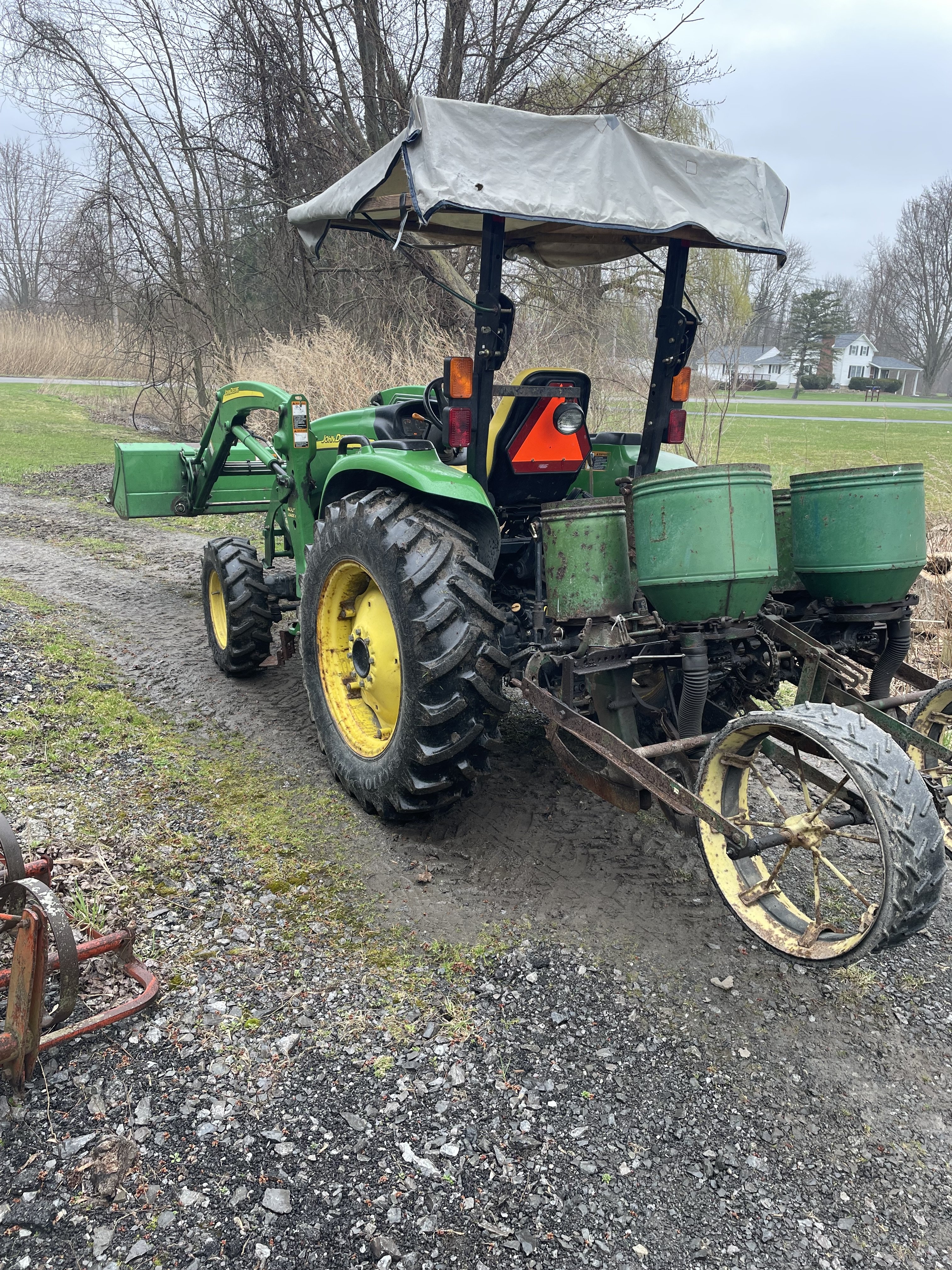

My three favorite implements are my 7 ft cultipackers (have (1) on each property that were cut down from old 8 footers that had a few busted wheels), and my John Deere 246 2-row corn planter with fertilizer hoppers.
A “real” cultipacker is hard to beat, for getting little seeds like clover and brassica to just the right depth, and maximizing germination. I’ve tried other substitutes like dragging railroad ties, logs, bed springs, lawn rollers, or atv tires and all were horrible in comparison. The culvert type contraption looks good but doesn’t have the large clearance between the axle and the individual cultipackers wheel hubs, which is the real “secret” to their effectiveness.

To minimize costs, I rotate crops 3-4 years white clover, 1 year corn or brassica, which gets me most of my nitrogen for free, minimizing fertilizer expense. I only use Roundup on the corn rows (big advantage of the row planter) and I get the seed free for that corn (prior season’s leftovers from family & friends)

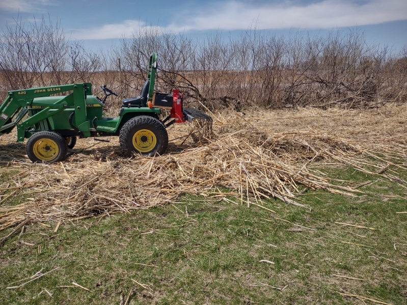

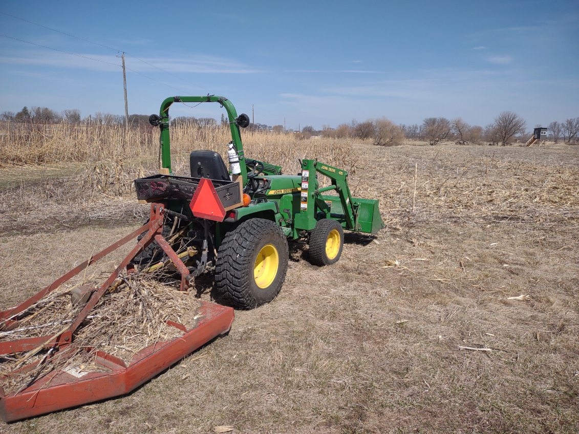

We have all the usual implements (disc, drag, rototiller, straw rake), except a corn planter (SIL says he really wants one) and a cultipacker. We also have a 9 foot chisel plow if needed... We broadcast the various seeds we use. The idea of a regular corn planter was that we could harvest the uneaten corn for the next years planting. Not needed. The deer HAMMERED the corn and there was nothing left this spring. I just mowed it all down. The (Chinesium - Amzn) straw rake is used to rake up the heavy residue from the tall grass, it would plug up the tillers bad. I'm adding 100 lbs of weight to make it work better. I do like the DIY cultipacker (probably 3 point) ideas (uTube is a great source for ideas)...

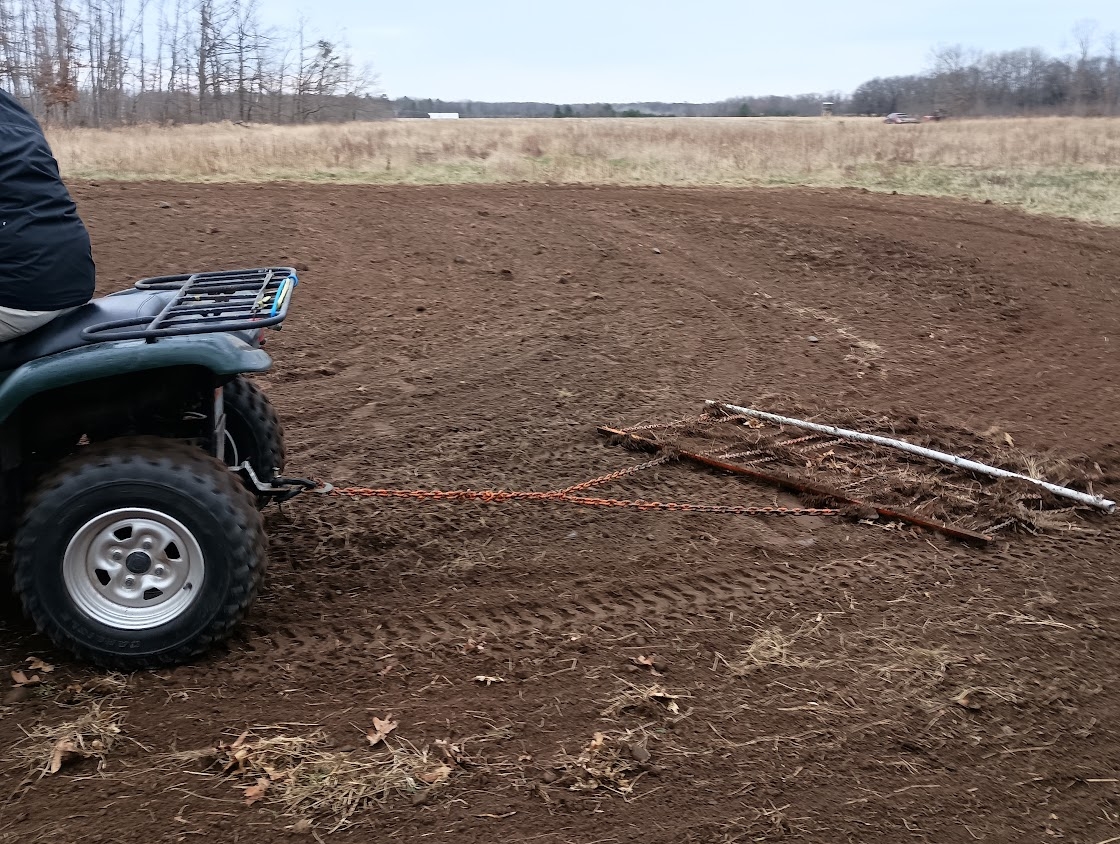

Just curious, how does a cultipacker control the depth of the smaller seeds? I have never used one and am looking for a dependable method to plant clover and other brassicas out.

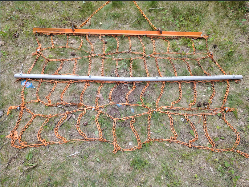

Those tiny seeds like to be 1/8"-1/4" deep. My homemade tire chain drag, followed by a roller or cultipacker does a nice job of that.
