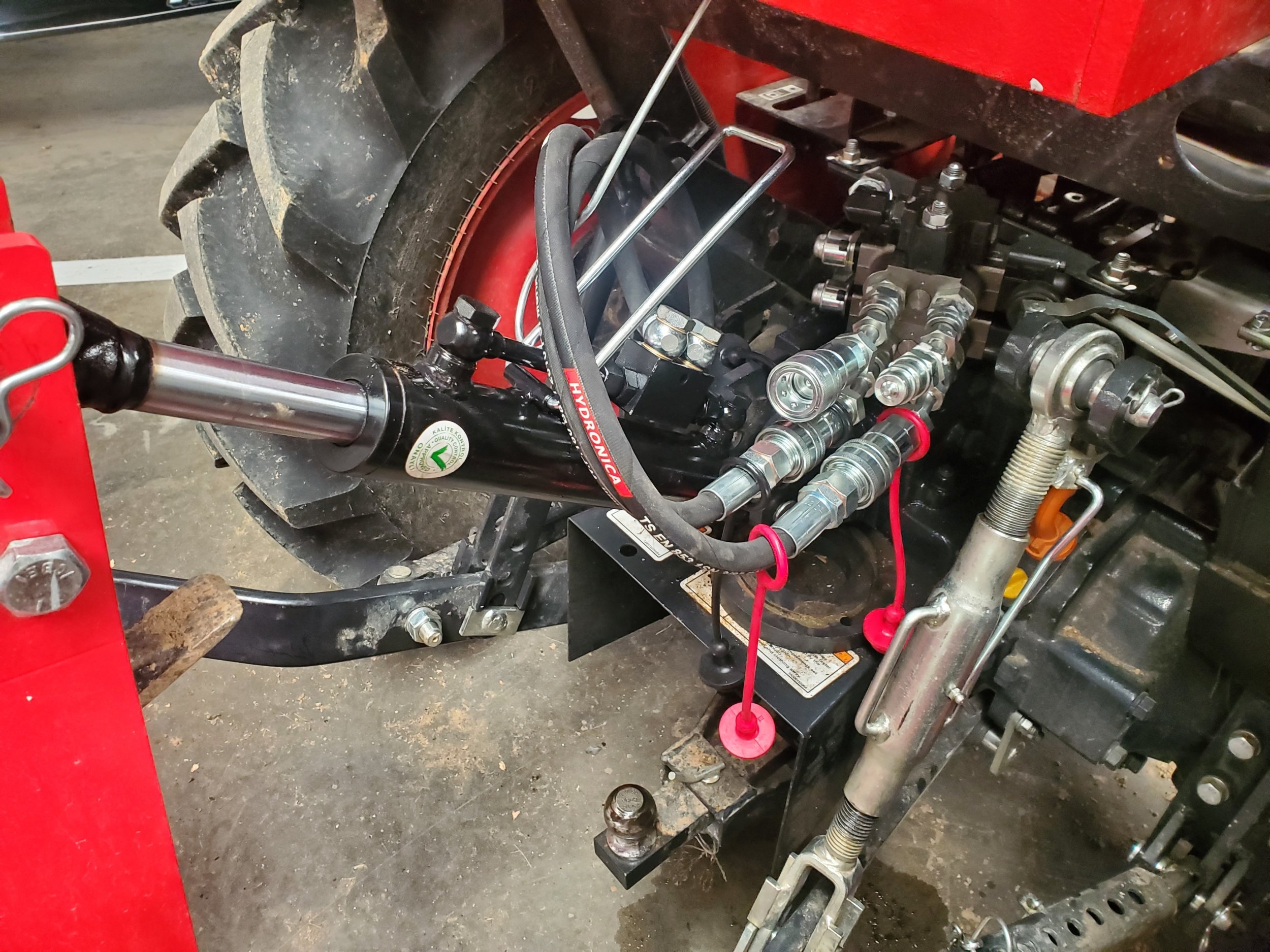

Installed OEM rear remotes and hydraulic top link. now waiting for the hydraulic side link to arrive.

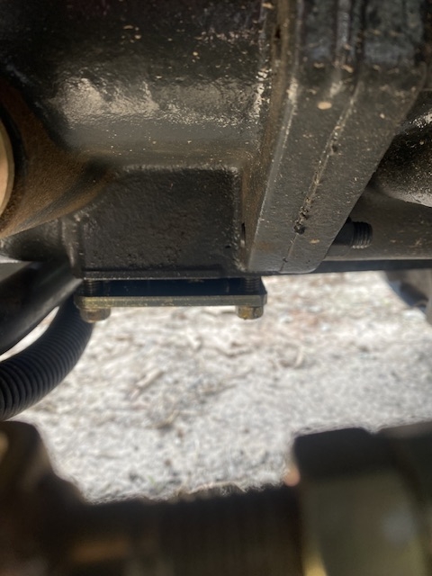

So it was the front diff pinion seal leaking and moving all the way back through the driveshaft cover and leaking on the cover plate with the cotter pin?
Wondering if the backplate between the engine and the bell housing is loose and causing issues.
   / What have you done to your Branson today? #1,468
Very well could be. The clutch adjustment issue started at the same time as the leak. Likely they are related. On another note they did pull the inspection plate. I know because they forgot to tighten the bolts and all have backed out with one missing. :ROFLMAO:
I will have to get a bolt to replace the missing one and tighten it up.
