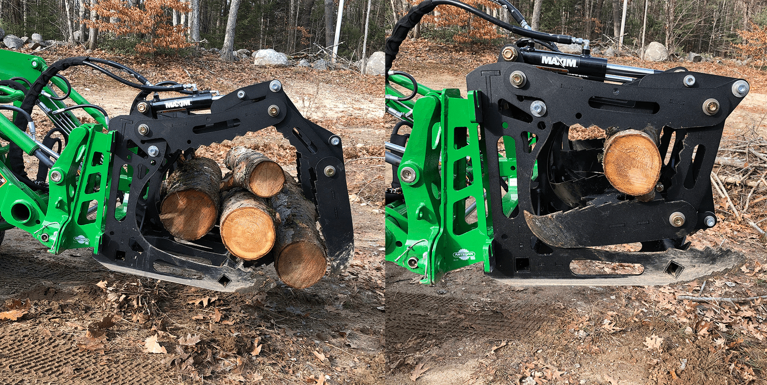

Zork, I have almost the same grapple as yours. What I dont like is that it does not open up enough to grab a big brush pile.
Its great on logs and rocks, but the top arms hang to low. I wish I would of bought a different one, so it sits in the shop on a pallet collecting dust...
Nice tractor you have there!
Thanks. I agree about the opening. Before purchasing this, my research indicated all of these types suffer from a smaller opening. Lol, I think this gives me reason to get another like a root rake type, but they suffer from not being able to fully grasp the load. There is a few youtube videos comparing designs regarding which one is good for your use if you had only one. I find that uncurling the grapple so it acts like a clamp, with loader in float, gives me the best load. Truly, if the lower tines were shorter and turned down I think it would be next to perfect. Anyway, the grapple will take some time to get good with it.
There is a new root rake design that has mechanical fingers called Iron Fist that move similar to our hands, pretty cool but I need more proof of it's longevity.
