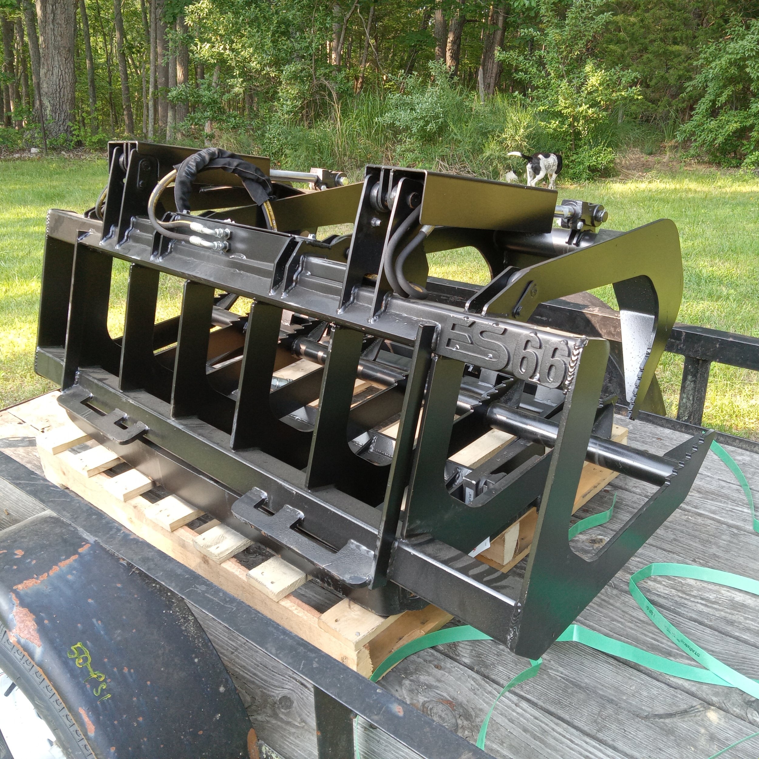

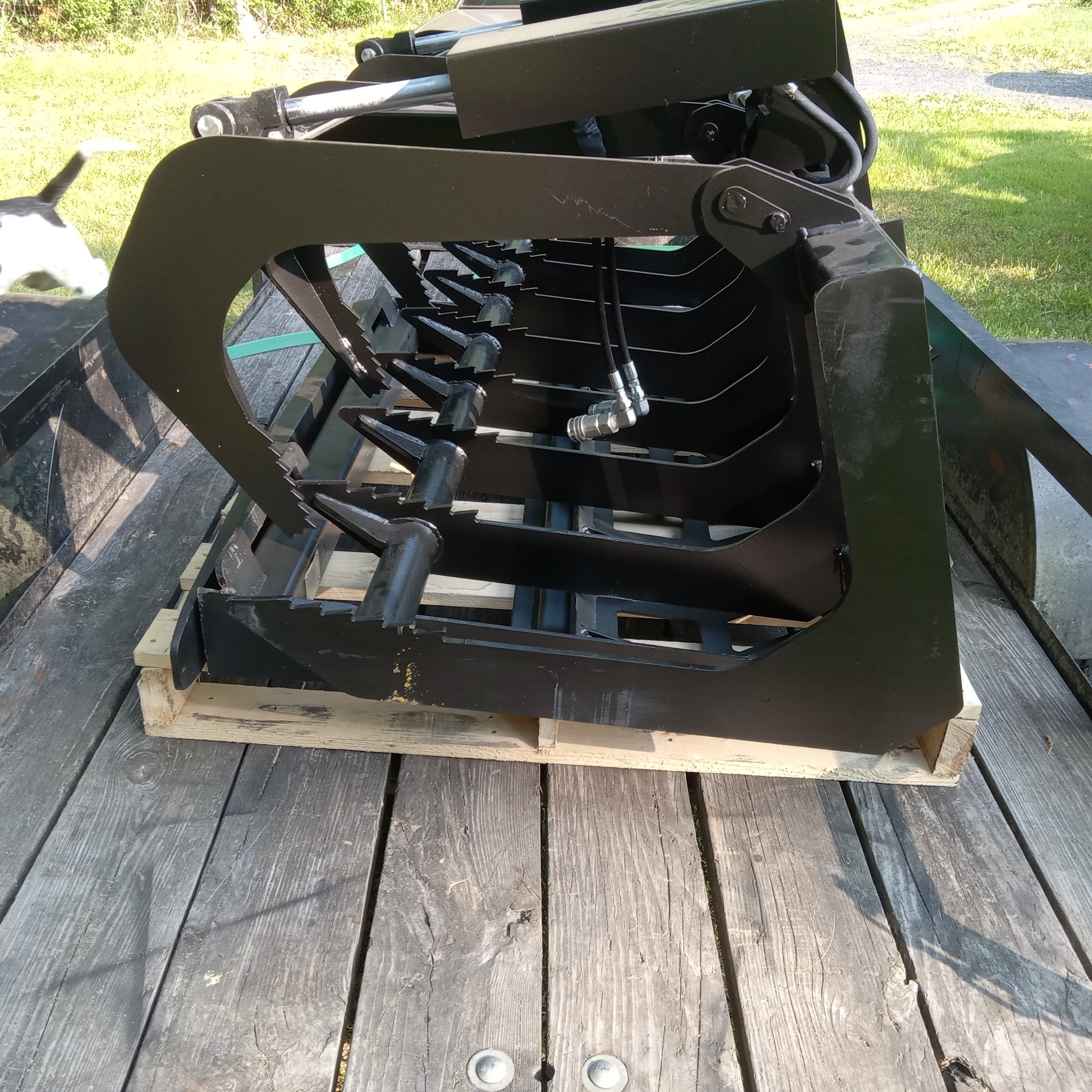

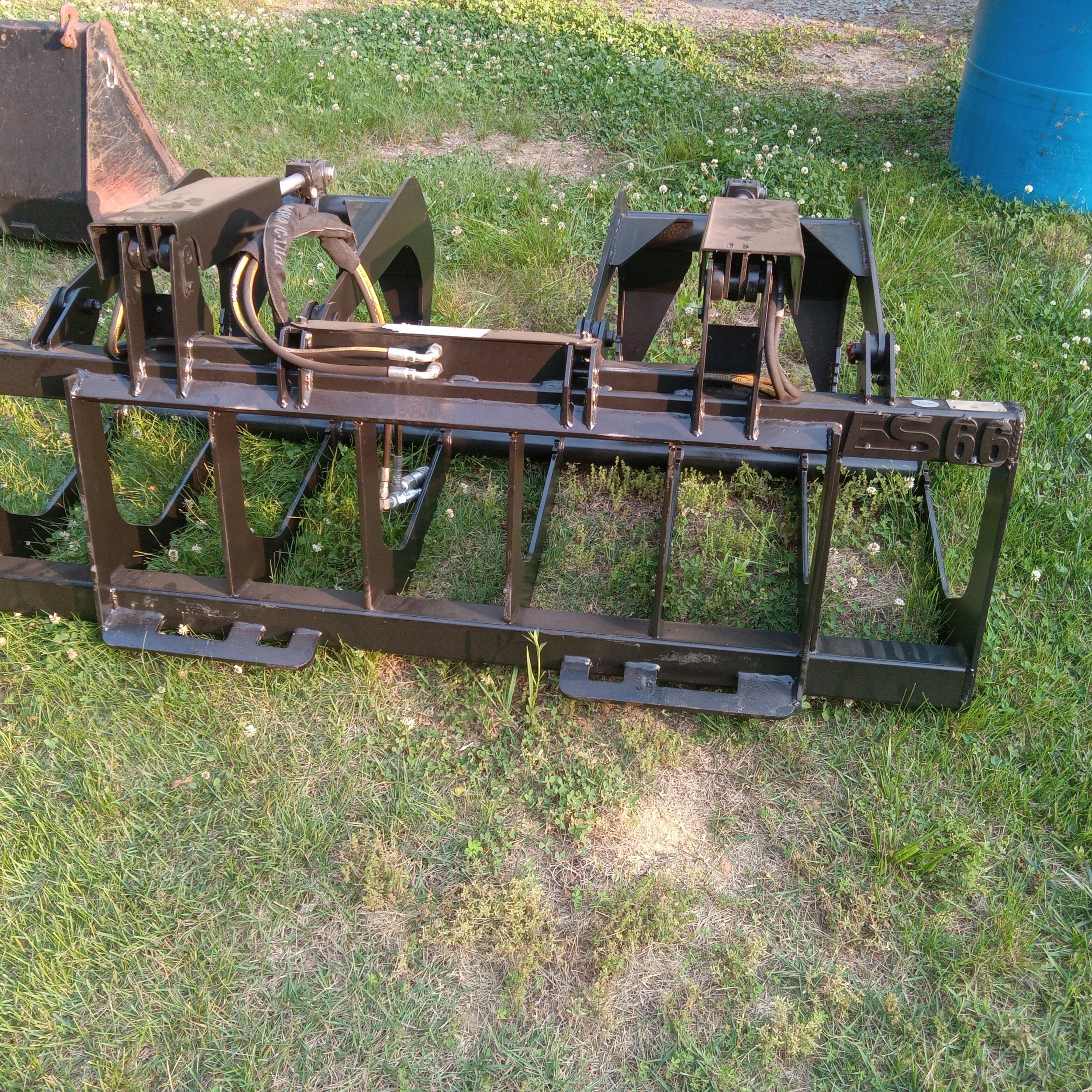

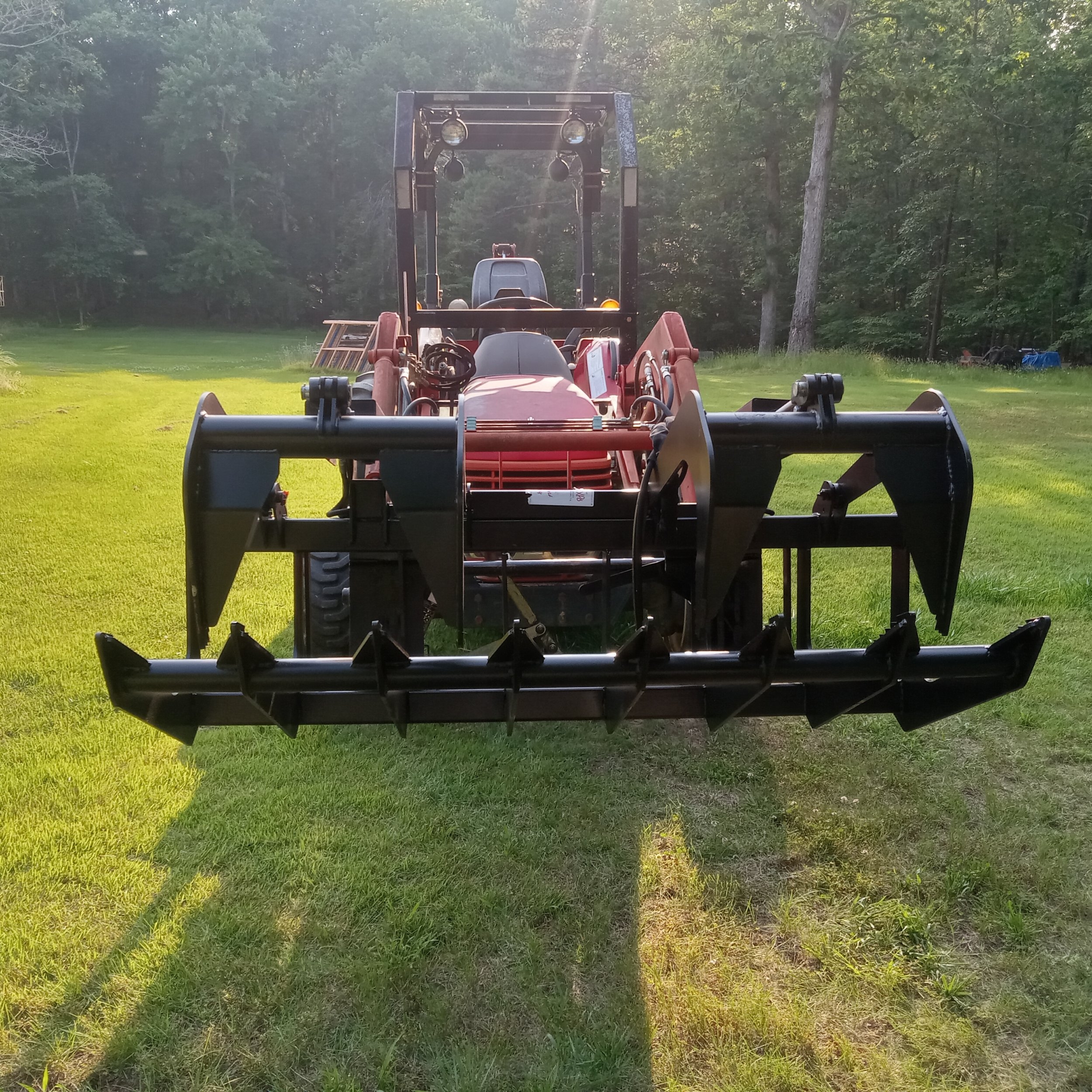

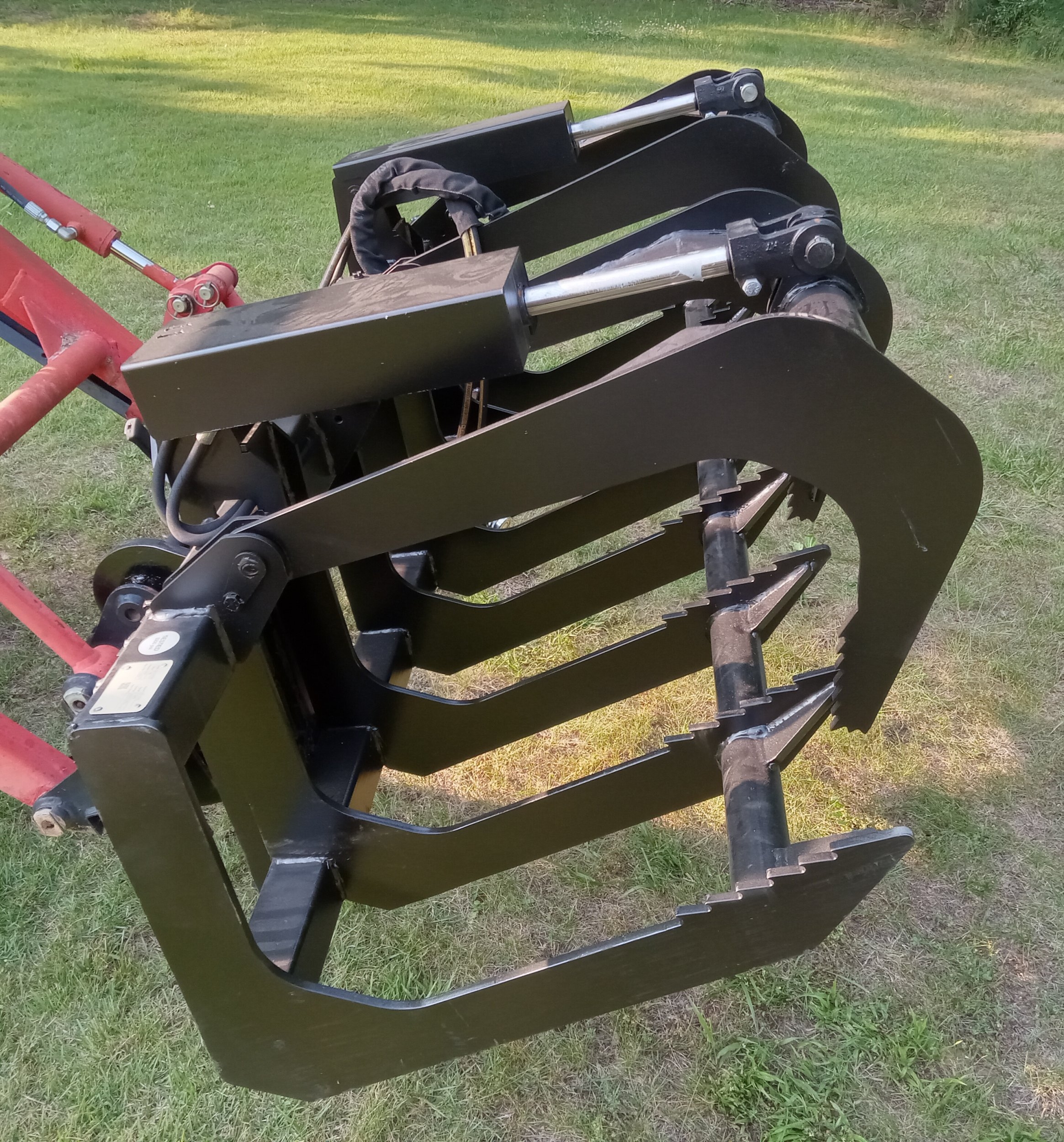

I adjusted two lower fittings on my grapple cylinders. This brand has a heavy steel guard to protect the cylinders and hoses, but the lower 90 of each cyl. Was not parallel to the cylinder and gave the appearance the hose was malformed when the clamps were open. When the hose was loosend and repositioned it helped but the fittings had to align. This condition could not be good over time. I did not take a photo. The one side required almost one full turn, but the other side only a quarter. Now the hoses lay gracefully under the guards in any position.
Did some grappling today (Saturday) and I found these photos and you can see the lower hose/fittings of the cylinder arent quite positioned properly. When the clamps are opened it really disfigured both hoses. Anyway, i got them adjusted properly now.
   / What have you done to your Branson today? #1,440
Zork, I have almost the same grapple as yours. What I dont like is that it does not open up enough to grab a big brush pile.
Its great on logs and rocks, but the top arms hang to low. I wish I would of bought a different one, so it sits in the shop on a pallet collecting dust...
Nice tractor you have there!
