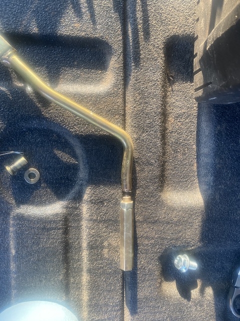

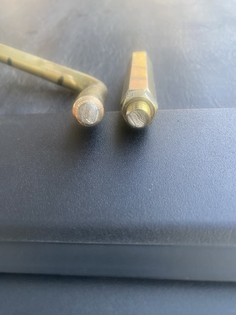

Well the mystery of the clutch adjustment is over. Good news is I no longer suspect anything loose.
The adjustment rod was stretching and finally broke. Wonder how much the linkage will cost. :ROFLMAO:
   / What have you done to your Branson today? #1,480
Ha! That will do it. At least it wasn't something loose between the engine and the transmission!
