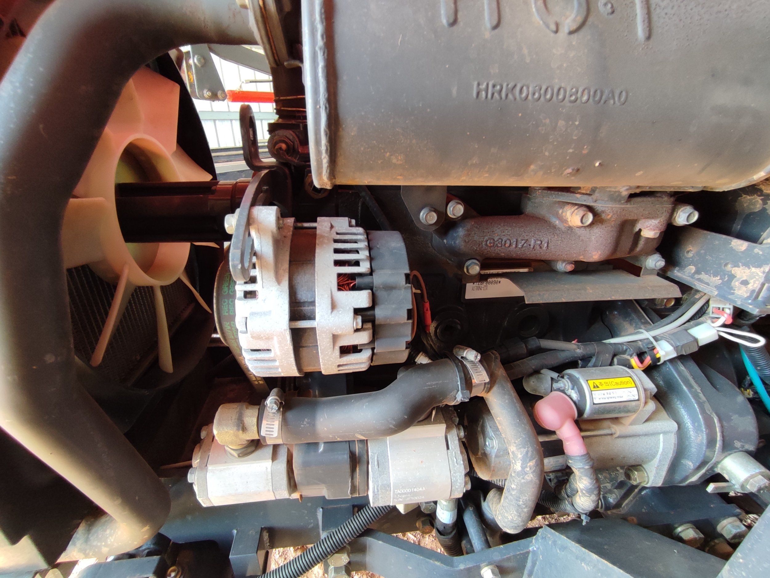

Does anyone else see a red wire with a female connector coming out of the rear of the alternator? Mine has that wire and it's not connected. What is it for?
   / What have you done to your Branson today? #1,492
The single wire that comes in the back of the alternator? Like this one on my picture?
On my tractor, that provides signal for the tachometer for RPM and for the hour meter, so it knows the engine is running and starts counting hours.
I don't know if that changed on the 2020+ models where they changed how the DPF is integrated in the tractor. I've seen more people asking about it because they found it disconnected as well.

Thanks! Sounds like I don't need to worry about it then.
   / What have you done to your Branson today? #1,494
Don't worry about them this was indeed changed when they changed the dpf system, every 15 & 20 series unit on our lot is setup like this, ptsg is correct in that they used to use this for rpm's and hours, they dont any more.
