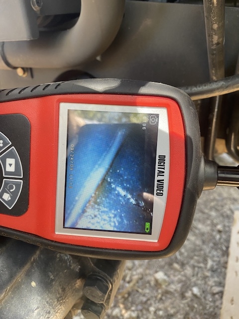

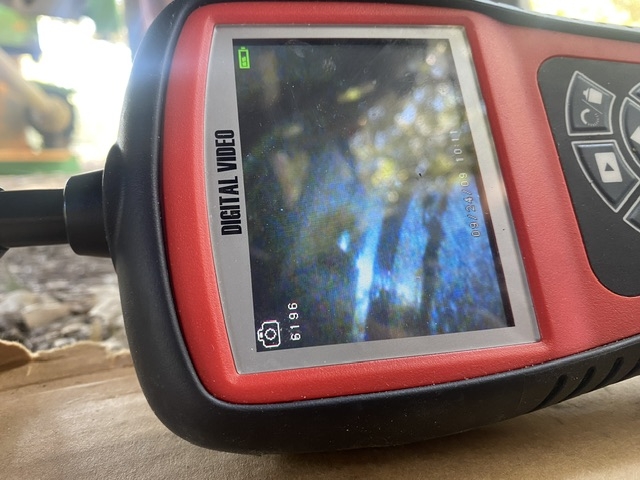

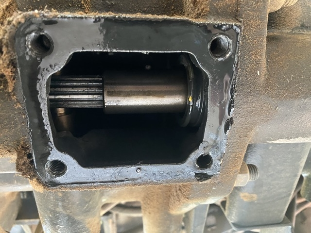

I removed the inspection plate and had a look around. Best I can tell it is the rear main seal. I also removed the starter and went between the flywheel and back of the motor with my camera but could not tell much as I was seeing more of the top side of the crankshaft. But I did go to the bottom of the bell housing and see some evidence of the leak.
Called dealer and they said is should be covered
Called dealer and they said is should be covered under the power train warranty. Hope they are correct. I will take it to them next Saturday.
Pic of the plate after I loosened the bolts.
Pic of oil on top of plate.
Pic of the inside.
Pic of the bottom of the throw out bearing.
Pic of the bottom of the bell housing behind the flywheel.
Pic of the inside.
Pic of the bottom of the bell housing behind the It's obvious by the dust accumulation that you have a leak.
It's obvious by the accumulated dust that you have a leak.
Details, details..., did you drain it before removing the plate? That small omission could change this whole story.

There is nothing to drain to remove the plate. That is the bell housing between the engine and transmission. There should not be any fluid in there.
The dust is from doing the road work with my brother at his deer lease. It is terribly dry here and that was very dusty job. My brother has an open station JD and he had more dust than that all over him. :ROFLMAO:
I don't know what I was thinking, lol. Correct, oil is bad in the clutch assembly. Take it in as soon as you can, because you want to avoid any games that might happen due to the delayed time.
