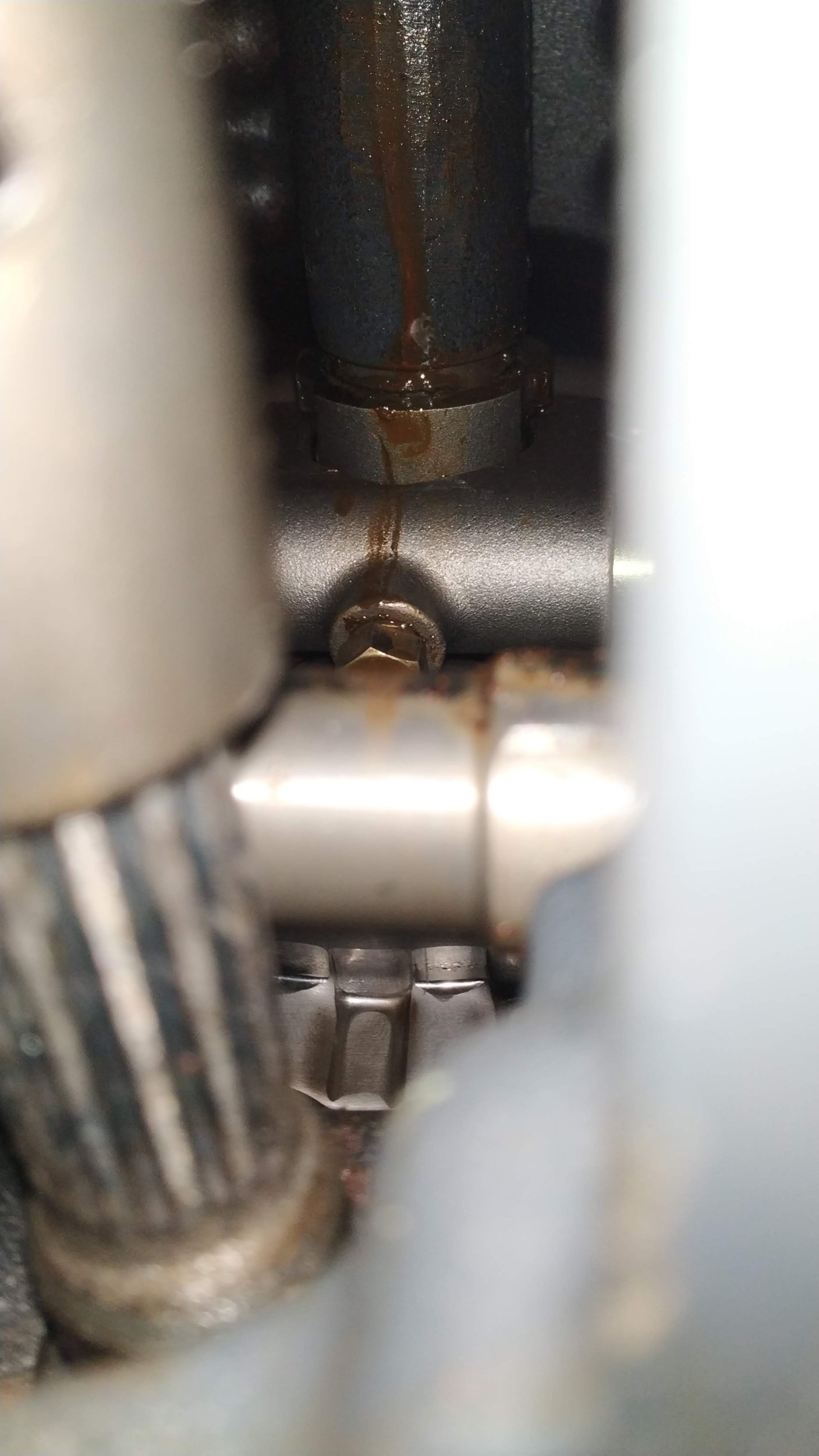

Well I pulled the plate on mine at around 150 hours, I noticed a drip coming from the transmission input shaft. It's not constant a drip, definitely not enough to come out the weep hole. It actually lands on the coupler for the front axle prop shaft and ends up lubricating it.
At the time I suspected it came from working up and down on some very steep hills I was working at the time. Never really stuck to it because I believe there is two seals that seals the outer input shaft and the inner input shaft for the PTO.
Hard to get the context of the picture, but you can see the trail coming down just behind the fork for the clutch release bearing.

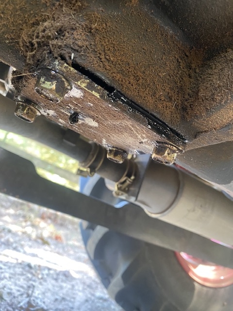

Well unloading the tractor this morning and noticed a small amount of fluid had dripped onto the trailer floor. Crawled under to find the source and it is coming from the weep hole in the bell housing. Very small amount but it looks like motor oil. I will keep an eye on it but believe I have a rear main seal leaking. :cautious: What you want to bet that is not considered a part of the 6 year power train warranty?
At 132 hours a rear main should not leak.

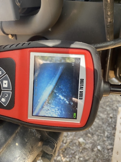

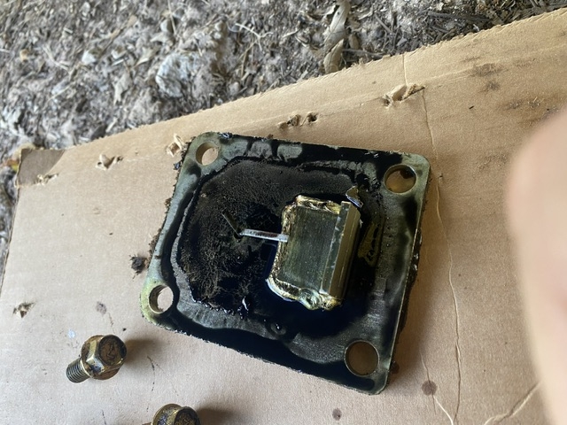

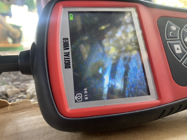

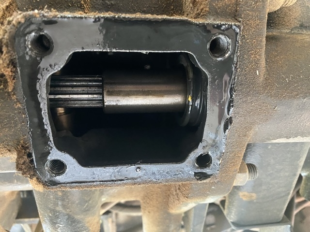

I removed the inspection plate and had a look around. Best I can tell it is the rear main seal. I also removed the starter and went between the flywheel and back of the motor with my camera but could not tell much as I was seeing more of the top side of the crankshaft. But I did go to the bottom of the bell housing and see some evidence of the leak.
Called dealer and they said is should be covered under the power train warranty. Hope they are correct. I will take it to them next Saturday.
Pic of the plate after I loosened the bolts.
Pic of oil on top of plate.
Pic of the inside.

Pic of the bottom of the bell housing behind the flywheel.
