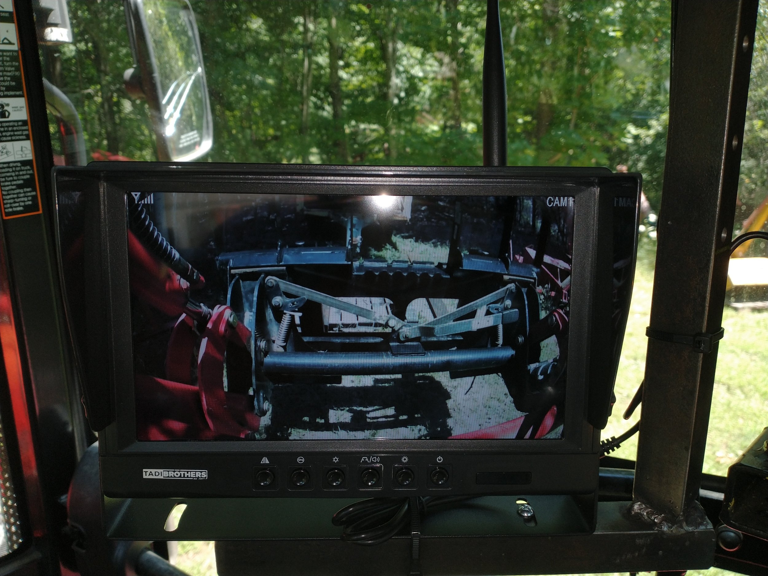

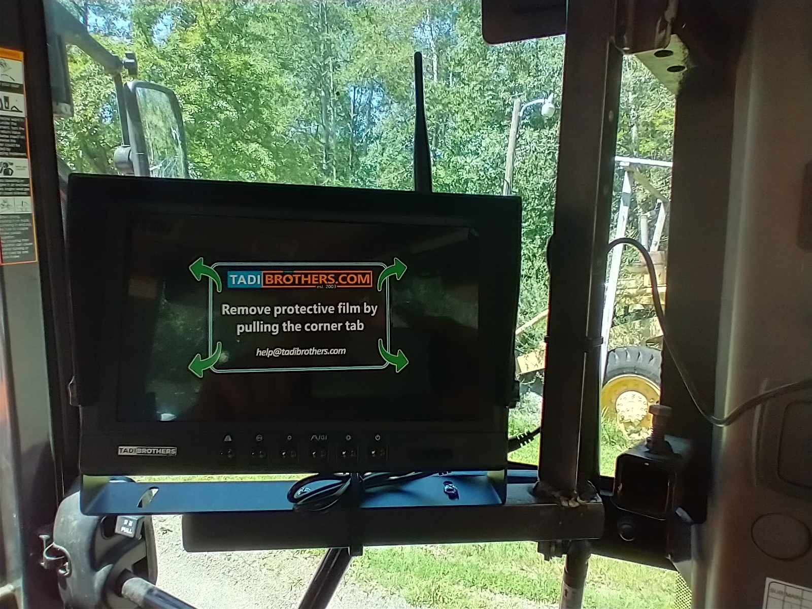

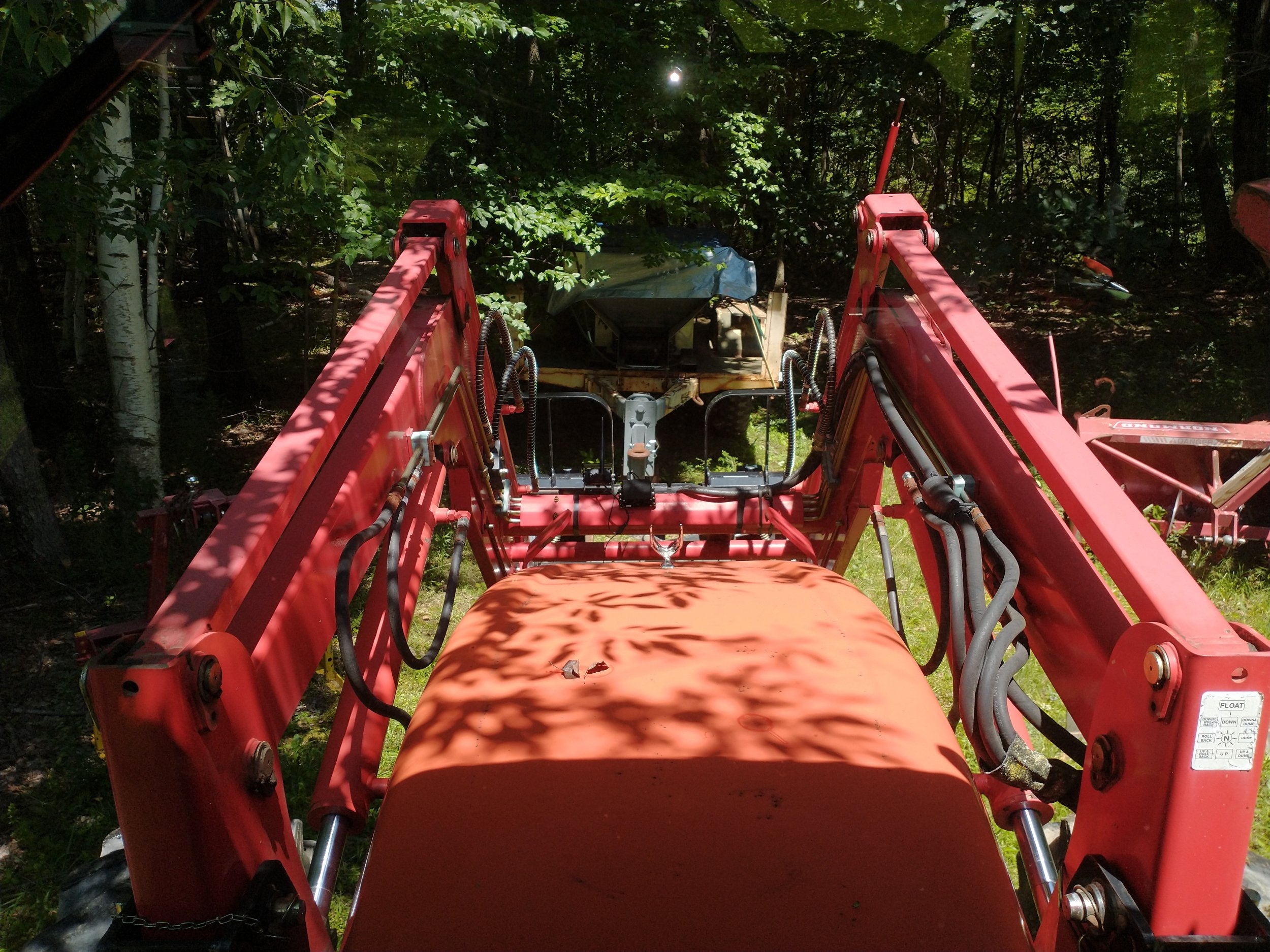

Well did a little project today that I've been wanting to do for several years and just hadn't bothered to do.
I bought a monitor and a couple of wireless cameras and a rechargeable battery pack, it came in a week 10 days ago, today the temperature was much nicer so I went and mounted it. I already see one problem with it, think I'll have to buy a nother monitor or two and another camera battery.
Monitor and bracket, (this took the longest to do)
First use was to attach my forks,
my view from the cab,
the cameras view, nicer even though a bit strange,

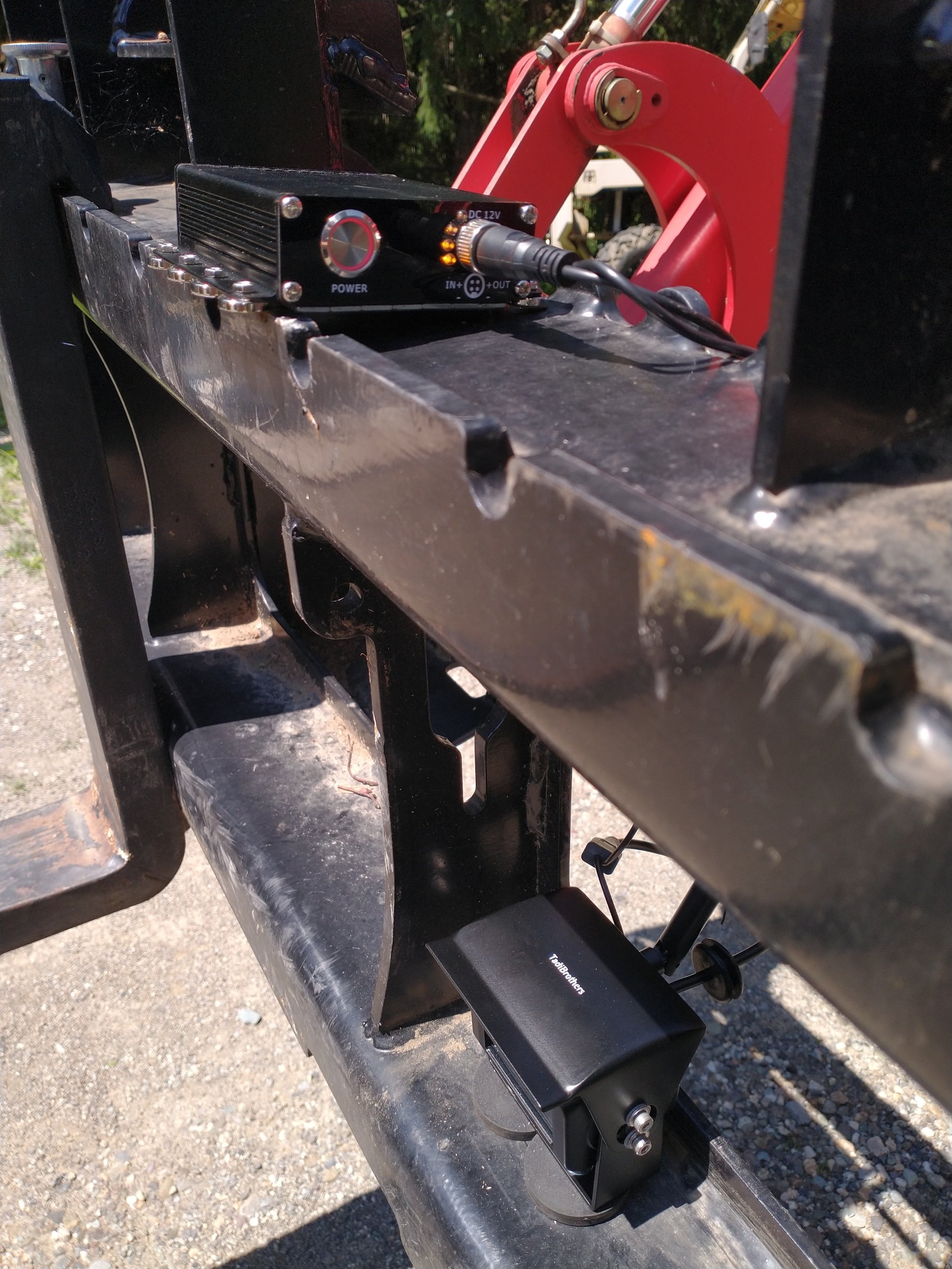

the magnetic camera battery and the magnet mounted camera on the forks,

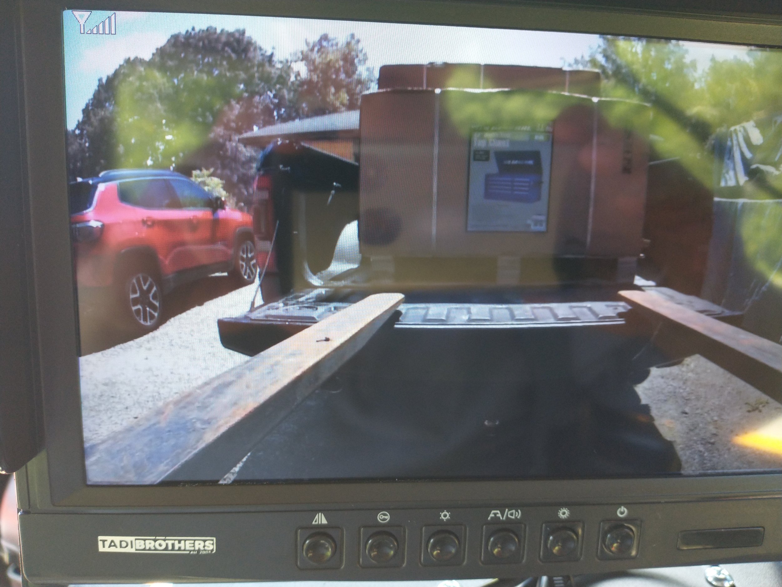

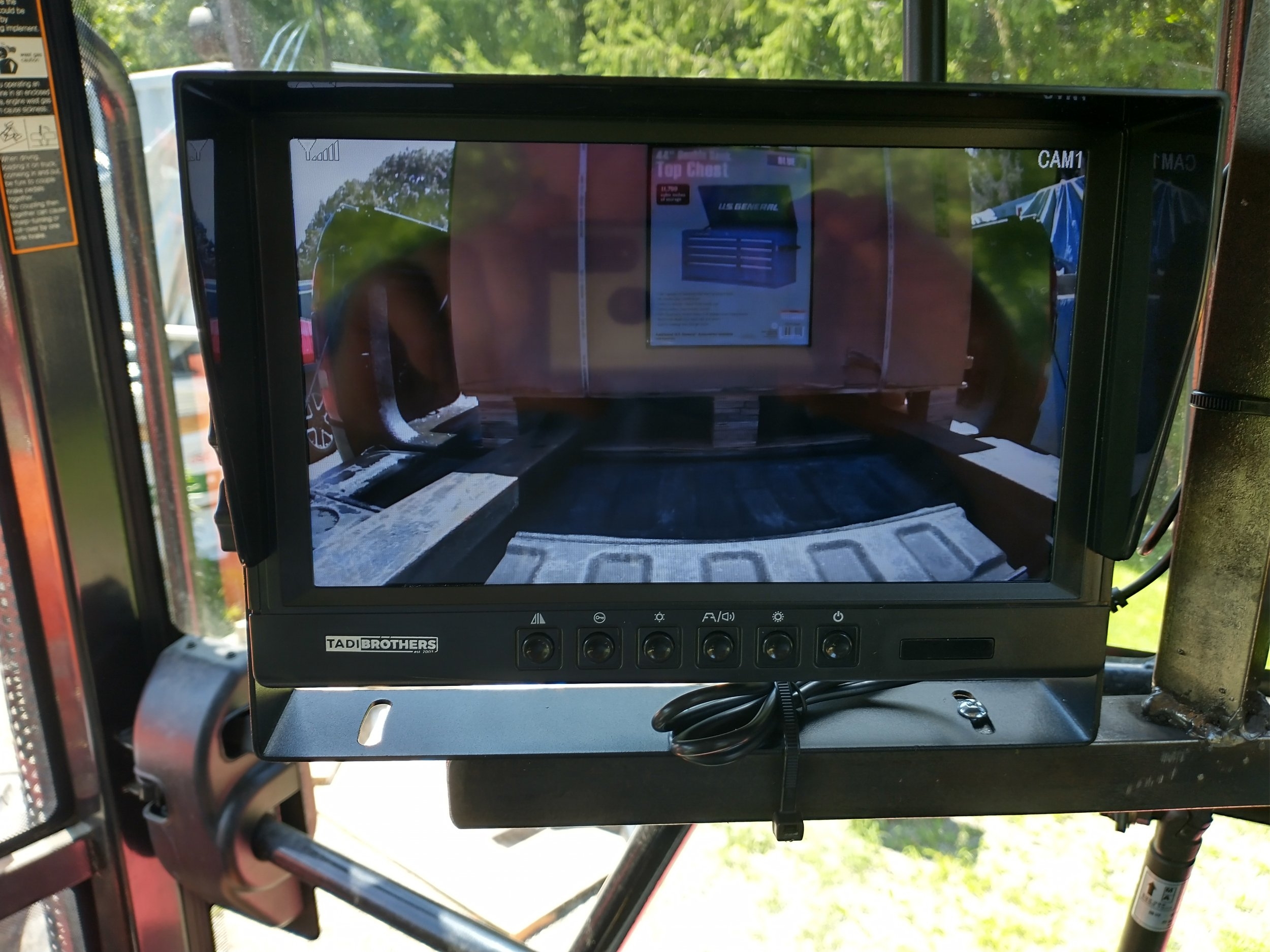

Heading into the pickup box for the first box of yesterdays spending,
Watching the forks just clearing the box and pallet,

Nice Lou! I have been thinking about something similar. I was afraid I would not be able to see the screen well with the sun. Any issues with glare?
   / What have you done to your Branson today? #1,374
Not so far the monitor has somewhat of a built in shade.

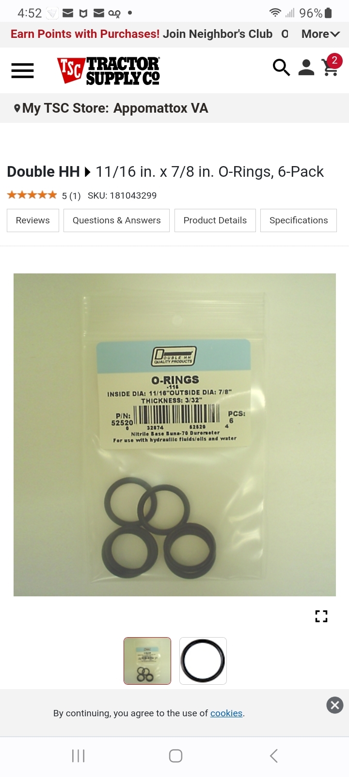

Replaced the orings in the loader hydraulic quick connects. The connectors are Parker 6600's and this pack for $3.99 from TSC worked.
