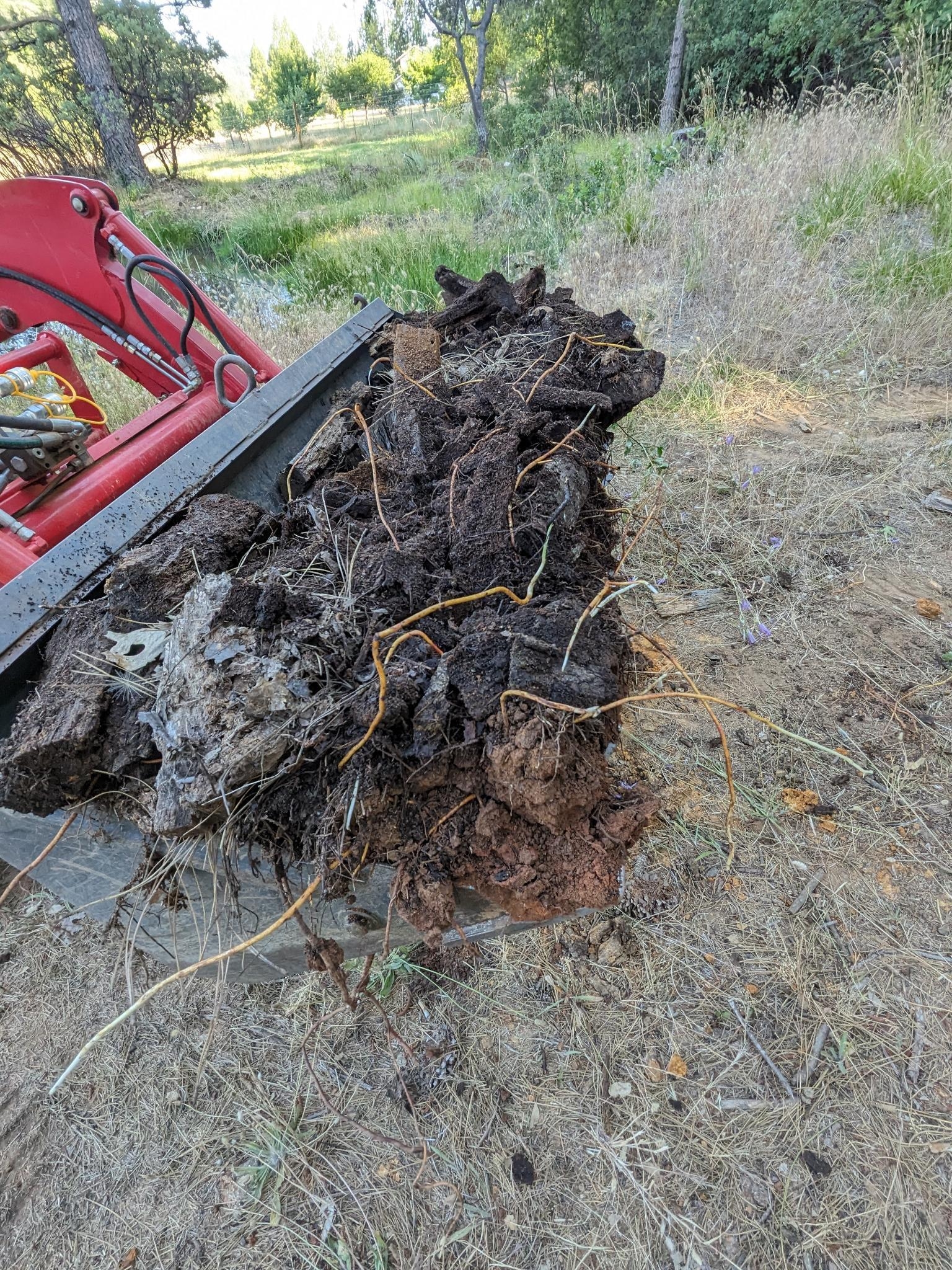

It's pretty decent stuff if you don't dig too deeply and get the red clay (though going in the bottom of a box it's not a big deal):
though it's strongly advise to pull all the poison oak roots out of it before putting it in your wife's garden 😂

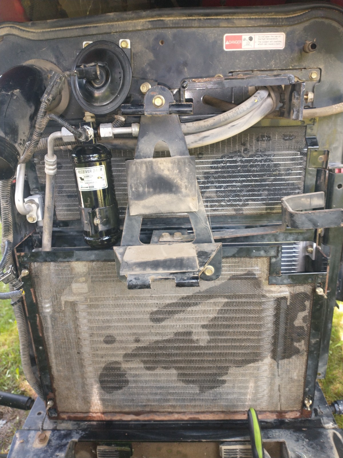

Well the AC in my Branson 8050 was rocking and rolling this afternoon when I shut her down.
Had 45F air coming out of the AC vents with an 85F ambient temp and sitting in the sun running at 1600 rpm.

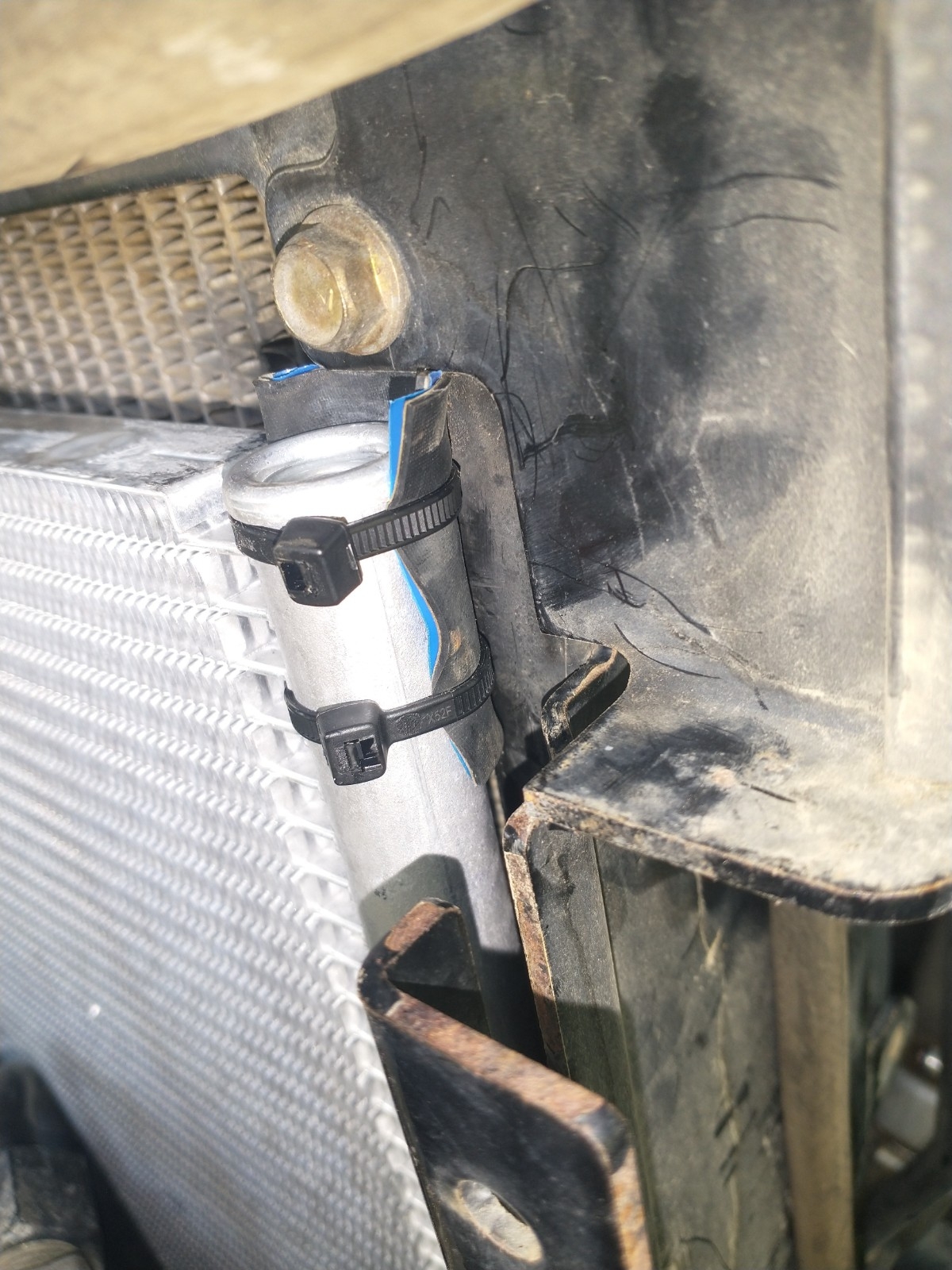

Setting in place with my fancy tube protector, put one on both upper corners,

lines all hooked and receiver/dryer in,

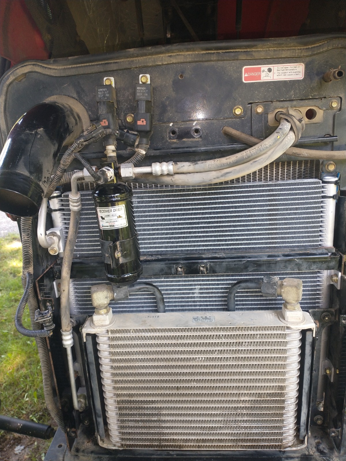

Almost done, horn and air cleaner bracket mounted AC pressure switch and horn wires connected, and screens installed,

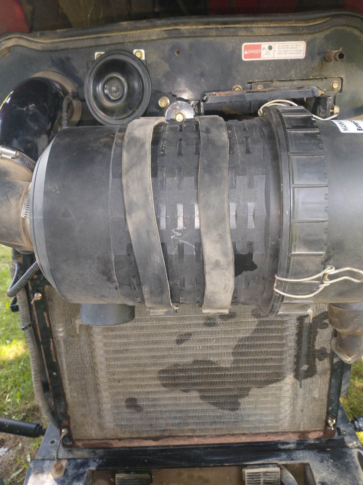

Air cleaner mounted and filter switch hooked up, just got the battery left to put back in,

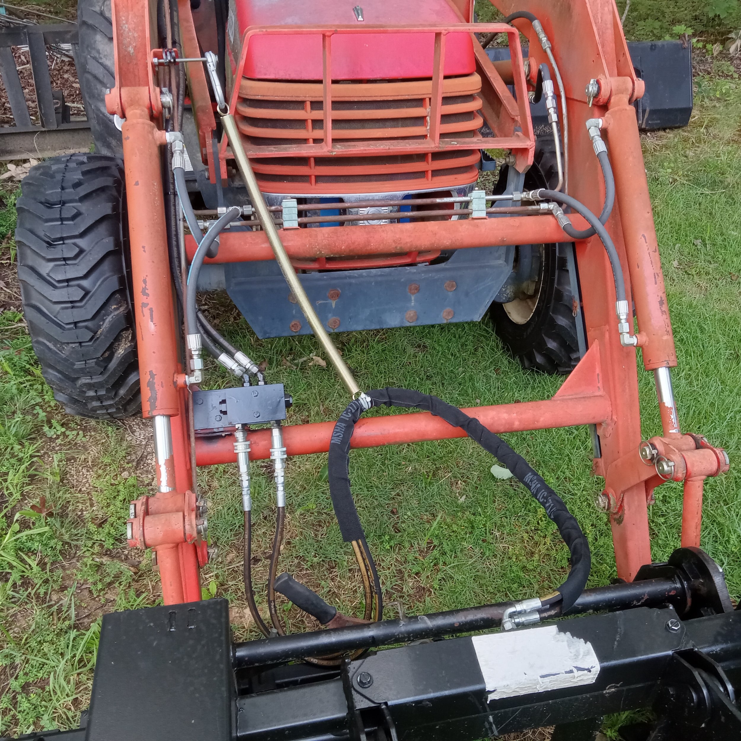

Installed a hydraulic top link yesterday. Got the tires, power beyond spool, and front remote, grapple installed a few weeks ago. I need some different fittings to use my QA my loader hoses at the spool and the top link hose. The placement of the second spool worked so nice, I'm thinking of upsizing it to 3/4 JIC
