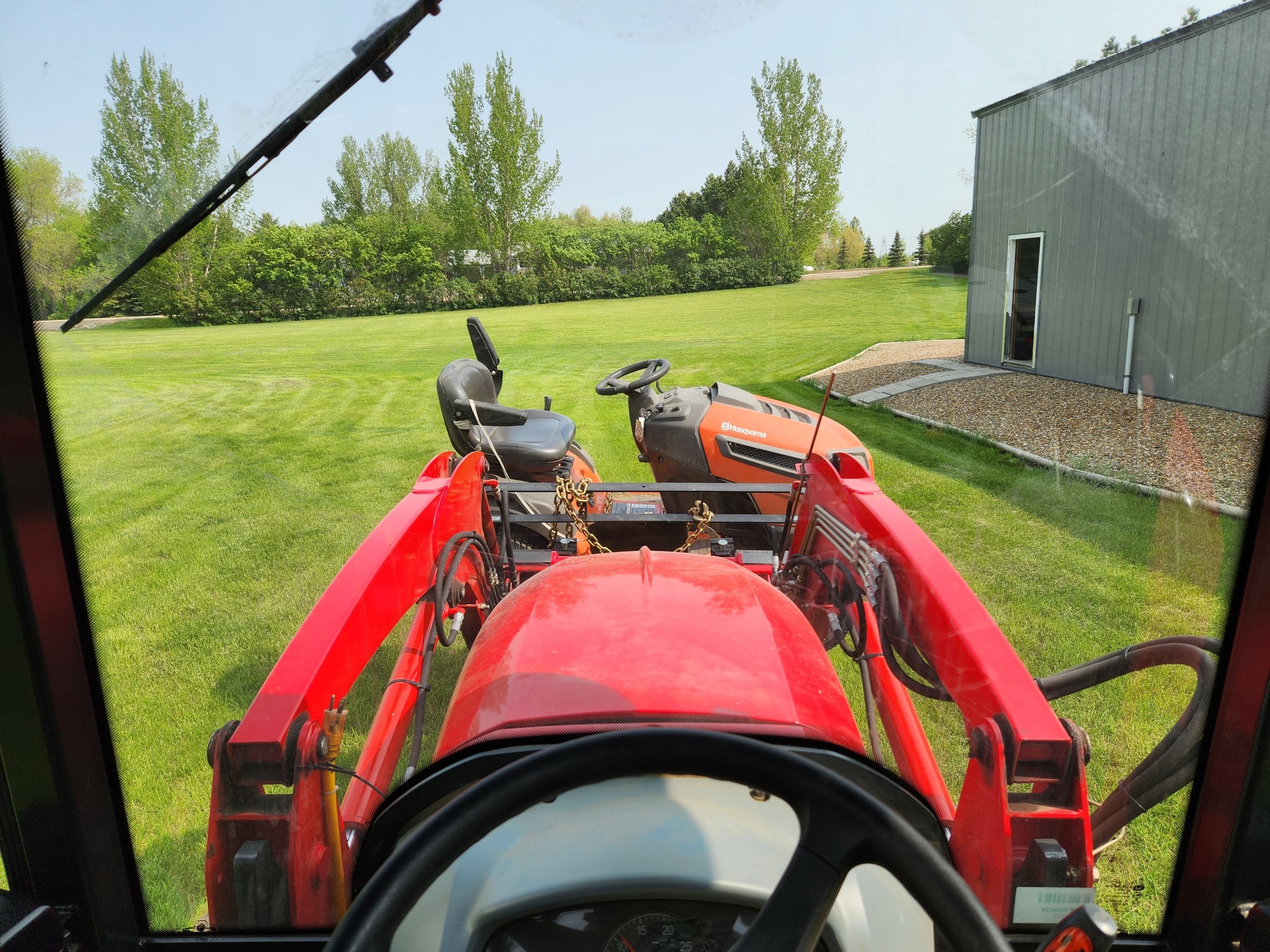

Not much of a task really, but used mine yesterday as a lawnmower "ambulance" when my riding mower died behind the house.
Used it to carry the rider around into the garage to "fix".
Turned out it was just a stuck carb linkage, but had to take the engine cover off to see it.

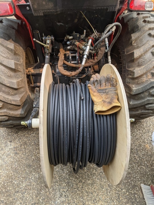

I rigged up spool carrier for the 3ph that I use for a variety of unrolling tasks. Most commonly I spool out single-strand or dual-strand fence wire, though I've also used it for electrical wire (in this case, 500' of 4/0 when I put in a ground mount solar array) -
basically it's a piece of pipe with hitch pins welded to the end, and a couple pieces of PVC pipe as bushings for spacers. I have a smaller version which is basically just a wood dowel with holes in the ends that I use for smaller spools

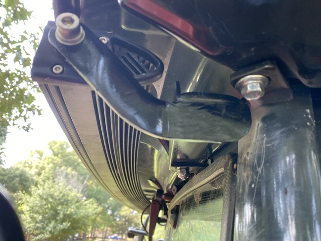

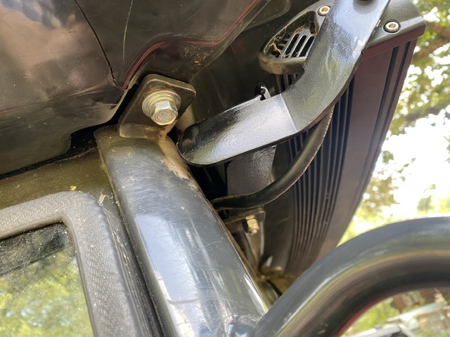

Well I got a quote for a replacement roof and it is just under $2,100. Guess it could be worse but certainly could be better. :ROFLMAO:
I am going for a repair of sorts and redesigning the mounts for the light bar. The more I think about it, that is a bad place to mount because it creates a good amount of leverage on that bolt. I am sure there are other roofs out there that have or will have the same crack if they have the factory light bar.
It will be a few weeks but I will post what I come up with.

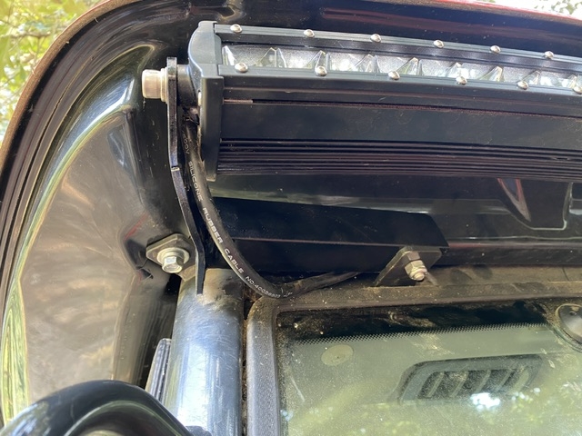

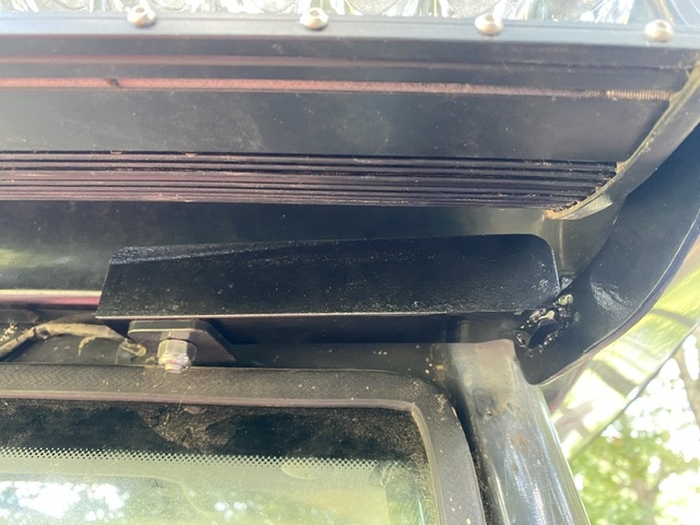

Well I got the mounts redesigned to use the factory light mounts. Just added a some angle iron to the light bar mount and cut the ear off that was mounted to the roof bolt. It is solid and I managed to keep the light location the same. Sure would have been nice if they would have done that in the first place.
Still need to fix the cracks but this should help keep them from spreading while I come up with a good plan.
