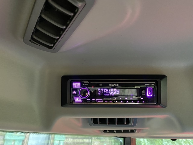

I decided to upgrade the sound system to something a lot better than the useless one that came in the tractor. I had to modify the mount to get the receiver installed. Then I had to modify the old faceplate because the one that came with the new radio did not cover the screws.

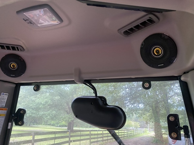

The speakers were no issues other than the covers do not cover the Blind nuts completely but does not look too bad.
I mounted the microphone for the hands free calling in the center by the front window. Used double sided tape so no drilling needed.

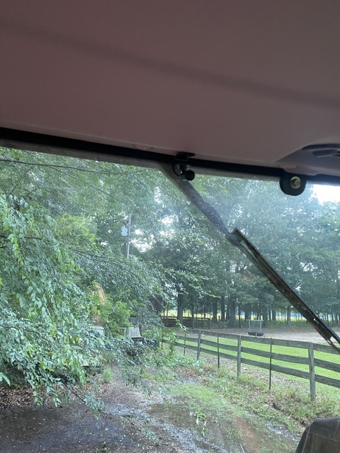

Removing the roof was a lot easier with the way the light bar is mounted now. It can stay bolted up now.
It sounds really good now and the hands free calling works great. Could not use it at all before. The person on the other end could not hear anything but noise. Now they can hear me no problem and can’t hear the tractor running at PTO speed at all.
Kenwood KMM-X705 Stereo
Kicker CSC4 speakers

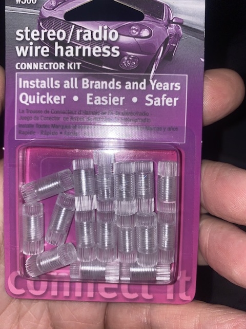

Needless to say I'm in the market for a new radio, am-fm cd will do it, how did you get the new wiring harness plug to fit?
Did you trace the wires or is there an Adapter?
I compared the 2 wiring diagrams and made the connections using twist lock type wire nuts. I like these better than crimping or soldering.
