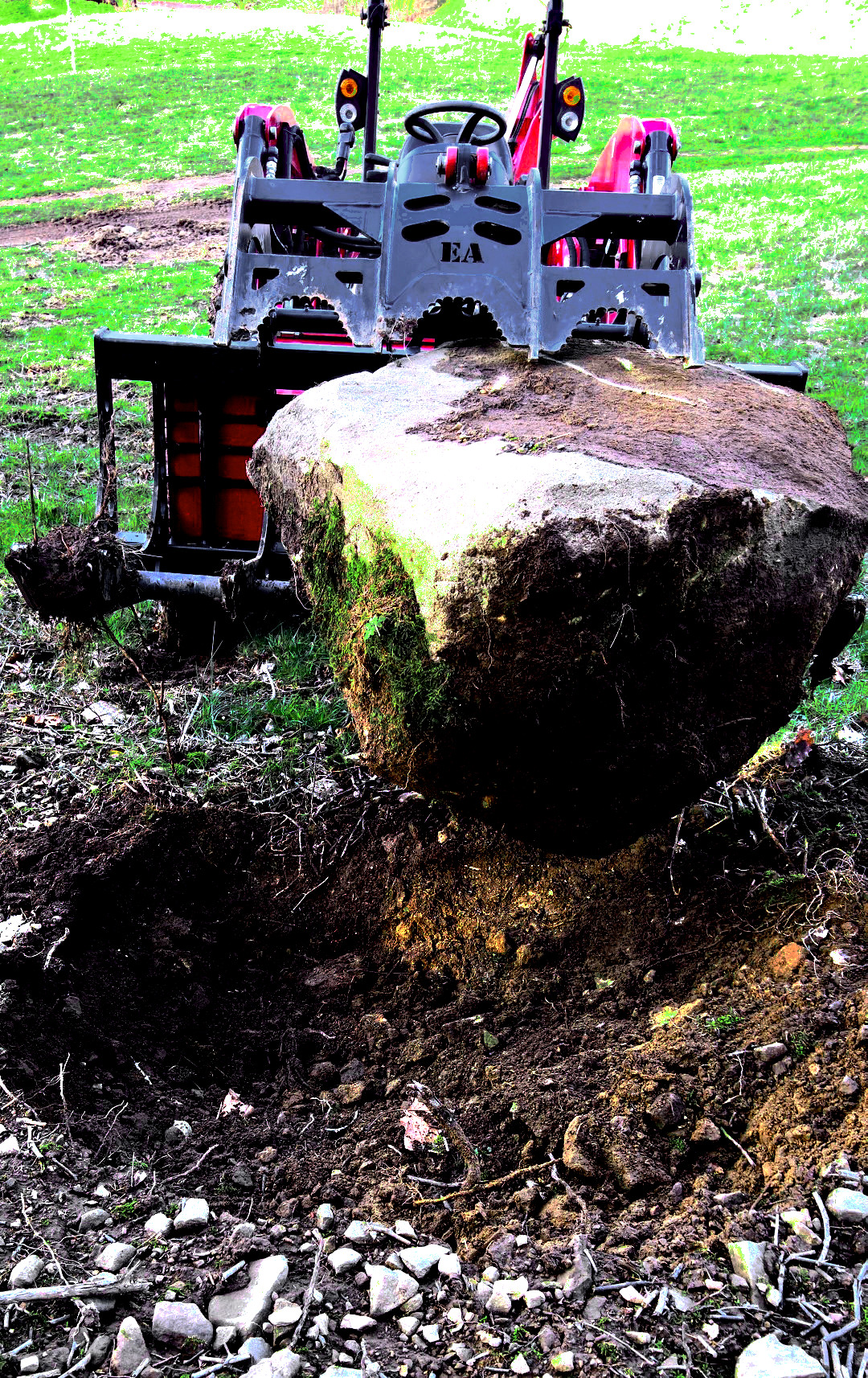

The 50" still holds the crown for most popular model because of the strong, lightweight design, but some do choose to go up to the 54" model to gain opening(37" vs 30") like Mr. Sysop did for his rock eating machine!!

/ What grapple for my tractor? #10
I've seen a couple of my pics cross your facebook page. :)
...and I do make use of the extra opening:
Same rock as before, just picked it up at a better angle for transport.
