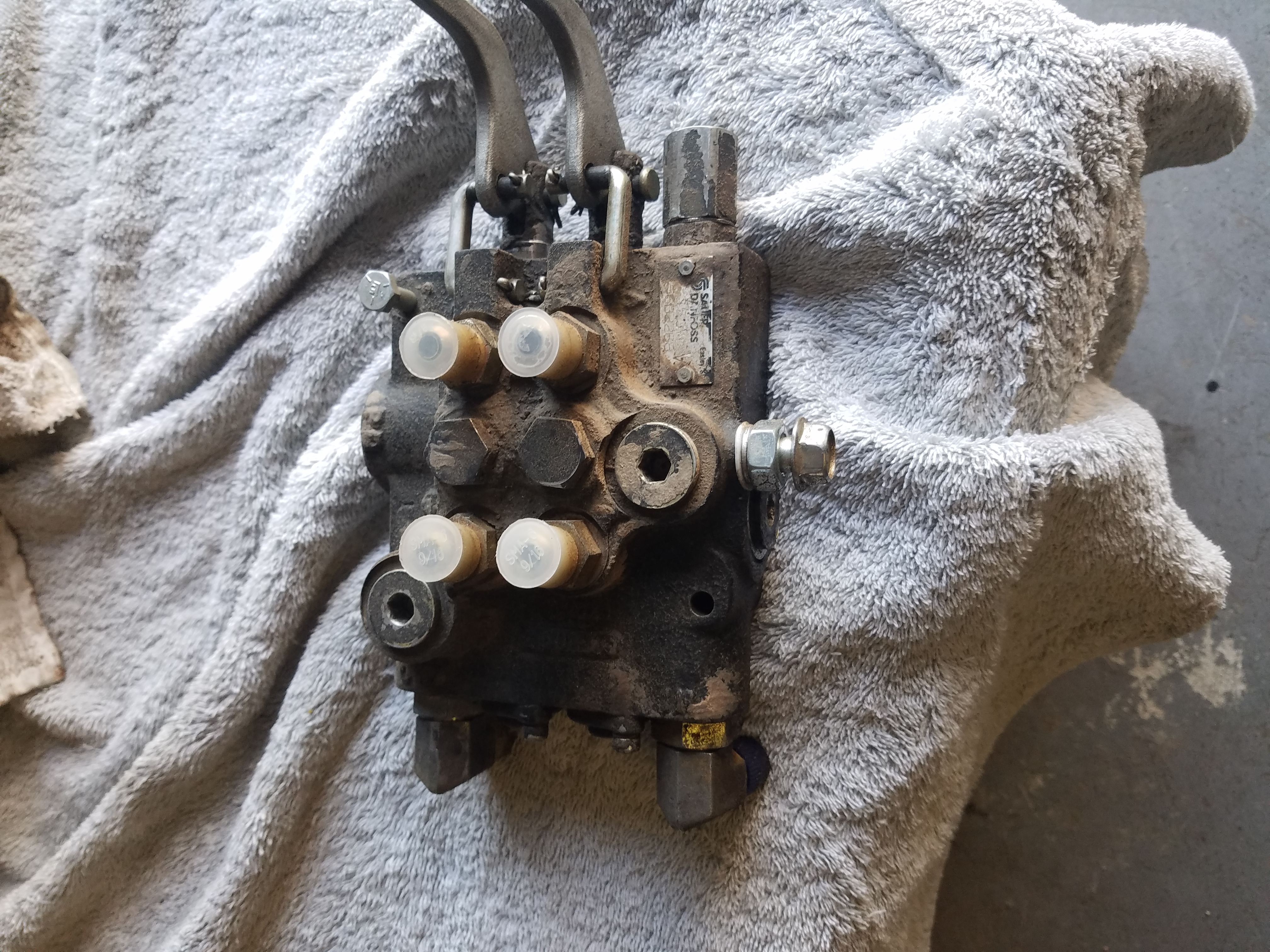

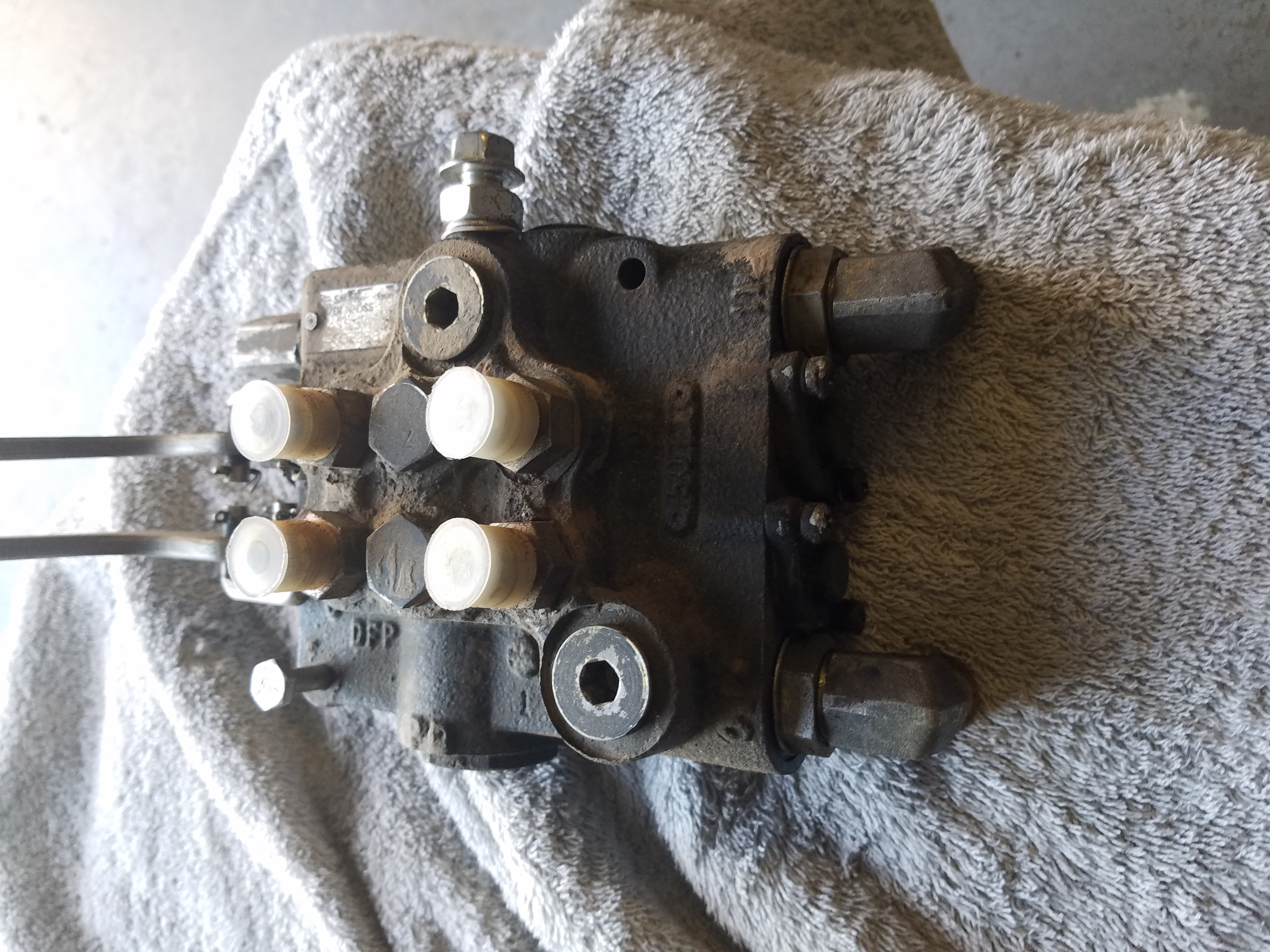

California, Wow that is a cool story. Man you have a wealth of information! I think that tractormaster sticker is the only thing I haven’t touched on this tractor, I have put a lot of work in this tractor, sometimes I wonder if it’s worth it,I do like how it’s turned out though. One good thing about these tractors is they are super simple to work on. The only thing I haven’t touched on this tractor besides that sticker is the transmission. I have freshened up the engine,rings, Rod bearings, head work,redid the front end loader , In the pictures you can see the top pivots don’t know what they’re called. as you can see I have cut them tubes off like 4 inches from the end and then made new ends with bushings in them, I didn’t have any 2x4 tube,so I cut some flat stock took some 1-1/4DOM tube,Machined them for Zerk fittings and some bushings and then on the other pivot points I’ve drilled out and welded in hardened washers. Had to take the three point hitch apart as the control valve was not working right,was able to fix it without spending any money. So this tractor was well used.
