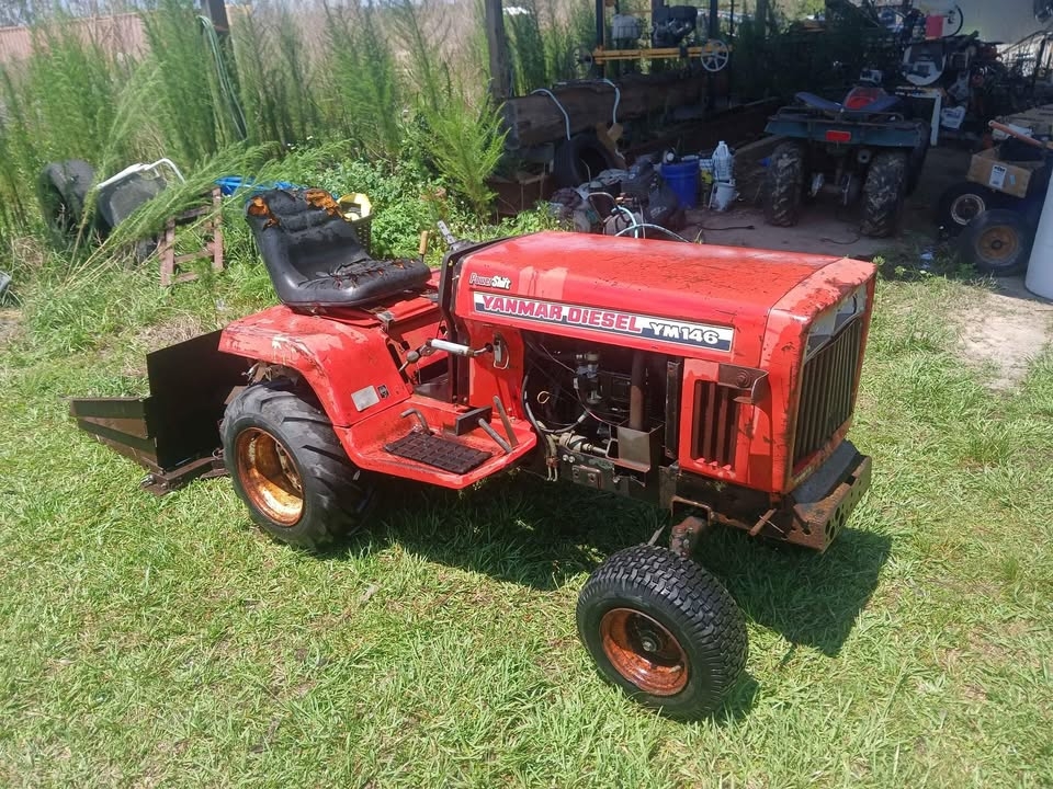

Just wondering if anyone makes a front loader for my Ym 146. Would like for it to be relatively plug and play

The YM146 is based on the YM14 aka GT14 lawn tractor.
The YM126 is based on the YM12 aka GT12 lawn tractor.
Both have the CAT-0 hitch. Both can run the front snowblower.
As for a front end loader (FEL), the frame is not strong enough to handle those loads nor is it capable of adding in a sub-frame for support.
As your machine is a GT frame, not even an SCUT, a Rear End Loader (REL) can be used.

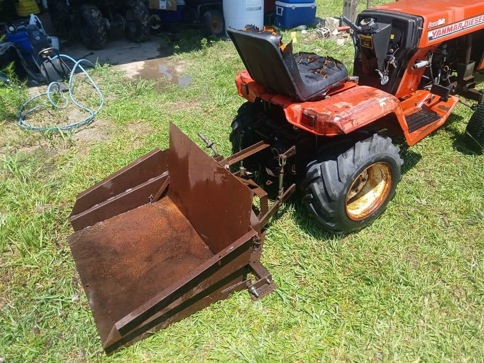

As you can see, a REL works well with a YM146.
You can fabricate your own like the images above or just buy one to mount to a CAT-0 hitch setup.
Prior to 2020 (pre-cootie19 era) the price for the Swisher bucket is PERFECT for your machine. It was $229 USD back then. Very reasonable really.
Home Depot sells this for ATV/UTV for farm use or snow removal.
Its a kit.
And for the YM GT models up into the YM146, it's mounted just like any other GT garden tractor.
And it is universal to mount on the front as well.
Long as there is a from CAT-0 interface.
