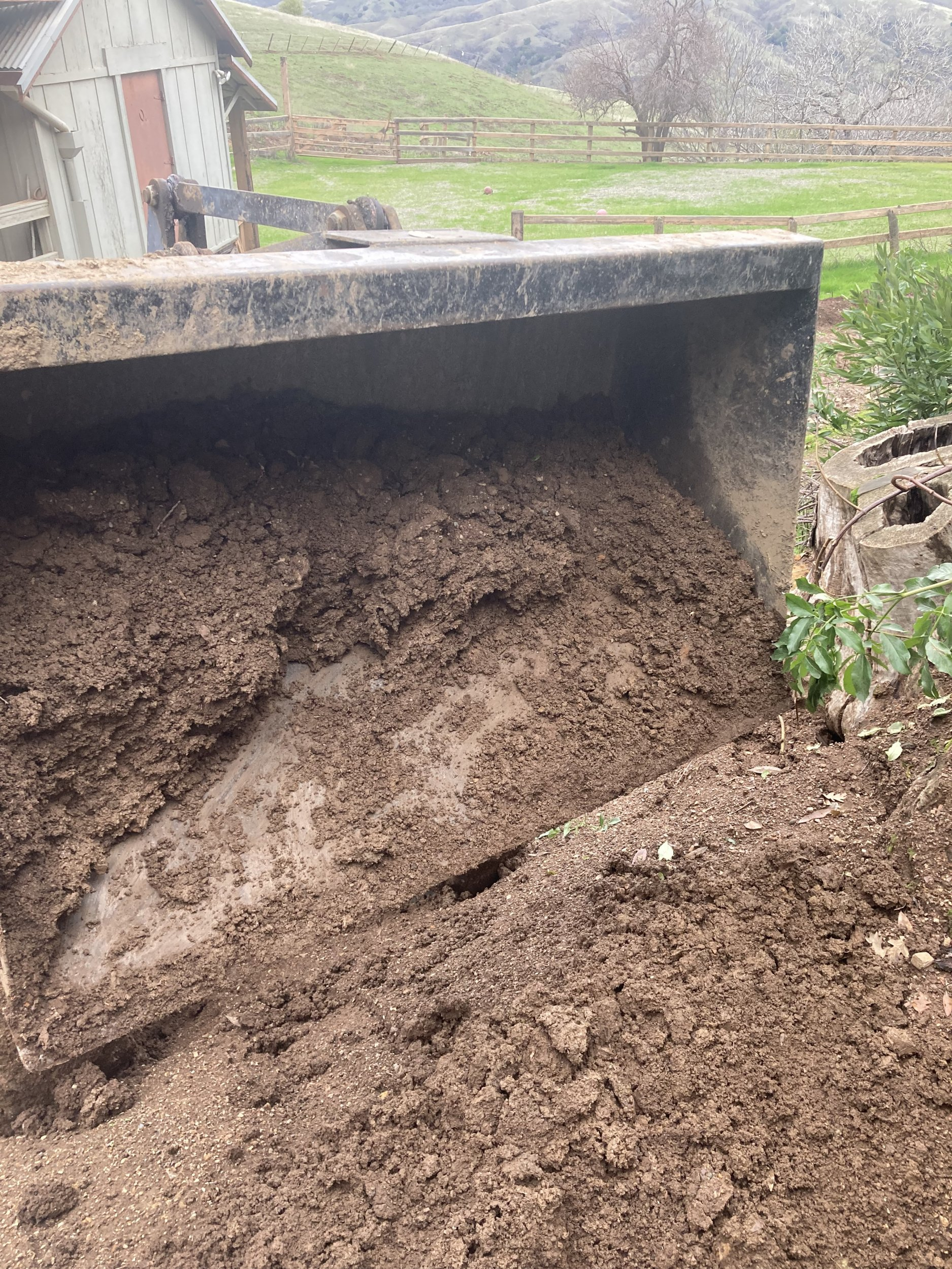

Today I tried to move some clay soil around and then discovered even at full height and curl, it stuck to the bucket. No amount of rattling the hydraulics would dislodge it. I ended up having to shovel it out by hand...:cautious: Did I mention that the soil is absolutely saturated?
On the bright side, with soil being so...cohesive..., I ended up doing some trenching by hand to start a bigger trenching project and found a galvanized pipe line that I didn't know existed that I was very glad that hadn't found with the trencher.(y)(y)

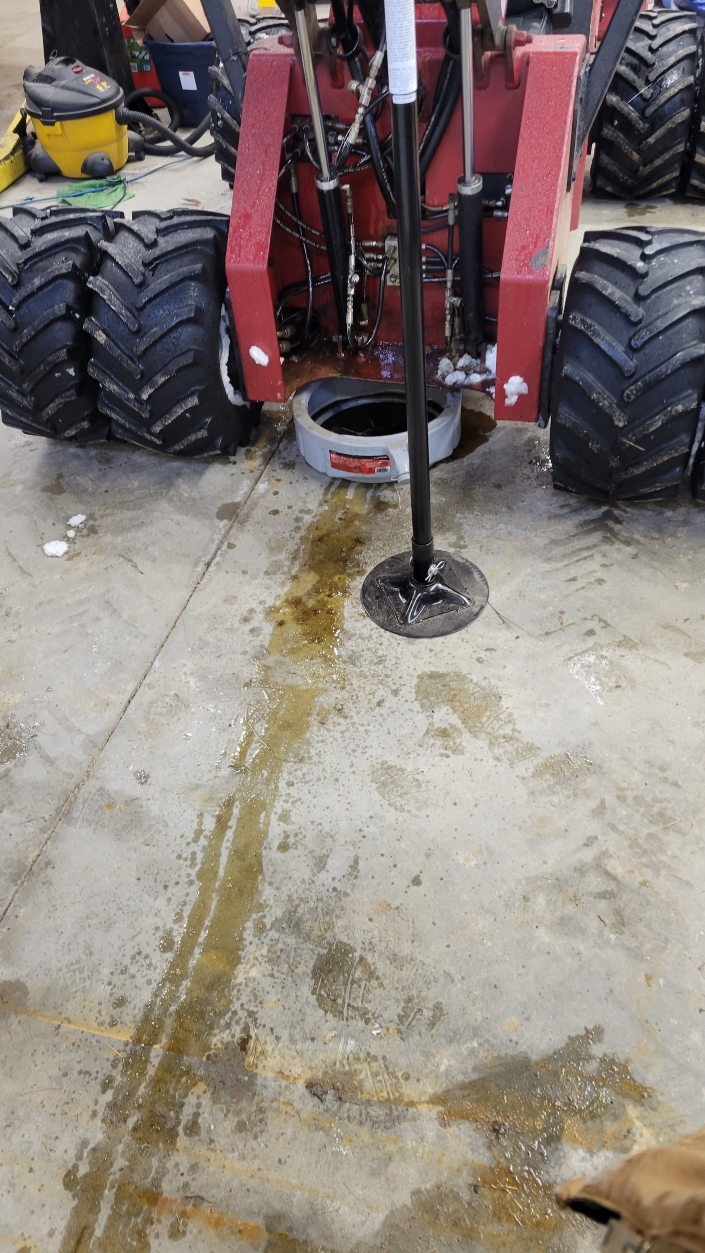

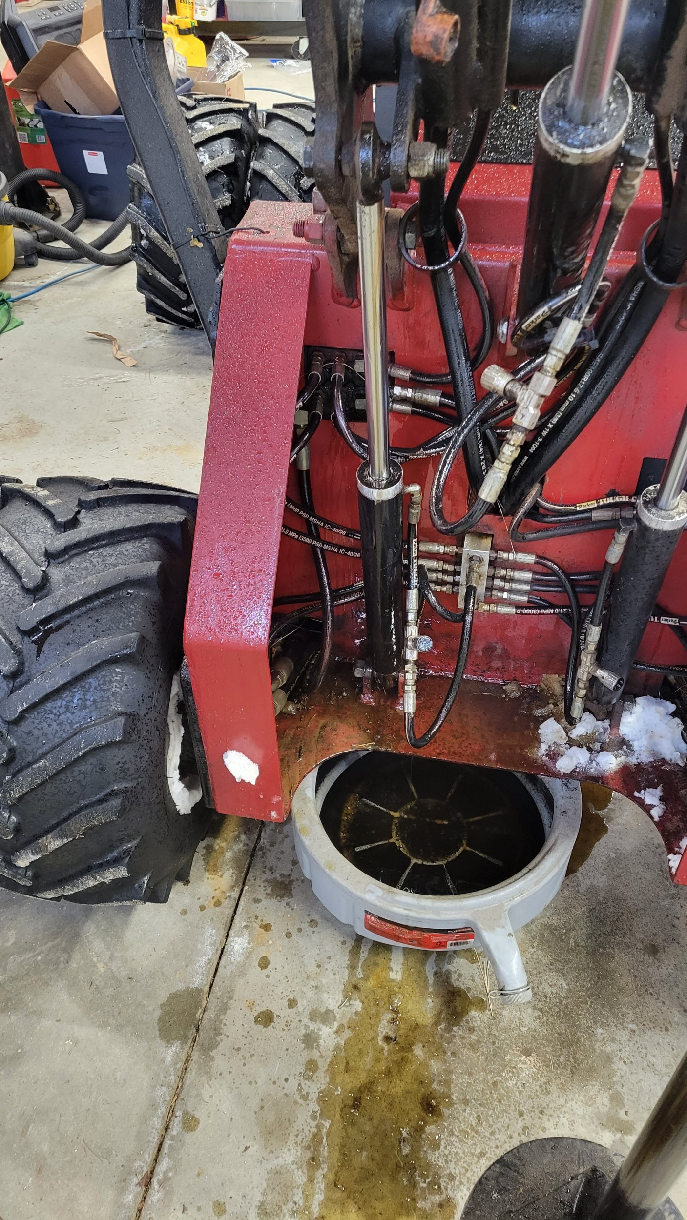

Broke it.
I was pushing snow with the bucket on soft ground. She was revved up pushing a big pile when the cutting edge dug in and the tractor rode up over the bucket. When I went to lift it back up, a large stream of oil was spraying from the wiper area of the right cylinder. It pumped a lot of oil out before I got back to the shop.
Beginning disassembly as soon as I find someone to plow for the storm coming tomorrow....

Bummer x2. I'm surprised that the relief valve didn't bypass first.
All the best, Peter
   / What did you do with your Power Trac today? #286
It was rather violent and I wasn't in FLOAT...
Just called Tazewell and got rebuild kits for all 3 cylinders, just in case I damaged the other ones as well. Keith said he'd ship them today. The piston I know is bad is already removed, I will disassemble when I have replacement parts in-hand.
Having it apart in the shop will give me a little motivation to take care of a few maintenance items and break in my new Milwaukee grease gun!
   / What did you do with your Power Trac today? #287
@AVIVIII Probably unrelated, but I am a little curious; what do you use the valves on your cylinders for? Is there a chance that they could have restricted the flow, making the pressure spike worse that blew the cylinder?
All the best,
Peter
   / What did you do with your Power Trac today? #288
I didn't notice they were valves. Thought they were quick connect on Ts. Good eye.
   / What did you do with your Power Trac today? #289
Those are installed from the factory on any machine that was ordered with a knuckle boom mower (and possibly other attachments). They are needle valves to lock the main hydraulics while that mower is attached. At least that is my understanding; Everything I "know" about the system is from @SpringHollow. I have the knuckle boom mower and aux hydraulic controls, but I am the third owner and it has yet to be fully assembled!
The valves are currently wide open and I don't believe that they would have any effect on it.
   / What did you do with your Power Trac today? #290
Thanks! That makes sense all around.
Good luck on the rebuild. YouTube video or photos would be wonderful, as I am sure it is in my future as well.:)
