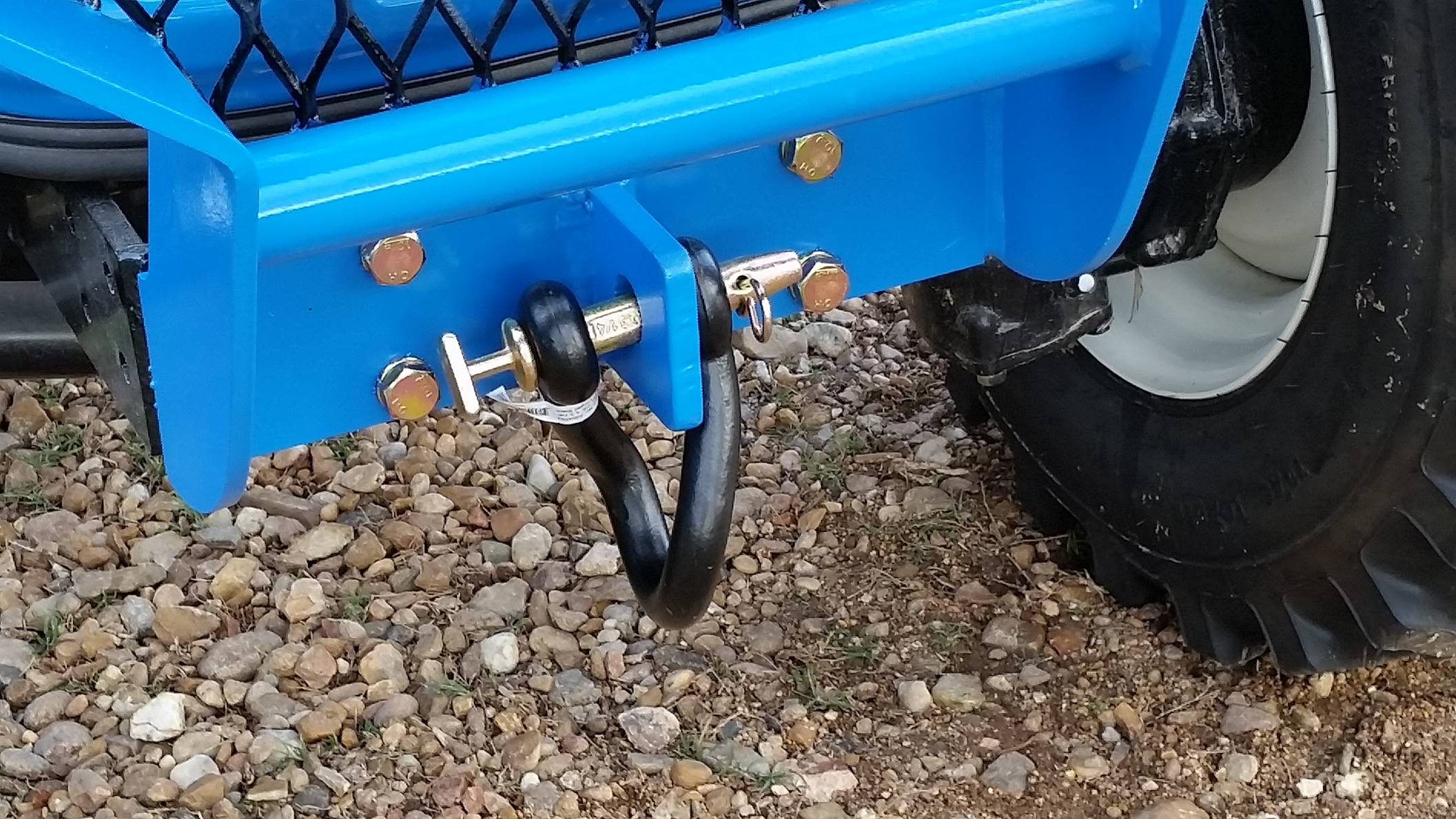

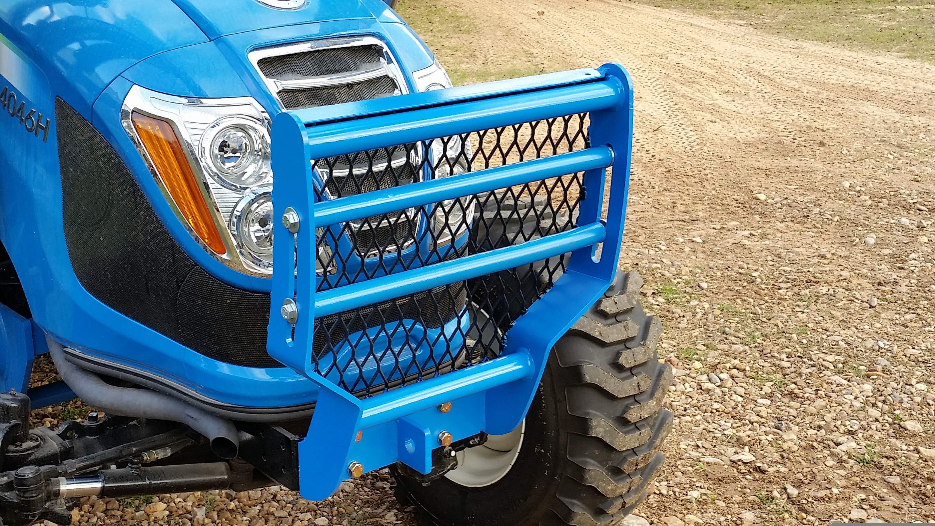

Here's how I upgraded mine. The pad eye is used when hauling it. I hook a big shackle to the pad eye and run the front chain thru it.
That’s pretty close to what I’ve planned for mine- I’ve got the expanded mesh sheet in the shop waiting for me to plasma cut it to shape.
Like the pad eye-think I might add that to the mod.

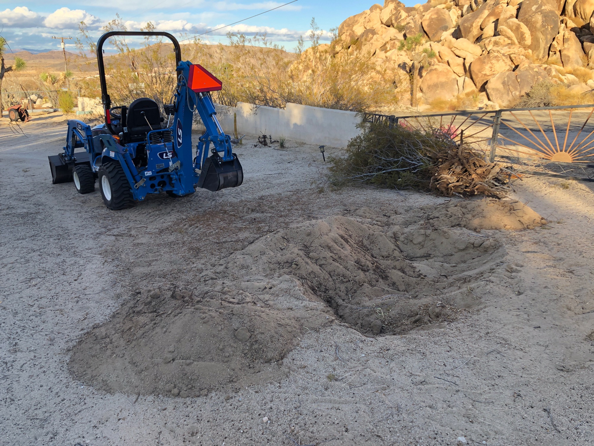

Removed yet another freakishly large creosote bush...

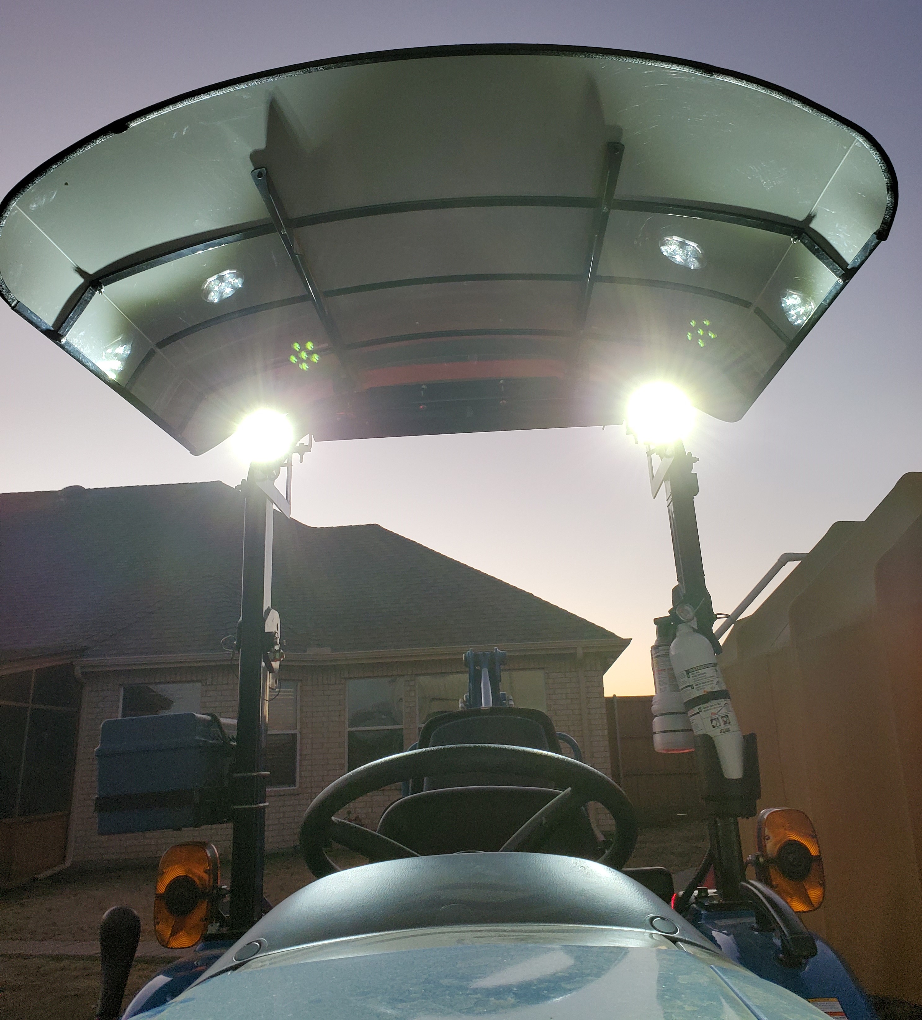

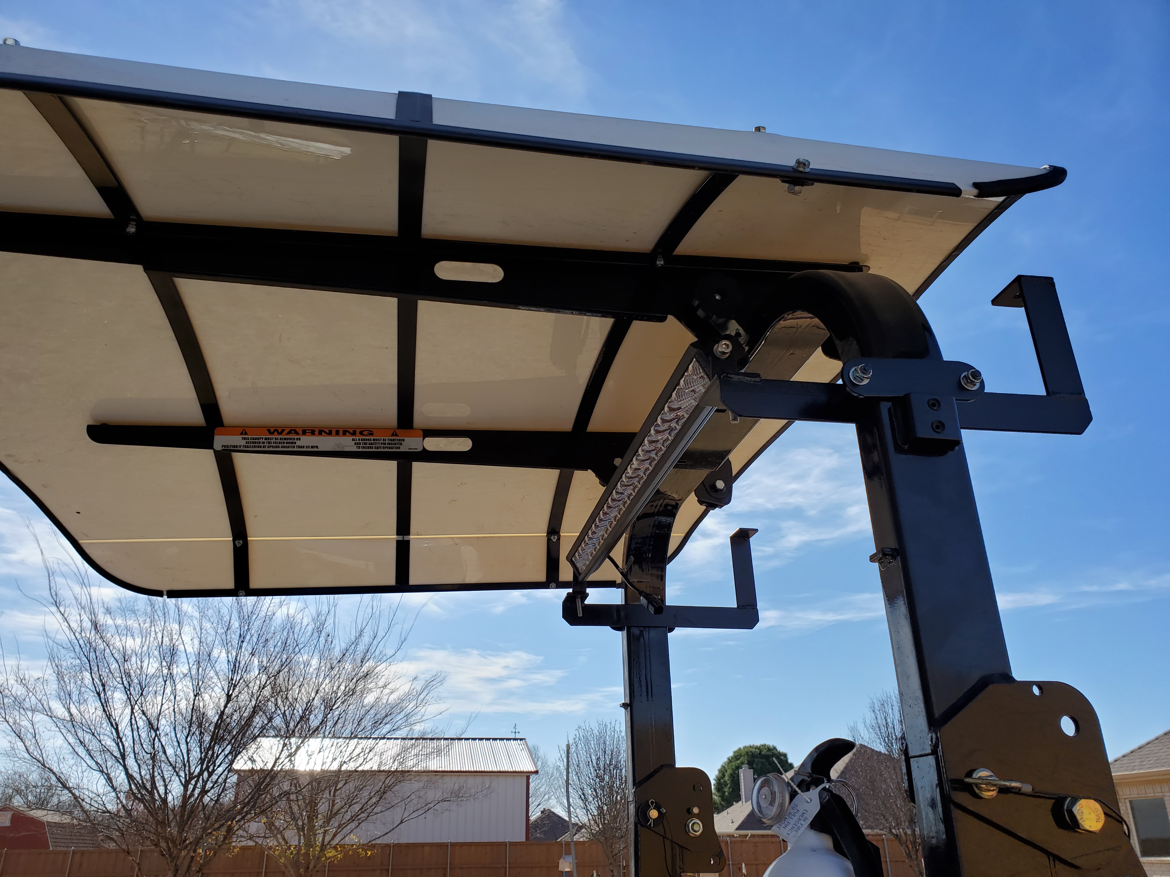

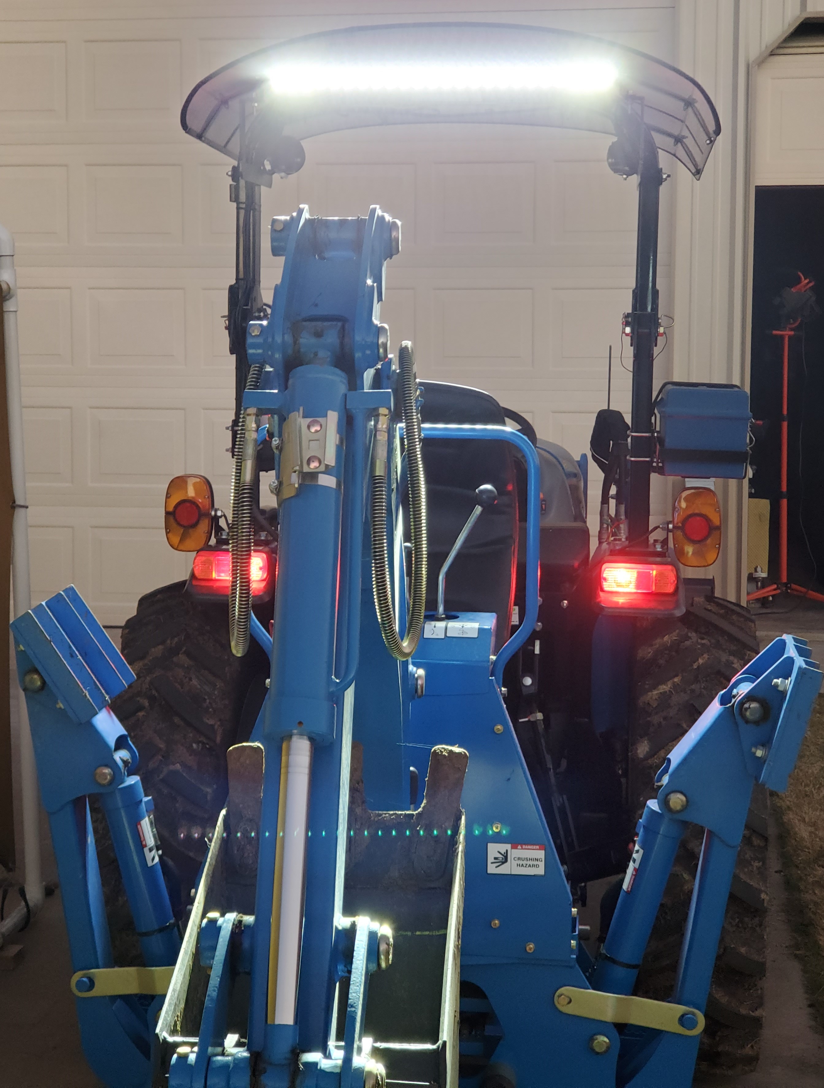

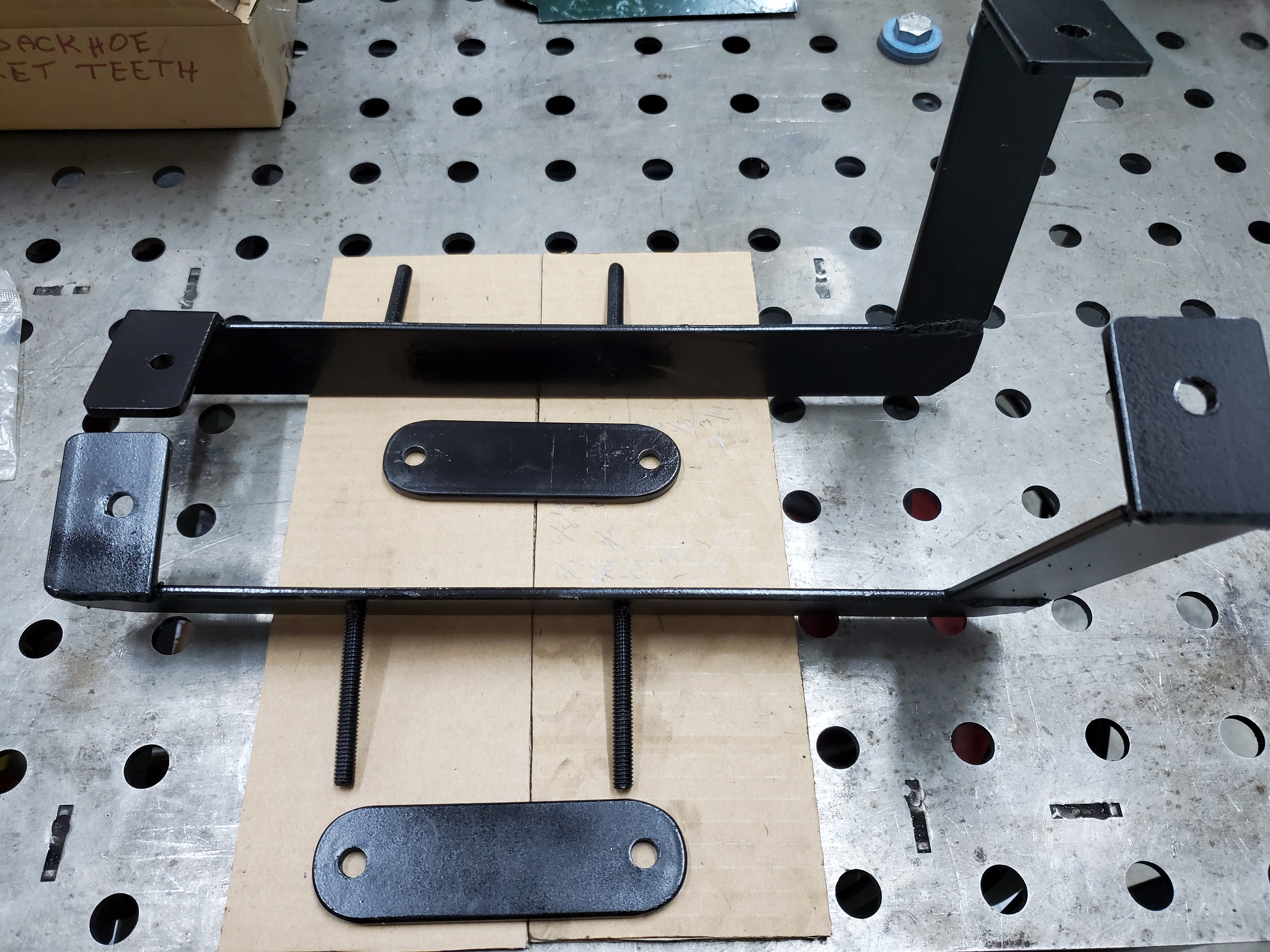

Finally finished making brackets and installed some LED lights. I made the brackets with the same spacing front and rear so the same light bar could be installed in front if I decide the 2 work lights aren't adequate.

Nice job on the lights.

Nice job on brackets! I do hope you don't have the flying bugs like we do because with the lights under the canopy I had on my mitsubishi I had to change it just spent too much time with face full of them! I also would suggest if planning to use backhoe at night mount lights on the backhoe use trailer plug between tractor and backhoe to disconnect! I find with lights behind me on backhoe that I can't see down in the hole because of shadows!
