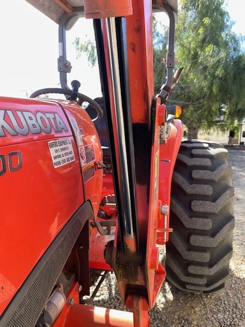

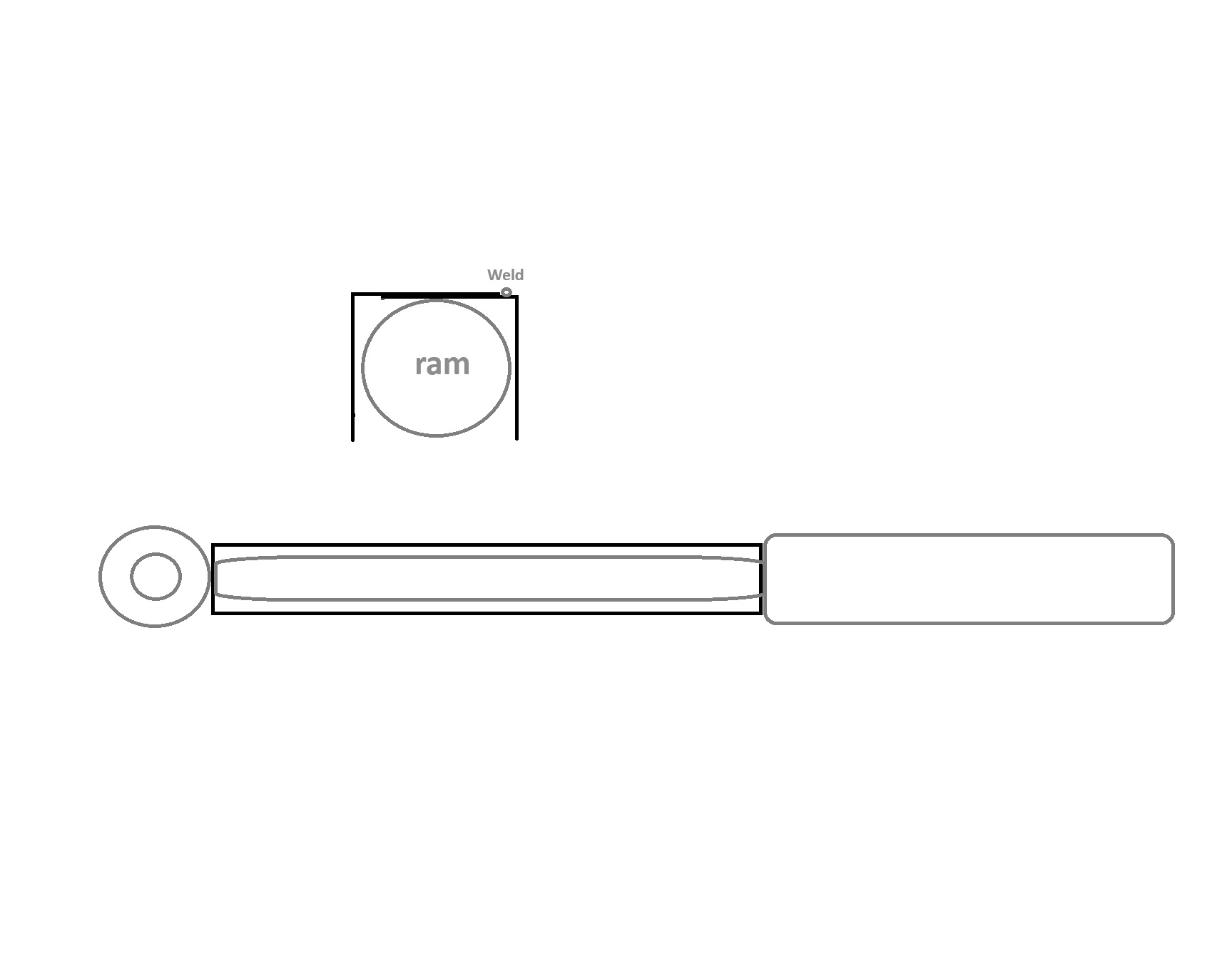

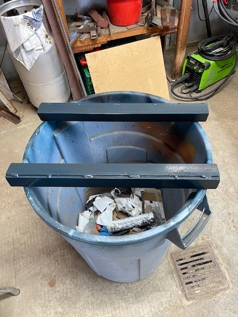

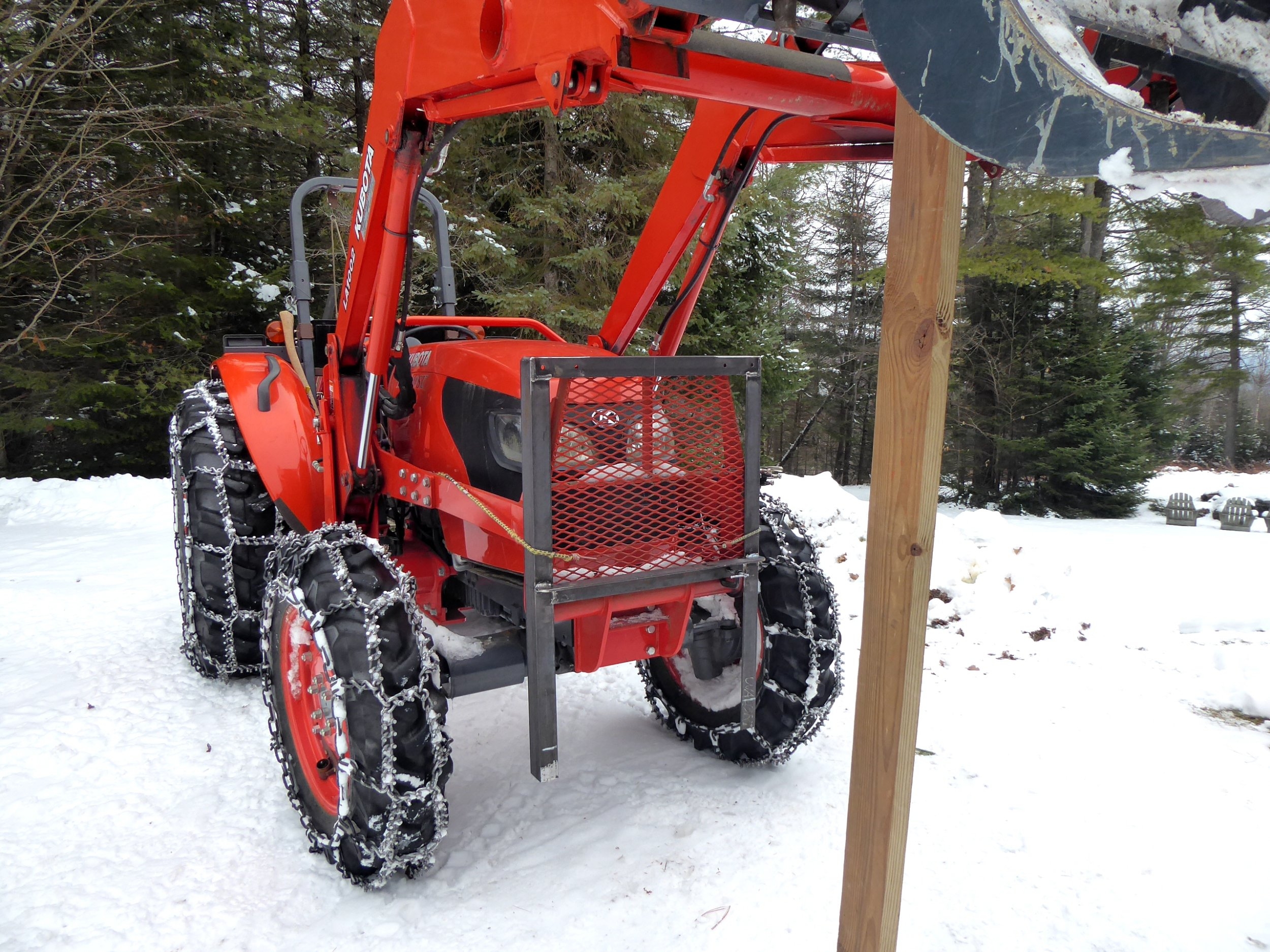

I made a pair of cylinder safety locks using scrap L metal. 2 pieces laid over each other making a U shaped lock. I prefer the bucket raised to clean the air filter etc.
These will make it safe.

With the FEL safely propped up I cleaned the air and fuel filter - Surprising amount of crap in the fuel filter bowl. Stainer doing it's job.

Much better than sticking a 2X6 under it. That would make a nice rainy day project for me. Thanks for the idea.

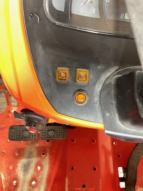

I added a proper parking brake warning light and flasher

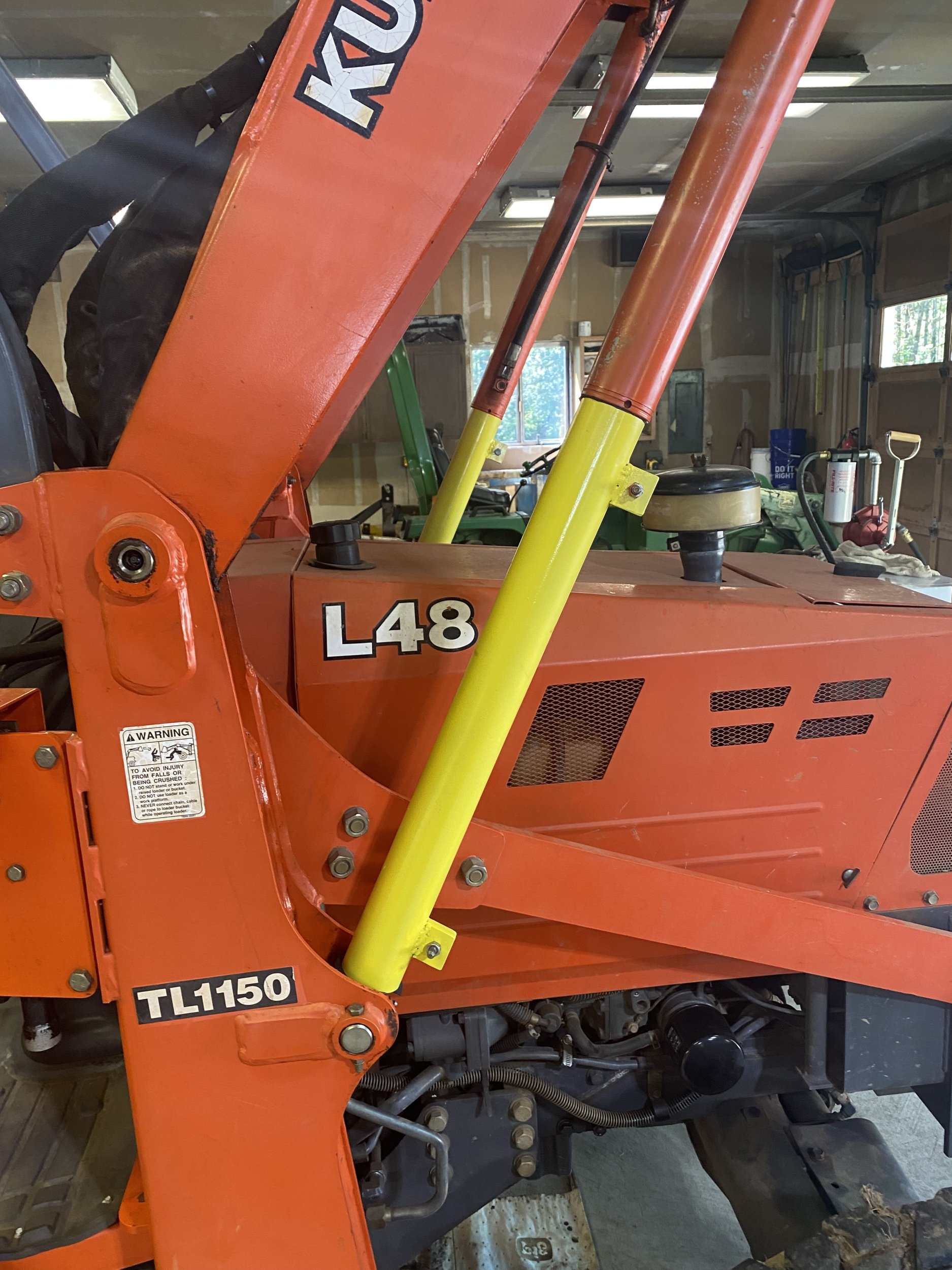

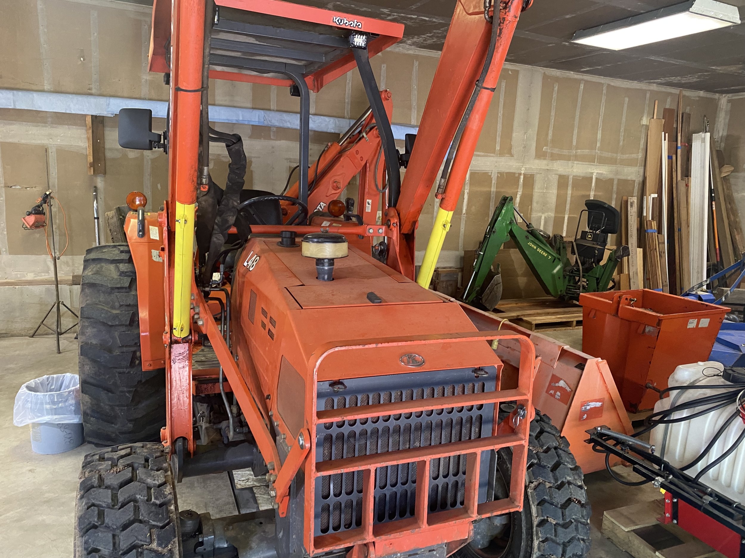

That looks like it was much easier to fabricate than my locks made of black iron pipe:
Splitting the pipe was kind of a pain in the butt. Turned out pretty good though. Definitely like the safety aspect.
Doug
   / What did you do for your tractor today?
#110
View attachment 840450View attachment 840452
Doug
Nice work Doug, and very safe looking. I decided on one mod for my open channel locks. I bought a couple of square lock pins. I will add a couple of tabs with holes for the pins so mine can 'fall' off.
