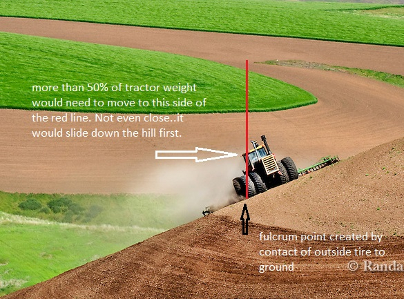

Remember, tractors are heavy and sit up high. They are used in off road conditions, where rough terrain is present. So understand that a high center of gravity is present and can turn things deadly very quickly.Its rare that rollovers happen the first year of usage. Normally its after3-5 years when you have a rollover because you have reached the point of being overconfident in your ability and in that machine. The people that work for my commercial mowing business never had an accidednt 1st or 2nd year. Now on my 4th year, and more accidents now than ever.This is because they have become familiar and confident with the machine, so they are willing to push it beyond the limits and over the boundaries. The more experienced you become, believe it or not, its more likely to have an accident than in your first years. The key to take away from this is to be familiar with a machine and be confident, but understand your boundaries and the limits of both the machine and the operator. Know your limits, and make sure not to exceed them in the realm of safety.
