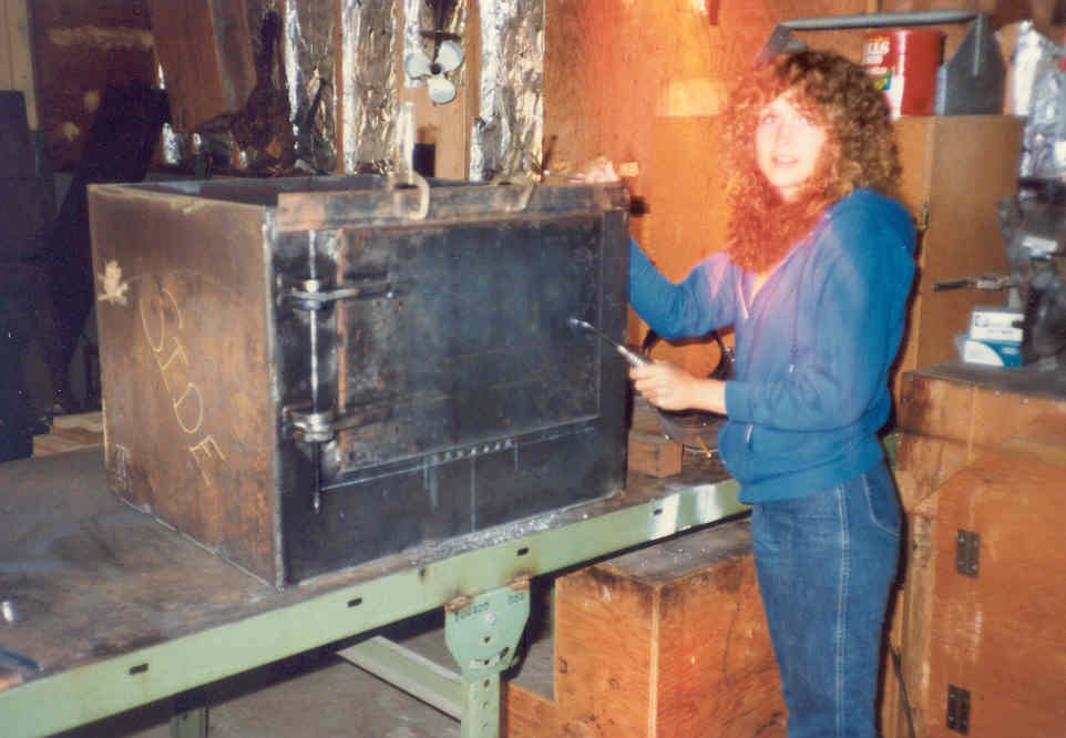

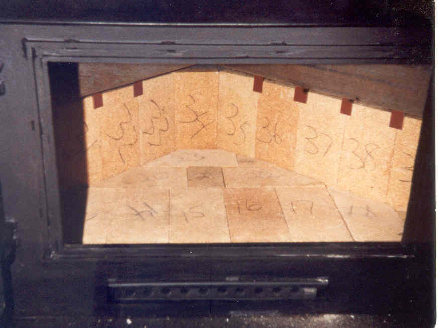

Not bashing original op ( Arrow ) on your operation of stove . As I Stated , My Parents have almost identical stove in their living room . Hottest he has ever had it was 700 , with usual hi temp only being in the low 600 range , with operating range from mid 400's to upper 500 range , depending on what they are doing , ( early morning start-up to mid day shut down ) . In your picture , there is obvious dis-coloration on that side meaning it has gotten very hot , thus my questioning of the ash pile . As I also stated , there is a reason that the fire brick is there and " Yes " your stove cracked above the fire brick , but with ash pile so deep basically your main heart of fire was burning above the brick line also .
Been around and used wood stoves all my life , Does not matter what brand , style or material it is made from , they all have limitations . Virtually all makers of Every product on the market have limitations to warranties , thus protecting themselves in some sort of fashion . I Don't Sell or have anything to do with Quadra fire , I do own this fire place : http://www.quadrafire.com/en/Products/7100-Wood-Fireplace.aspx# and my Parent's is similar to yours . We have had Ours for 5 year's ( maybe 4 ?? , old age , cannot remember ) , while my parents is like at least 10 year old , neither with issue's .
I really doubt you can find any stove maker that would back up a warranty once they looked at the stove .
That is consistent with my experience. My stove's manual says that peak operating efficiency is between 400 and 600 degrees surface temp. At 600 degrees surface temp, the burn tubes will be between 900-1000 degrees, which is right about where iron and steel start to glow, so I figure a surface temp over 600 degrees is overfiring. Now, like I said, there have been a time or two when the stove got away from me and got to a surface temp of as much as 850 degrees, and it doesn't seem to have done it any harm, but I suspect that such harm can be both cumulative as well as catastrophic, so I don't make a habit of it.

I emailed quadrafire when I got my 5700 and asked how hot you could get it. They said you could normally fire it to 650* or spike it to 700*. They said you can tell if you are over firing it if the fire brick are peeling.
/ What caused this #60
This over firing of a wood stove seems so strange to me. Never heard of the term until this thread. But then again I have never bought a wood stove. Built a few though, the ones for my self I've seen red hot, and no problems. :confused3:
