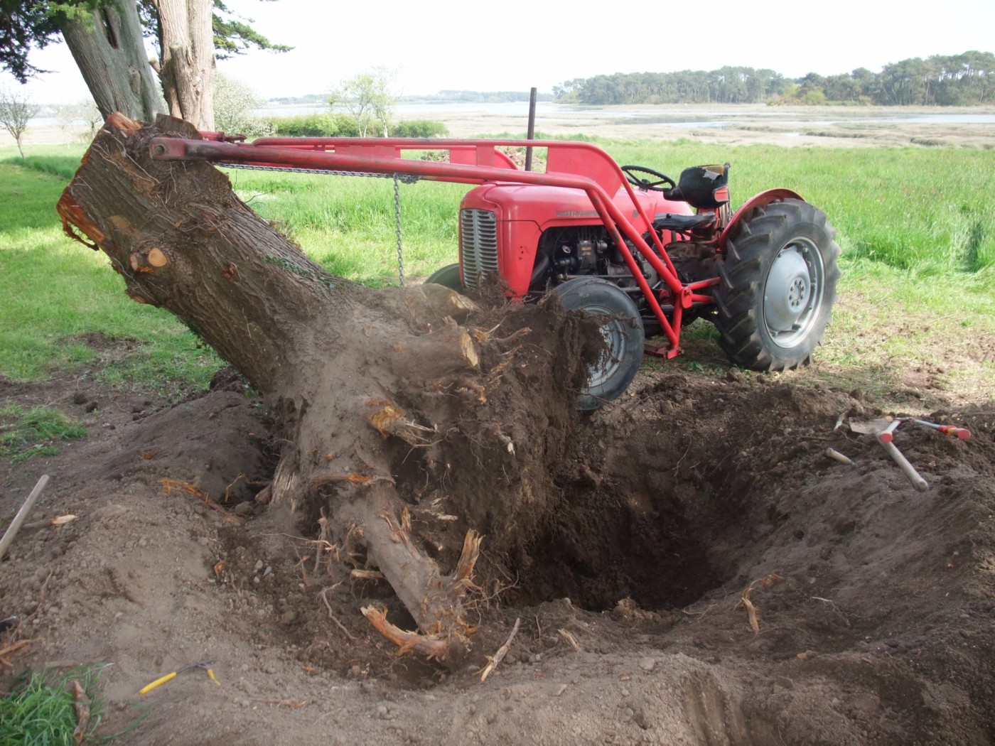

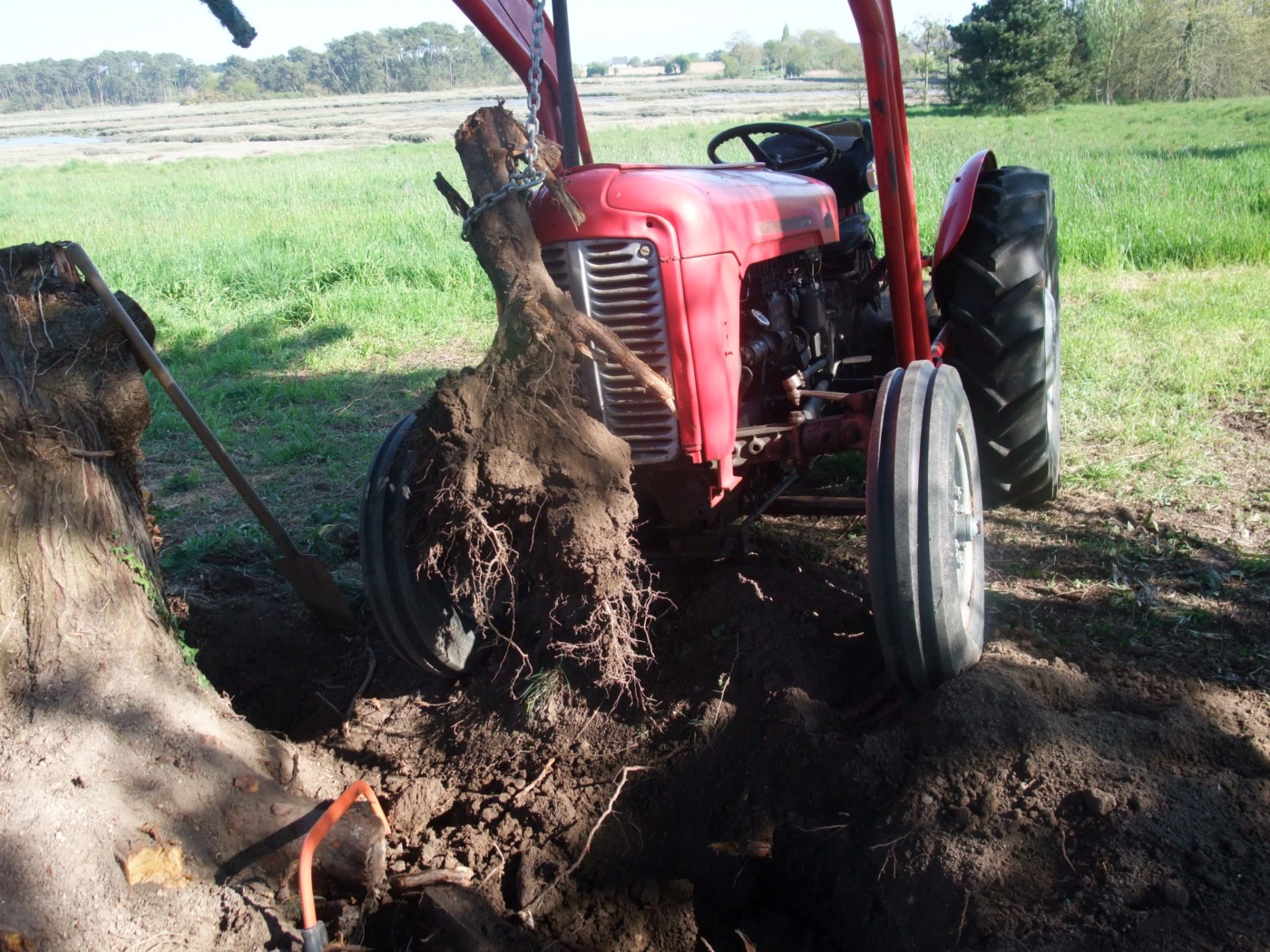

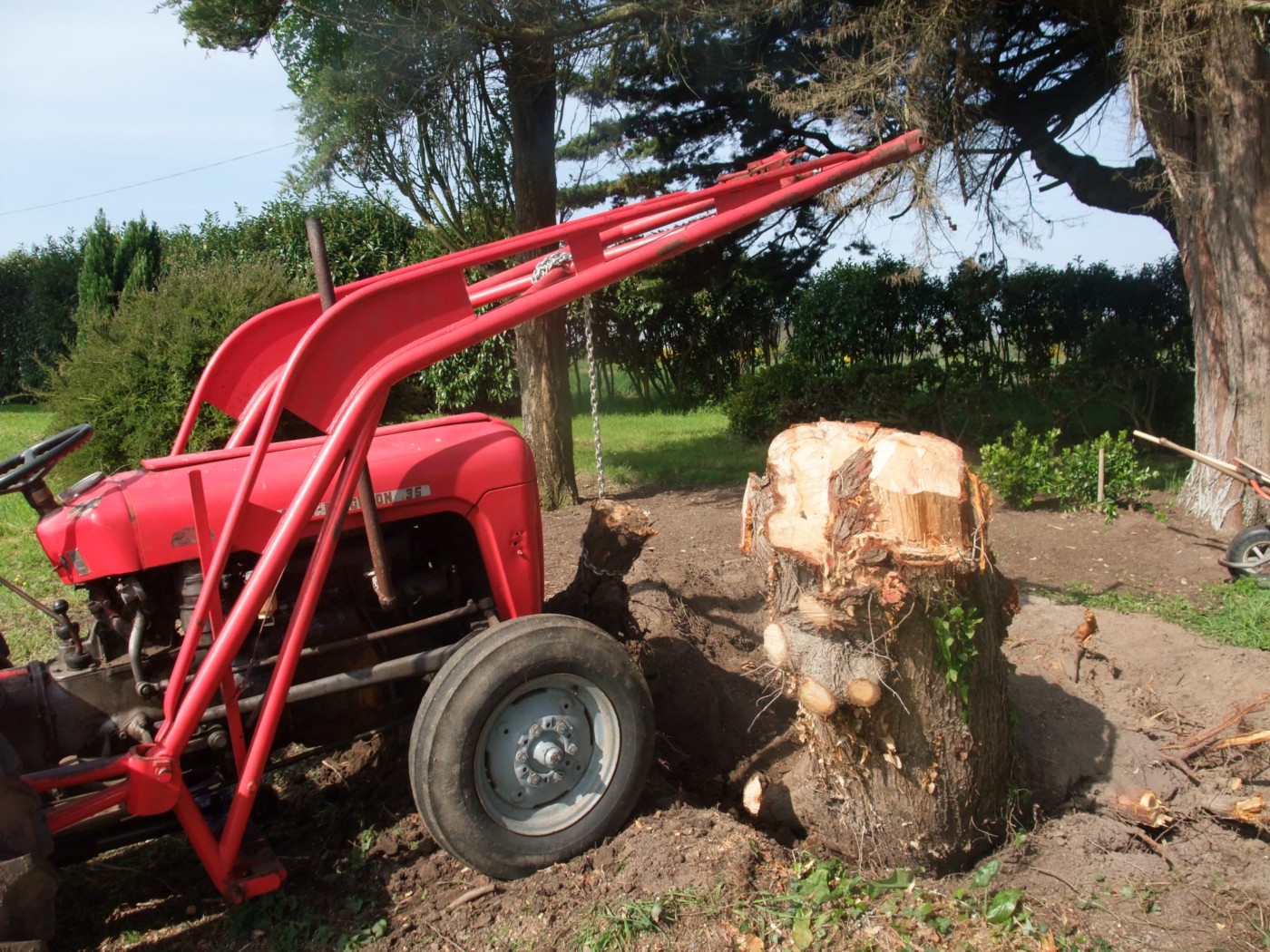

Also, as nice as the pictures soulasphil posted...note that he wasn't using his ROPS (folded down is just about the same as not having a ROPS). Also, no rear ballast.
No reflection on soulasphil, but that's an accident waiting to happen.

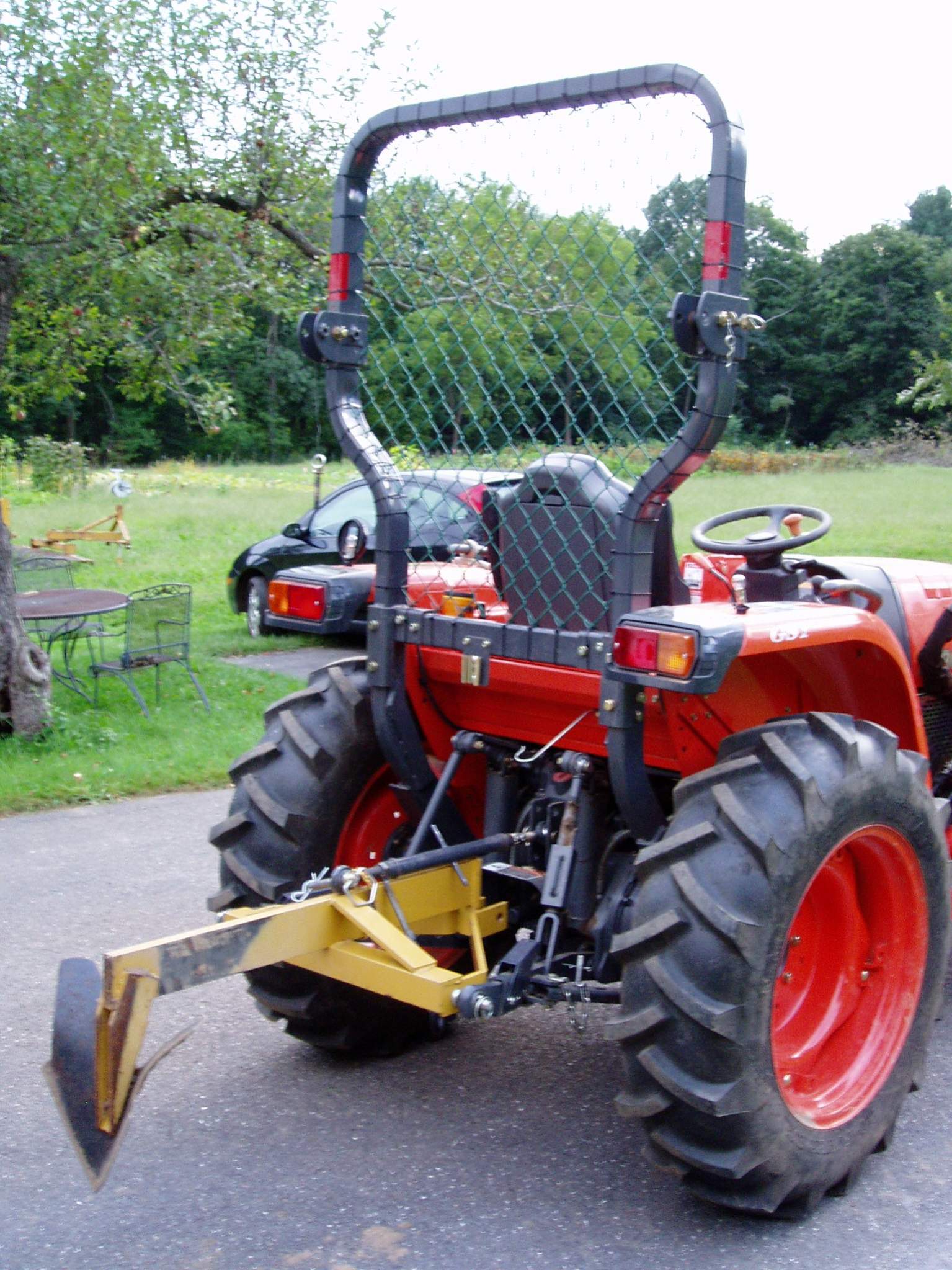

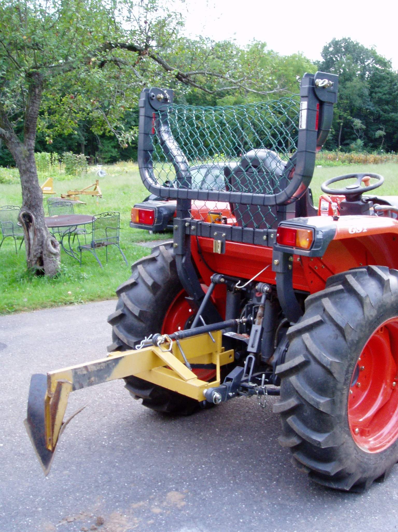

You asked about recoil protection - I use ropes a lot and they have a bad reputation for stretching & letting go - here's what I use:
-Jim

Thanks Jim...I like your ROPS add-on. Seems like that should help if either a rope or chain broke. I also think the ripper would be of great help...I think it might even rip the stumps right out.

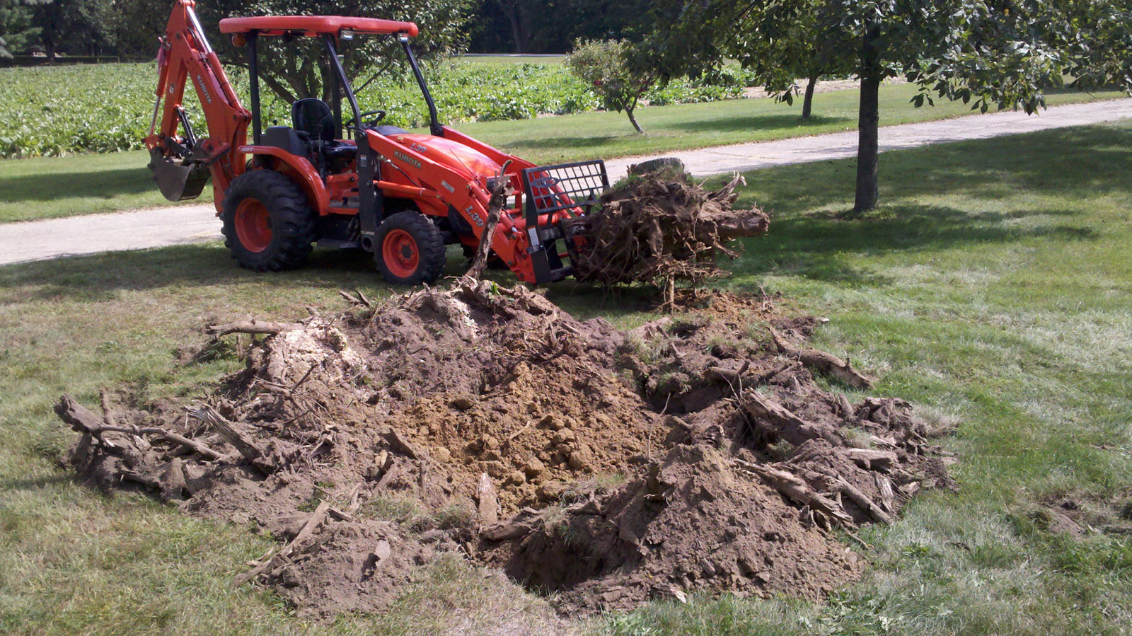

Here's 16 inch Ash stump that I dug out today. It has been dead a couple years - Emerald Ash borer. I had left a six foot stump on and I tried pulling it before digging and it would not budge. It didn't take long to break the roots with the backhoe and get it loose. I used the thumb on the backhoe to pick it up out of the hole after it was loose and set it on the ground so I could pick it up with the forks. It took a lot longer cleaning up the roots and leveling the hole afterwards.
With as may stumps as you have, if they are not rotted, I would rent an excavator for a day (get one with a thumb) to dig them and then haul them away with your tractor.

Thanks for the kind words regarding the screen - I think it would stop a stout rope, but I wouldn't count on it to stop a 5/16" chain - though it is better than nothing.
As long as you work slowly with the ripper I don't think there's a lot that can get damaged. I still need to make a shear bolt arrangement on mine - more for when I'm using it in the field & at a good clip than when I'm grubbing roots in granny gear. Being right at the hitch pins, it can exert some whopping force when pulling up with it - way more than my FEL can deliver - and I don't get tippy or go looking for ballast. One down side is if I use it to pull the stump out I usually cut the stump close to flush with the ground - otherwise it's always in the way of the subsoiler, one of my rear tires, our the soft orange underbelly of my 'bota.
