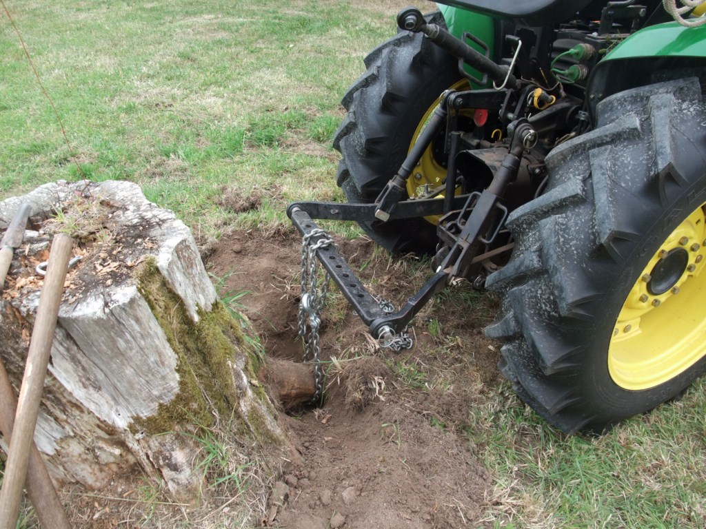

I suggest you pull them with a chain on the tractor's draw bar. That's about the strongest part of the tractor.
You can loosen the stump with the loader...just don't over do it. But when you pull it out, use the draw bar!

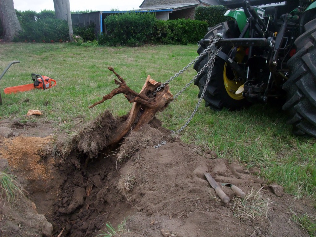

I use chain wrapped about a foot or so above the base, but some guys like the chain higher up which would increase leverage. One determining factor is the type of tree and how the root system spreads.
Once the stump is out, you can drag it to where you want it (using the chain and draw bar) or the loader bucket...which ever is easiest.
Just remember, your tractor is a compact utility machine...not a bulldozer.

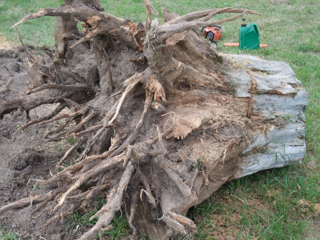

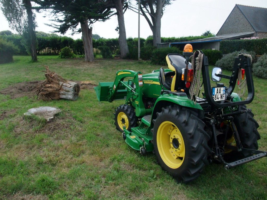

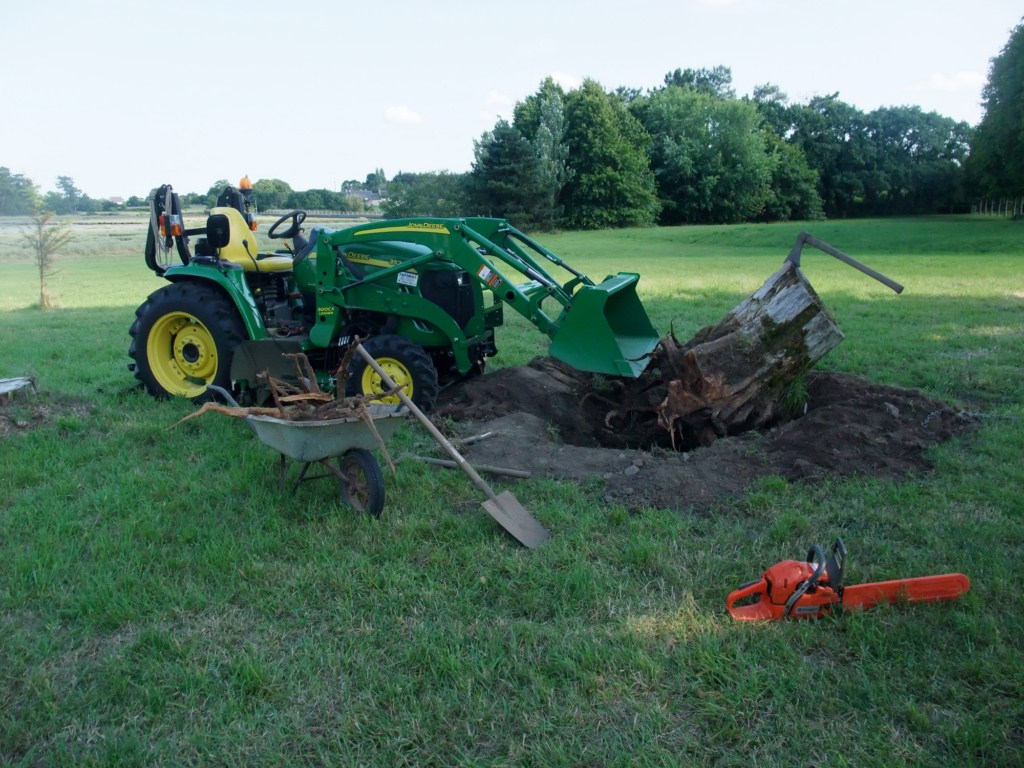

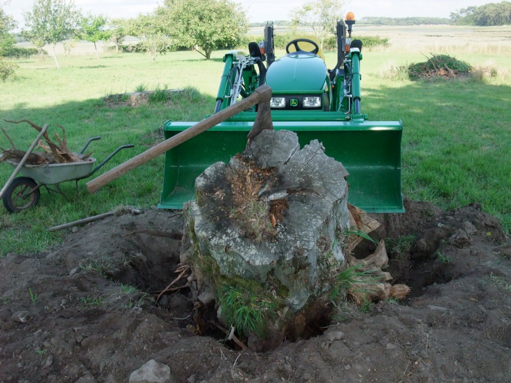

Well I hope it all comes out as easy as you make it sound. I never was that lucky.
I took out many stumps either with a Massey 35 or a JD 3520. Implied a lot of hard work and generally lasted several days. My wife says I never get dirtier than with stumps. The first stump was only a few months old, the second stump here was left by the 1999 hurricane, so about 12 years old, very very little rot and immensely strong. Both Lambert Cypress.

/ What Bends/Breaks First :) Stump pushing or pulling... #19
... a lot of hard work and generally lasted several days.
... very very little rot and immensely strong.
Or cut a basin in the stump top with your chain saw and plant flowers in it.
Bruce
