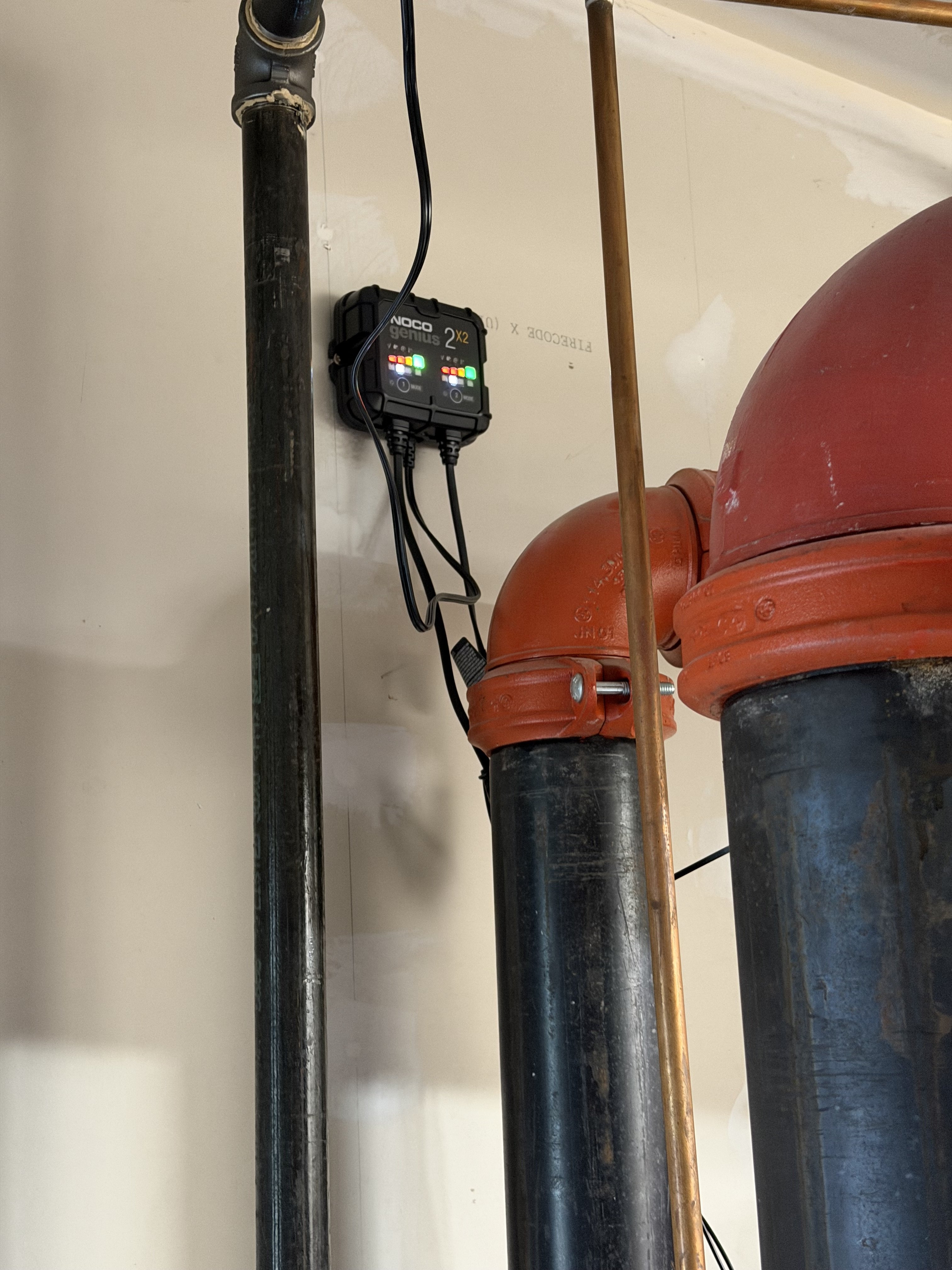

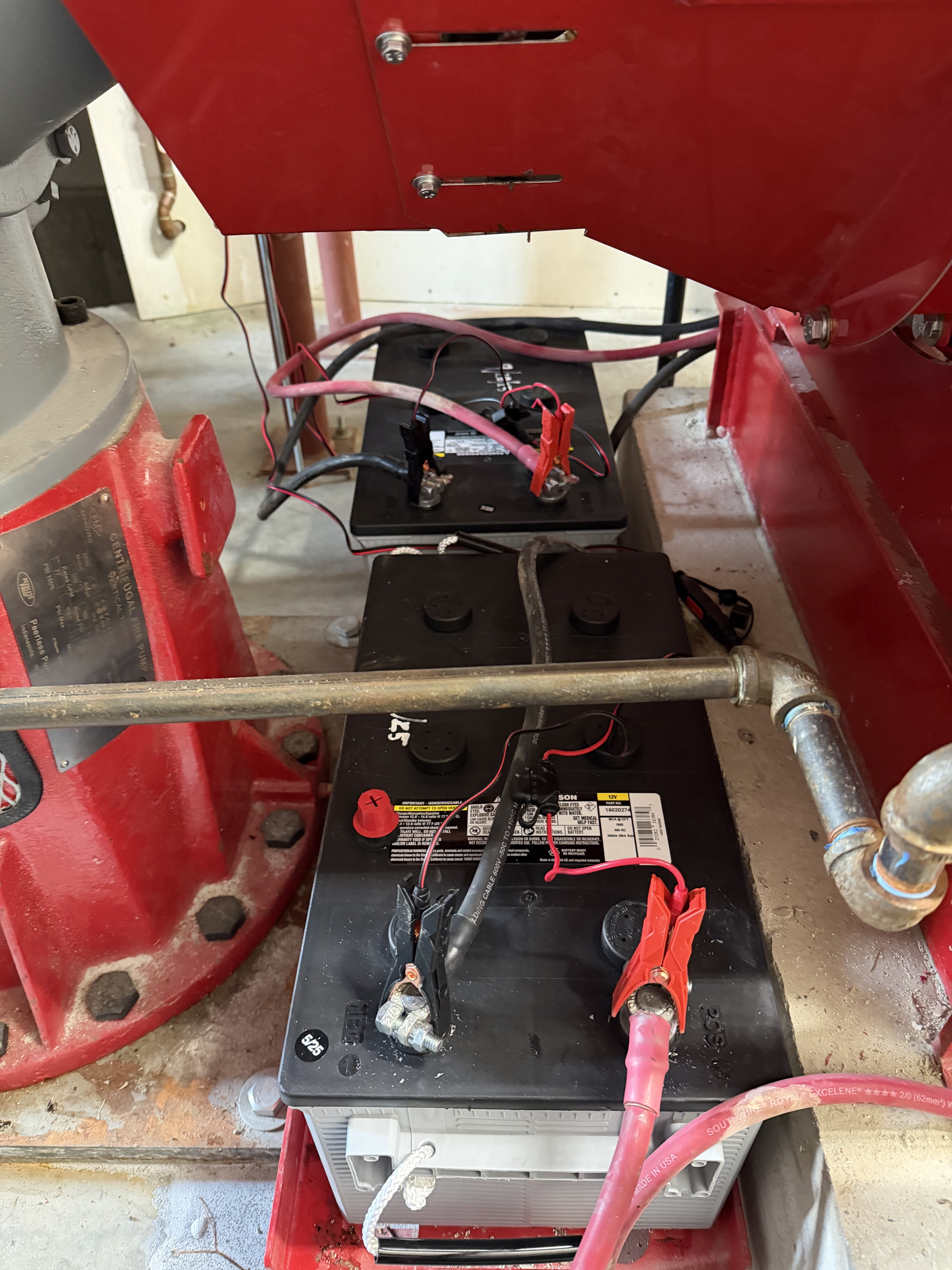

I have an AGM battery in my Hustler Raptor X lawn mower that needs charging. I've been told that a normal battery charger (Schumacher SC-600A) can't be used. What battery charger are you using for AGM batteries? Also, the battery in my Kioti DK4510 is getting weak, and I'm thinking of replacing it with an AGM battery. Any suggestions and/or issues
/ What battery charger do you use? #33
I have an AGM battery in my Hustler Raptor X lawn mower that needs charging. I've been told that a normal battery charger (Schumacher SC-600A) can't be used. What battery charger are you using for AGM batteries? Also, the battery in my Kioti DK4510 is getting weak, and I'm thinking of replacing it with an AGM battery. Any suggestions and/or issues?
NOCO Genius​
