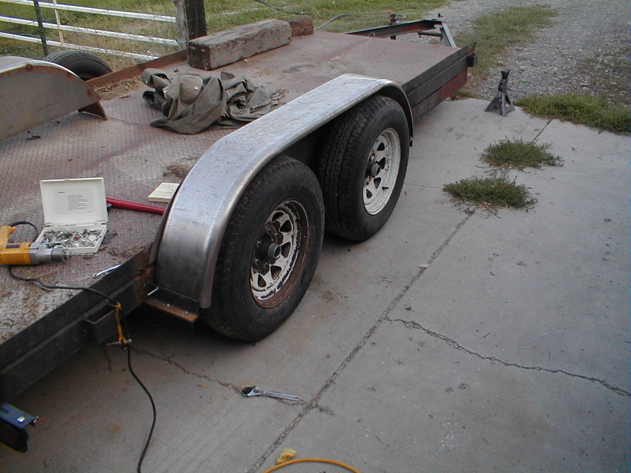

Pictures!!
From left to right below...
1) The newly painted jack (I covered over the label with tape when I painted the jack).
2) The light mounting bracket I fabbed and attached last night.
3) The LED grommet light attached to the light bracket (My lights are probably worth more than the rest of the trailer.)
4) The fender that I mounted tonight. Once I get the holes all drilled, etc. on both fenders, I'm going to take them back off for prep and paint.

/ What Axle Do I Have? #89
Those wheels look like 6 lug. I thought that was the main sign they were 5200 lb axles???
#90
I custom ordered the axles. I had 6 lug wheels, but I didn't need the heavier axles (my truck is a half ton) and I didn't want to pay the extra money for the heavier axles.
