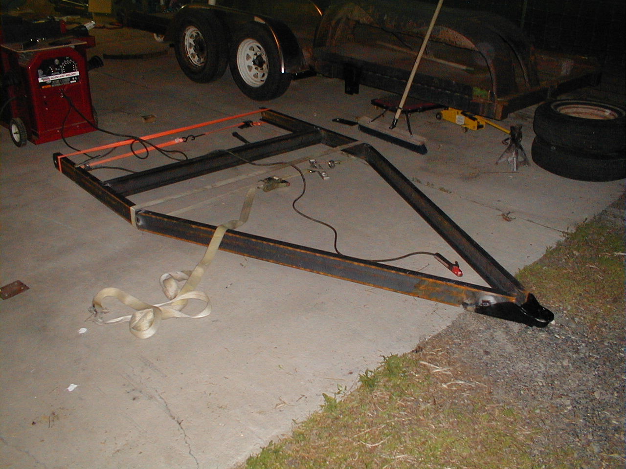

More progress.
This is the new tongue. It's just tack welded for now. I'm going to test fit it to the trailer, and then plate the seams and finish welding.
Sorry about the dark pictures. I was late last night.

I stole a little time today and worked on the trailer some more.
I got the reinforcing plates all welded on. I think I did some of my best welds I've done in my life on these fish plates. I know, that's a sad comment about all of the other welds I've done.
I used 7014 rod and turned the welder up as far as it will go. You can see the welder in the background of the last picture. I'm including three pictures. One of the overall tongue, a close up of the fish plates, and an extreme closeup to show my welds that I am so happy with.

Cool. Welds look nice. I'd call those gussets, not fish plates. But that's just me.

Gussets is probably the right word. My brother-in-law always calls them fish plates, and it just stuck in my head that way.

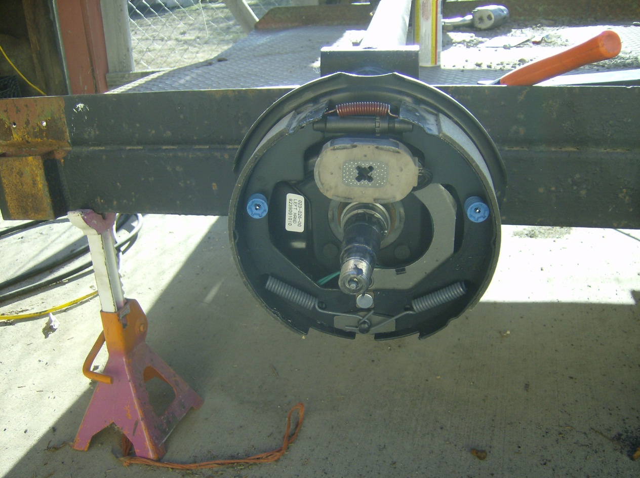

/ What Axle Do I Have? #75
Here's my trailer axle spindle (see picture). I'm ready to buy the stuff I need to add brakes, but I need to know what axle I have so I can order the parts.
The bolt pattern is 5 on 4.75 (based on the fact that from lug center to the center of the next lug is 2.8")
The seal is 1 7/8"
The inner bearing I.D. is 1 1/4"
The outer bearing I.D. is 3/4"
I'm pretty sure of these measurements as they were measured with a micrometer and the dial was right on for all of them.
I also measured the axle tube. It's 2 9/16". This one may be smaller due to the build up of rust and dirt.
Any help is appreciated.
Forgive me if this has all been answered somewhere else, but it looks like a West Coast plant built Dexter 3,500lb drop axle (they always used square tube while midwest and east coast units have round tube axles... and even Dexter could never answer me why that was) with PR4B springs, which are pretty well used up. Call Century wheel if you are out west. they'll have all the pieces to get you fixed up.
