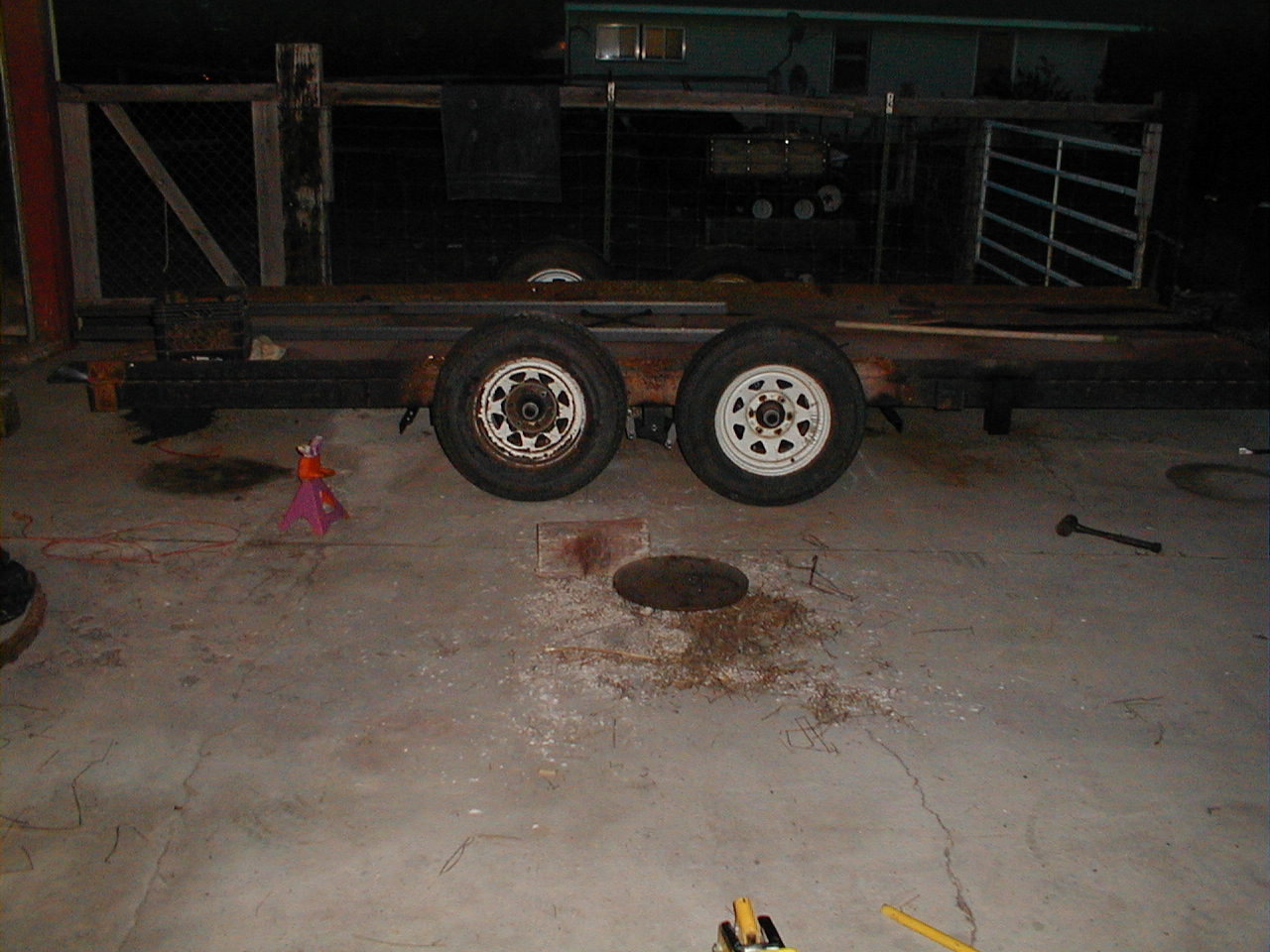

More progress. I'm still at that point where it's getting worse before it gets better.

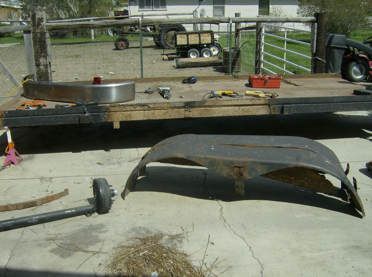

That trailer's looking pretty good from here. Needs some work still, sure, but unless I'm missing something the deck and frame look pretty solid.:thumbsup:
The part I'm having trouble figuring out is how your going to get those shiny new fenders sitting on the deck looking like the ones on the ground so everything matches.;)
/ What Axle Do I Have?
#43
I've thought about that. I don't think I'm ready to expand the scope of this project to include painting the rest of the trailer. I can do a crappy rattle can job on the fenders, though, so that they match the trailer. The next phase of this trailer project (maybe next year) is to build a different tongue so that I can use an equalizer hitch with it. Maybe after that I'll sandblast and paint the rest of the trailer.
While we're on the subject of fenders, anyone have some advice for how to mount the fenders so that they'll weather the occasional bale of hay being dropped on them, etc.? I'm guessing that there are better ways to mount fenders than to simply tack weld them to the frame like the old ones.
/ What Axle Do I Have? #44
I've got two good trailers at the farm with removable fenders. I'll try to remember to take a look at how they're mounted. No promises though..... My memory doesn't seem to be what it used to be anymore.:ashamed:
/ What Axle Do I Have? #45
Do not weld the fenders on, bolt them on. That way they are easily changed or removed for the wide loads.

Do you have any pictures of that? I'll need a backer for my fenders. I'm assuming that I'd weld the backer to the fender and bolt the backer to the trailer.
/ What Axle Do I Have? #47
What about putting a thicker piece (like 1/8" plate) inside the fender for rigidity and bolting through both for mounting to the trailer?
/ What Axle Do I Have? #48
I do not have any. Pretty strait forward though. Just weld on angle with a backer nut welded on. The when you put the fenders on you drop in the bolt and tighten it down. Good to use Stainless Steel bolts for this application with some anti-seize.

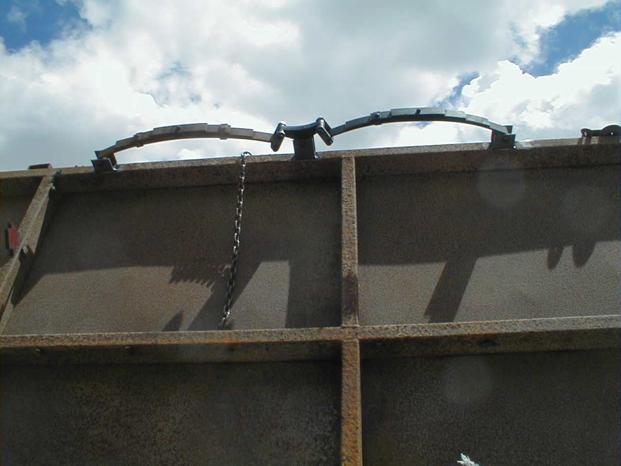

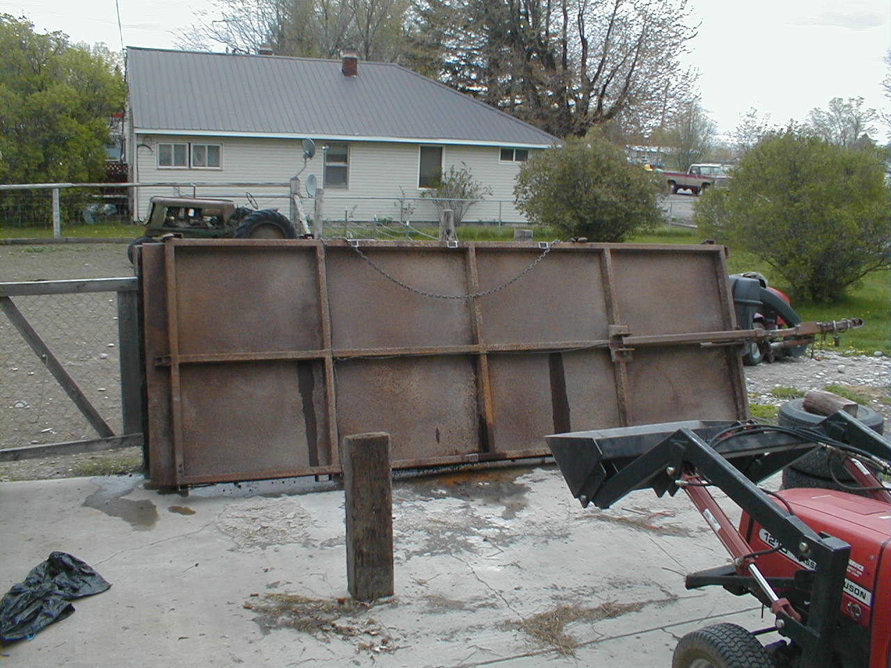

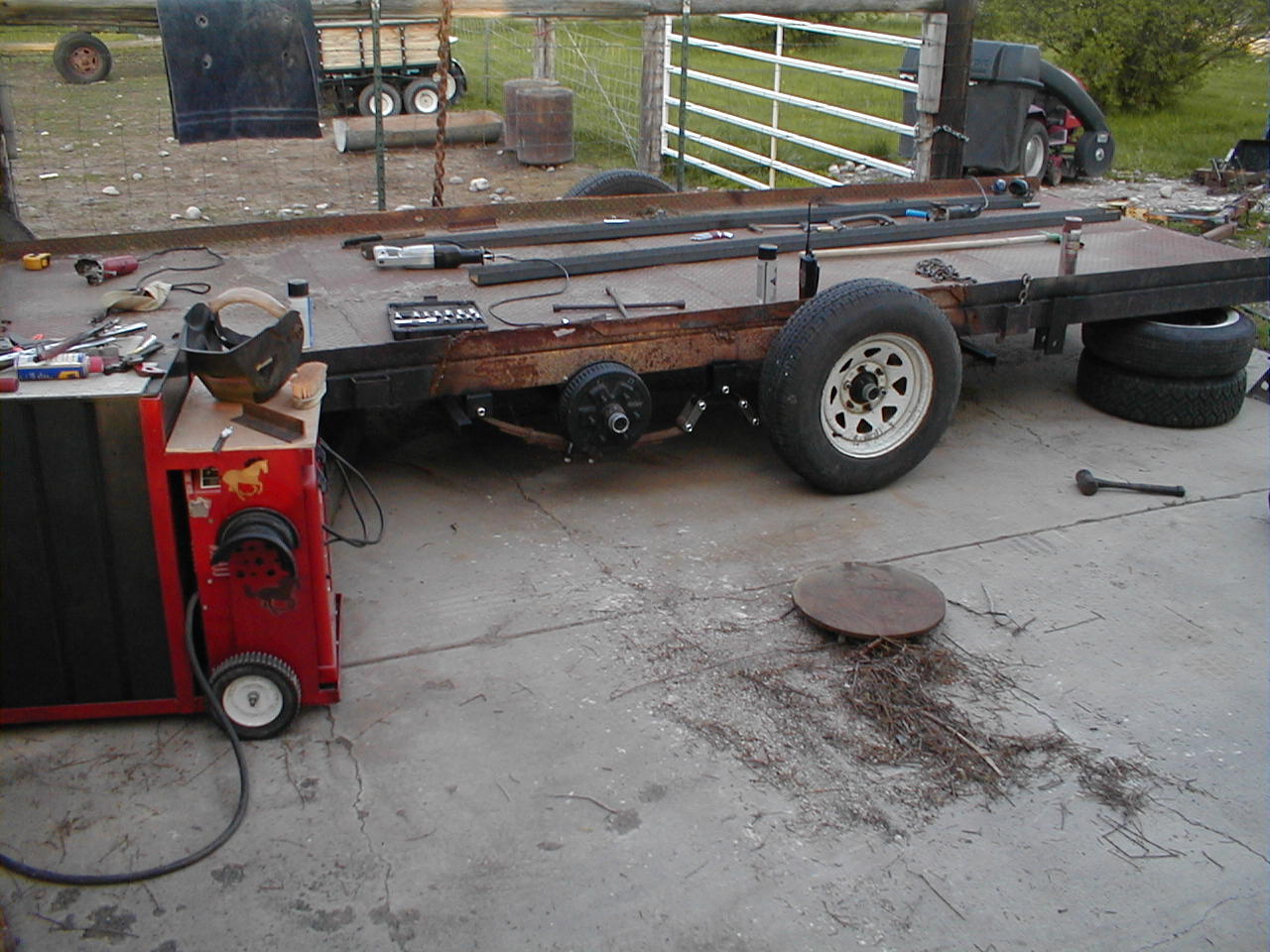

I stopped at the trailer place again to get fender backer plates, and I talked with the guy there about the axle placement. He convinced me to leave the axles where they are before I got Chris's reply. His logic makes sense... The tilt geometry is tricky, and if it was working before then don't change it. I also bought steel to make a new tongue.
Here are a few pictures of today's work. I tipped the trailer on it's side to do the work. The second picture is about halfway through the day. Now I have the springs all hung, One set of fender mounts welded on, the fender backers tacked to the fenders, and the mounts for the new tongue installed.

I've been rained out all week until today. I envy those of you with nice shops to work in.
I have now accomplished what I originally set out to do at the beginning of this thread. I have added brakes to this trailer. Now I just have to put back together all the stuff I disassembled while I was at it... fenders, tongue, lights, etc.
Here are some notes of what I learned tonight.
Leave the U-bolts loose when hanging the springs. I originally tightened them up and I couldn't get the springs and hangers to line up. With the U-bolts loosened, everything went together fine.
The shackles that go from the springs to the equalizer need to be in the right orientation (up) when the axles are first hung. I let them hang down thinking they'd right themselves when weight was put on the tires, but that was not the case. The front ones popped into place, but I had to remove the rear ones and re-install them with them up.
My tilt angle is 10 degrees. My deck is 16 inches off the ground. That means the bottom of the trailer frame is 12 inches off the ground. That will be nice for loading and unloading, but I think I may have issues with clearance. I can get about another inch of clearance by using shorter shackles. I'm debating.
