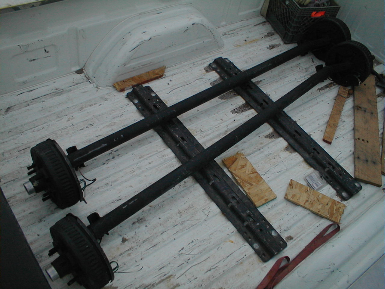

This plan has gone from simply adding brakes on one axle to re-doing both axles, rims, and tires. I picked up my new axles today. These are new 3500 pound Dexter axles. I took my friend up on his offer to buy them for me from his wholesaler. He also traded me a set of rims for a couple of hydraulic rams. I have the order in to my used tire dealer friend to get me a nicer set of used tires. My total cash outlay for this project is going to be under $350.
Now I need to find time to mount the axles. I'm not sure how involved that is going to be. The new axles have a slightly different spring mounting setup than the old axles.

You did good by getting rid of them old head aches you had and getting into some new axles that parts are available for. You will be $$$$$ well spent.

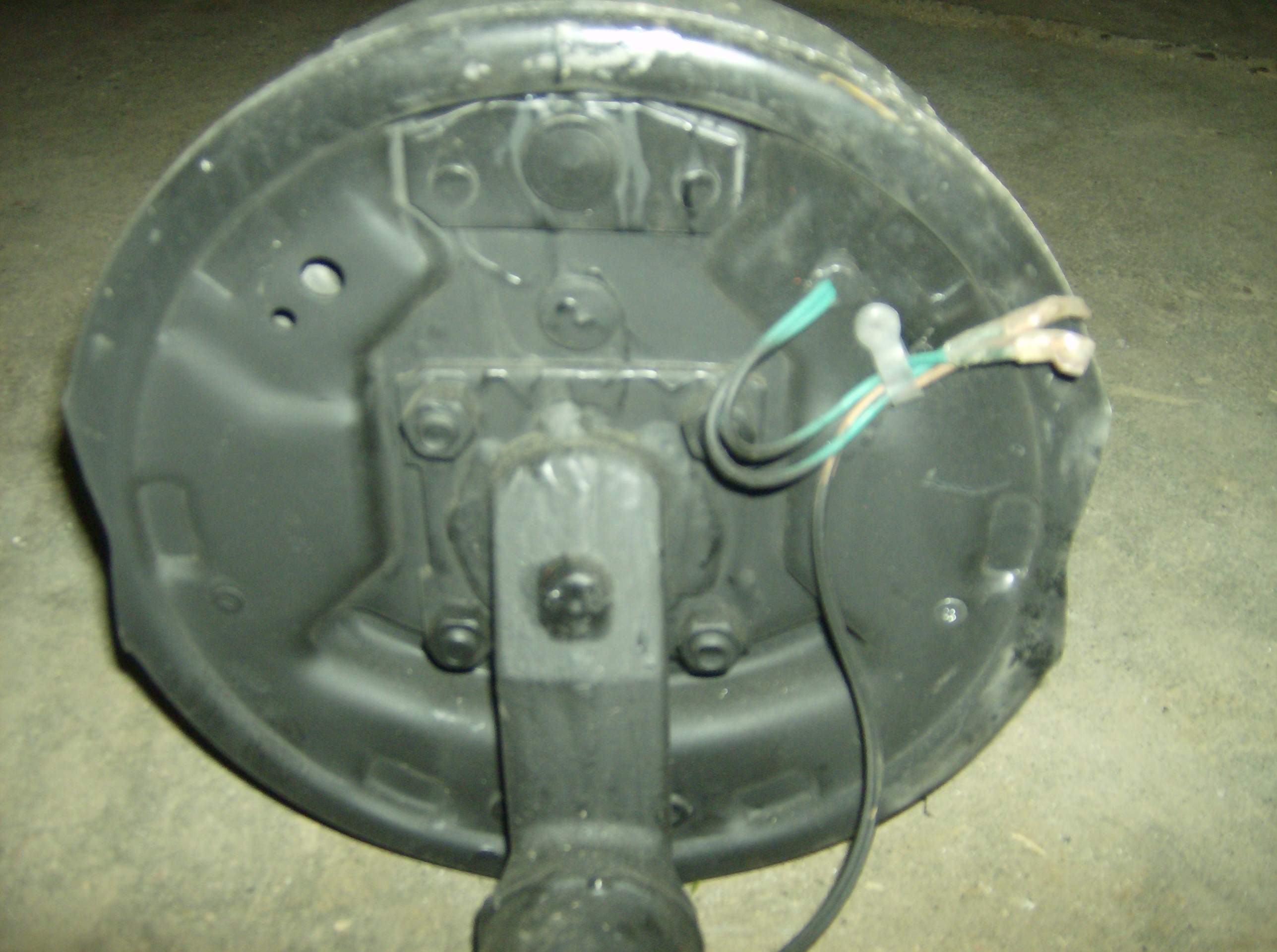

I've checked those backing plates all over. They are different, but neither is marked left or right. One side has printing on it and all of the wires are pigtailed to that side. The other side is plain (no printing) and the wires run from the brakes into the axle tube to the other side.
Any guesses which side is which?
The pictures aren't as good as I had hoped. The printing is on the axle in the picture on the left. on the left hand side of the backing plate at the level of the spindle is the dexter logo and some numbers.

If not marked you will have to study the brakes and imagine the magnet sticking to the inside of the drum and seeing which way the magnet goes when the wheel is turning forward.
Study the pictures at this website for reference. Trailer Brakes | etrailer.com

The backing plates will be marked somewhere. I called my supplier and he said many are now marked on the inside with a sticker. This means you will have to remove the brake drum to view. This seems to be confirmed by the link posted above. There appears to be a sticker on each backing plate.
Perhaps the numbers that I can not see but you say they are there are the part numbers. You could look them up on Dexter's web site.

Sounds like no matter what I'm taking the drums off. Even if it's not marked, I think I can tell pretty quickly by the way the actuator arm curves.

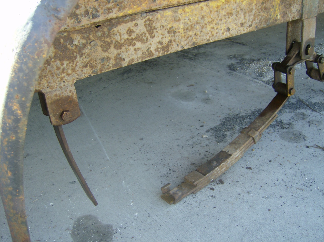

The scope of this project just got a lot larger...
/ What Axle Do I Have?
#37
Ouch. I don't think it's suppose to do that.:(
Nope.
Replacing axles has now become replacing everything from the frame down. I'm actually keeping two of the springs, but I'm cutting off the shackles and replacing them since the holes are wallowed out a bit. New mounting bolts, rockers, brackets and everything.

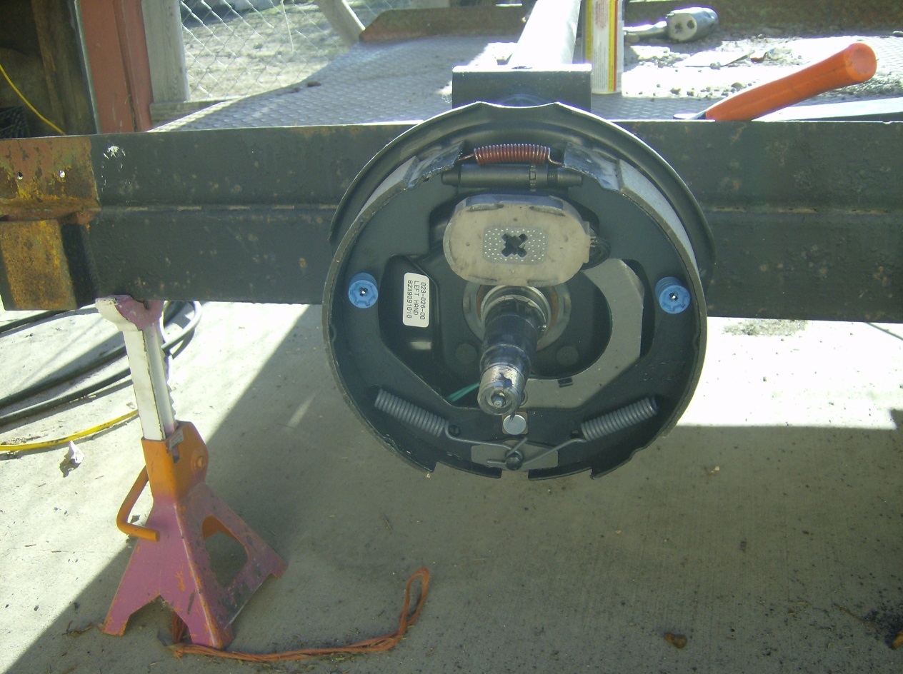

On a previous note, I discovered which side of the axle is which. When I pulled the hub, there was a sticker inside on the backing plate indicating that I had uncovered the left side.
Rant: Why would you put the sticker on the INSIDE of the hub?? What good is that going to do me. When you pull the hub you can tell which side is which just by the shape of the arm the magnet mounts on. If anyone from Dexter is reading: Put the sticker on the outside where it's useful. End Rant.
It just so happens that the left side on this axle is the side with the wire pigtails. I don't know if all axles are made that way, but it's a place to start.
